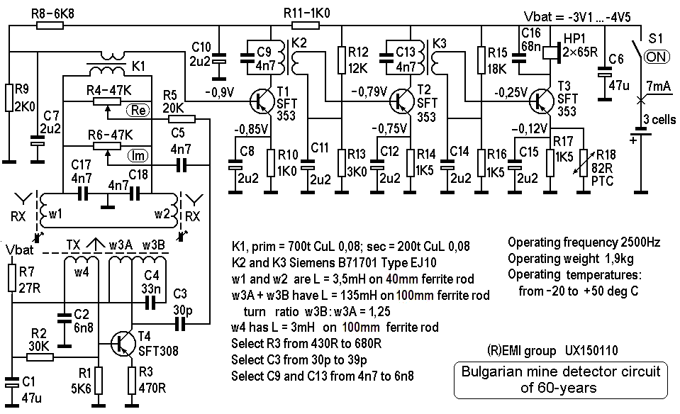

                    BG mine locator
                    This is the genuine circuit diagram of "Miniature transistor metal detector" (see the PDF file in posting #7 by Qiaozhi or posting #42 by Technos).
                    Mike BG
                    • #85
                      Mike BG

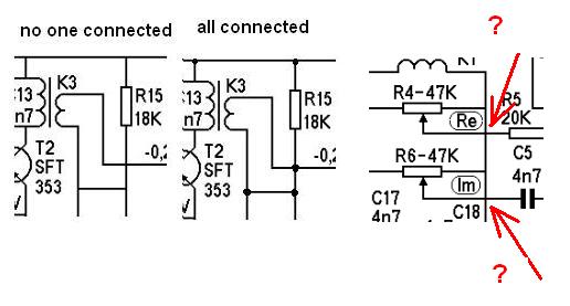

                      Nice mikebg, but are there known to REMI group where single line in schematic is crossing and wehere it is connected?
                      • #86
                        WM6, where is the single line? All lines are connected.
                        • #87
                          Sorry, now I understand the question. This is the method for circuit drawing without to use pont in wire conection.
                          • #88
                            If so then must be some shortings in schematic.
                            like this:
                            • #89

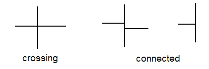

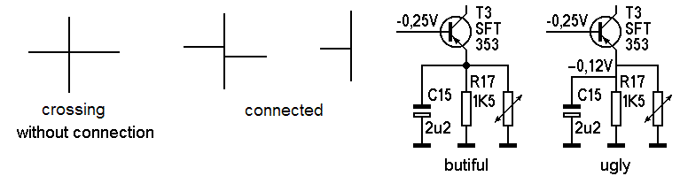

                              The method without points is ugly, but it avoid errors at printing and scaling.
                              • #90
                                Actually, the left-hand drawing is also ugly. You should never use 4-way crossovers in schematics, and you should always use tie-dots in order to avoid confusion.
