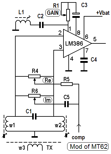

      Thе above circuit diagram with discrete transistors is too old to be copied. In modern circuits to avoid the use of inductive elements. For example K1 transformer serves to symmetry (avoids coils shielding) and impedance matching. It is not needed when using integrated circuit with a symmetrical input. Here's how the circuitry would look like in 70-years, when appears appropriate integrated amplifiers for audio frequency:

        Agree mikebg, I do not like to see in schematic a lot of trafos.
        But what do you mean, is it worth to upgrade this old schematic in some modern way without so much inductive coupling?

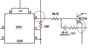

          I translate the schematic to Paint program and use the draft tool (4 sizes for different size of drawings). So you notice that lines cross here:

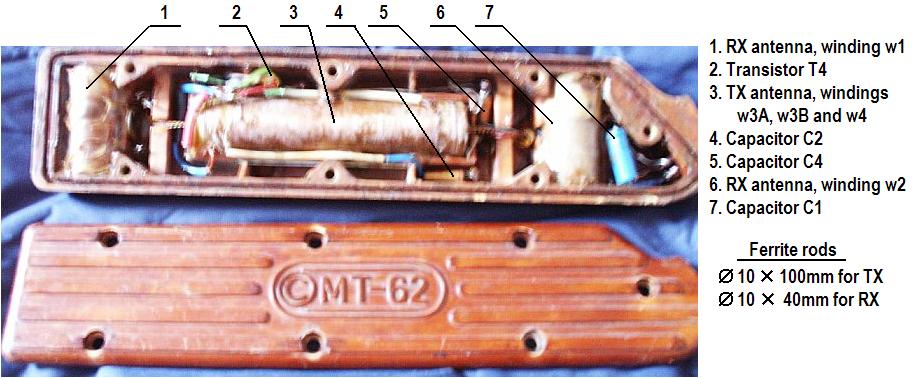

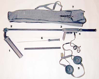

            The sensing head for mine detector MT-62
            This is the sensing head for circuit diagram in posting #84:

                The number means the year. There are 3 models in 60-ties: MT-60, MT-62 and MT-66. Above circuit diagram is of model MT-66.

                            • Modification of HOUNDOG?
                              Is my idea of modernization of MT-66, shown in posting # 92 could be part of HOUNDOG modification?
                              REMI group was disappointed with me because I have no sense of reinventor.
                              I was very close to reinvent of HOUNDOG, publishing idea for its modification in posting # 92. I never thought to connect TX coil in above circuit diagram to output of LM386.
                              For me, sensors of MT-60, 62 and 66 are like the configuration shown in postings # 1 and # 8. Really RX coil of HOUNDOG has center tap and it can be split as TWIN LOOP.
                              My idea was to build for MT-66 a narrow band amplifier with LM386 working at 2500Hz. For that purpose I use a tank circuit L1-C2 having high Q-factor. However the modified HOUNDOG should work in a broad band at higher central frequency, for example 8KHz.
                              How should seems a modernized HOUNDOG?
