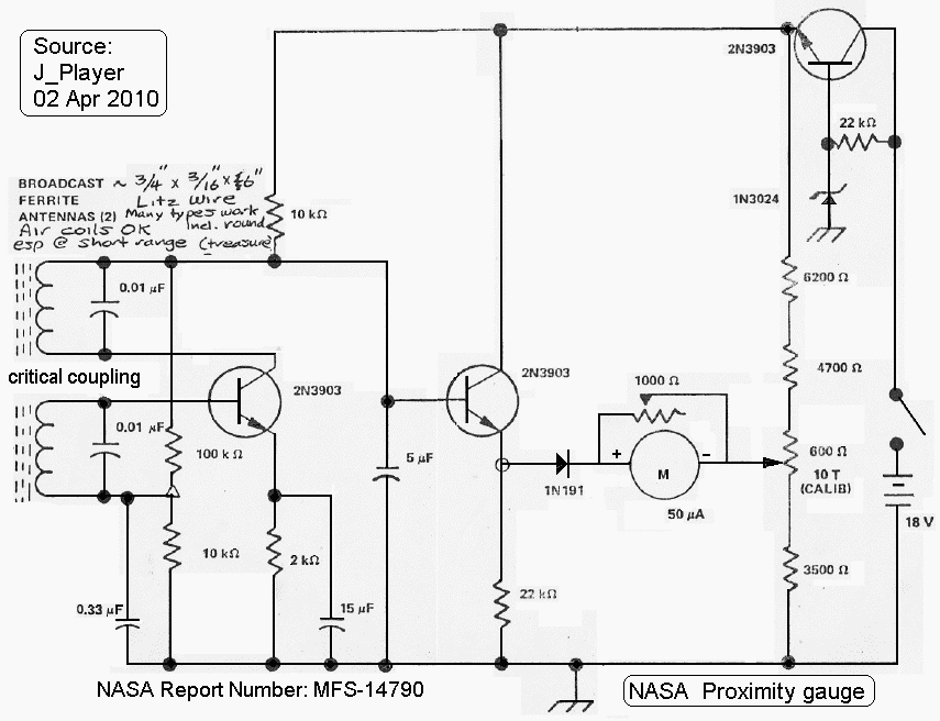

    • Pinpointer of NASA with BLACK HOLE ANTENNA.
      Pinpointer with BLACK HOLE ANTENNA.
      The block diagram of this design should be specific case of block diagrams in postings ##116, 60 and 16.
        Yes, should be, as Gold Gun too. Thanks.
          The Gold Gun doesn't have a built-in transmitter. It is totally passive.
            Yes, the Gold Guns AL707 and AL718 are passive metal detectors. For operation they need large signal from VLF station in searched region. They are primitive variants of genuine passive detector invented by Vaino Ronka and described in patent US3,500,175. Ronka uses second ferrite antenna for receiving reference signal and measures amplitude and phase of target signal.
            Search WEB for Geonics EM16. The company produces sparate TX for using EM16 in regions where no VLF stations.
