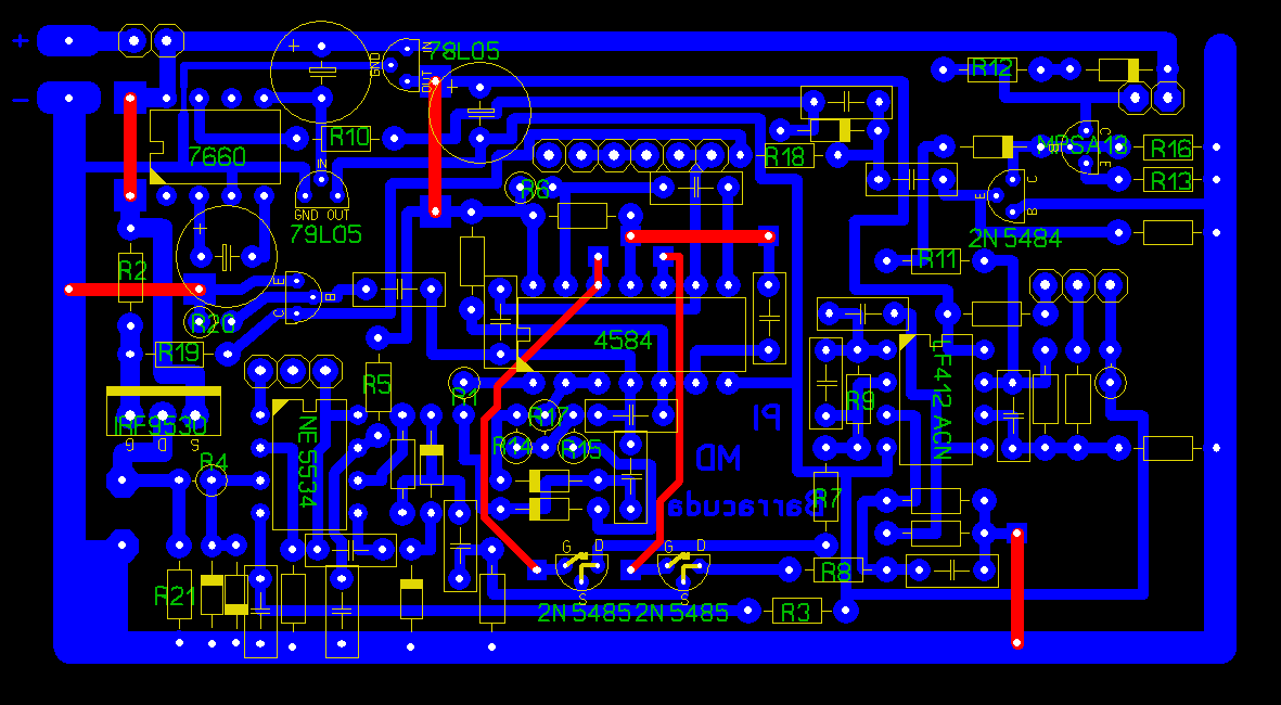

              Hi. At this PCB there is a problem. Is absent the above side. Here is the right.
              Geo

                    There is resistor missing on PCB -> 1M between pin2 and pin6 of NE5534..

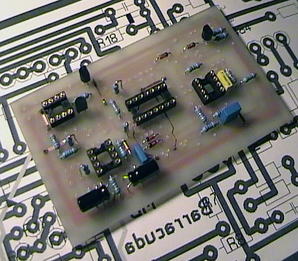

                    Nelson I'm just about to finish this project, few transistors and caps is all I'm missing.

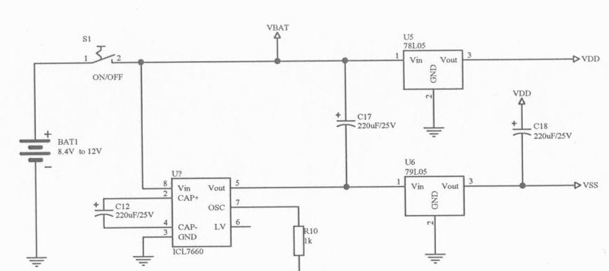

                          I completed the board and it's not working :confused: , so help is needed.
                          Can someone check the power supply:
                          Something is wrong with Vss - can not make this negative.
                          I wired +c18 to Vbat, but this not help either...

                            Hi Leto. Try to connect the pin7 of U1(CD40106) to -Bat no to Vss . To work properly the ICL7660 we must have oscilations from U1. So connect pin7 to gnd to make the gates to oscilate . Good luck .
                              79L05 Pin numbers
                              Leto, did you verify the pin connections on your 79L05 rather than going by the schematic? The datasheet I have shows Pin 1 - GRD; Pin 2 - IN; Pin 3 -OUT. The schematic shows incorrect pin numbers ---
                              If the schematic is correct, I also found several errors with the PCB layout:
                              Pin numbers on the 78L05
                              R22 missing
                              R25 missing
                              R29 pin 1 open - s/b to Vdd
                              R40 shorted
                              east side (on PCB layout) of C8 incorrect; should go U1 - pin 9 and C9
