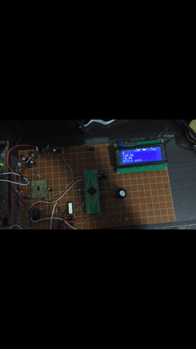

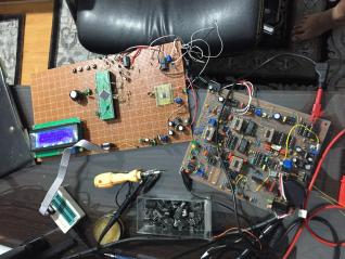

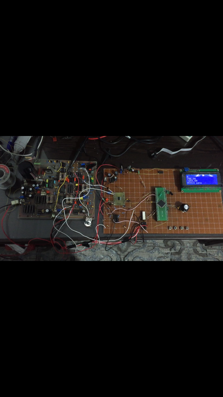

          • Hi all
            tanks of all people for affected speech
            Everyone of people make it please sharing data for all
            my new project is make Lorenz lp5 whit atxmega128
            if project to be finished cartainly share it.
            Best regards
