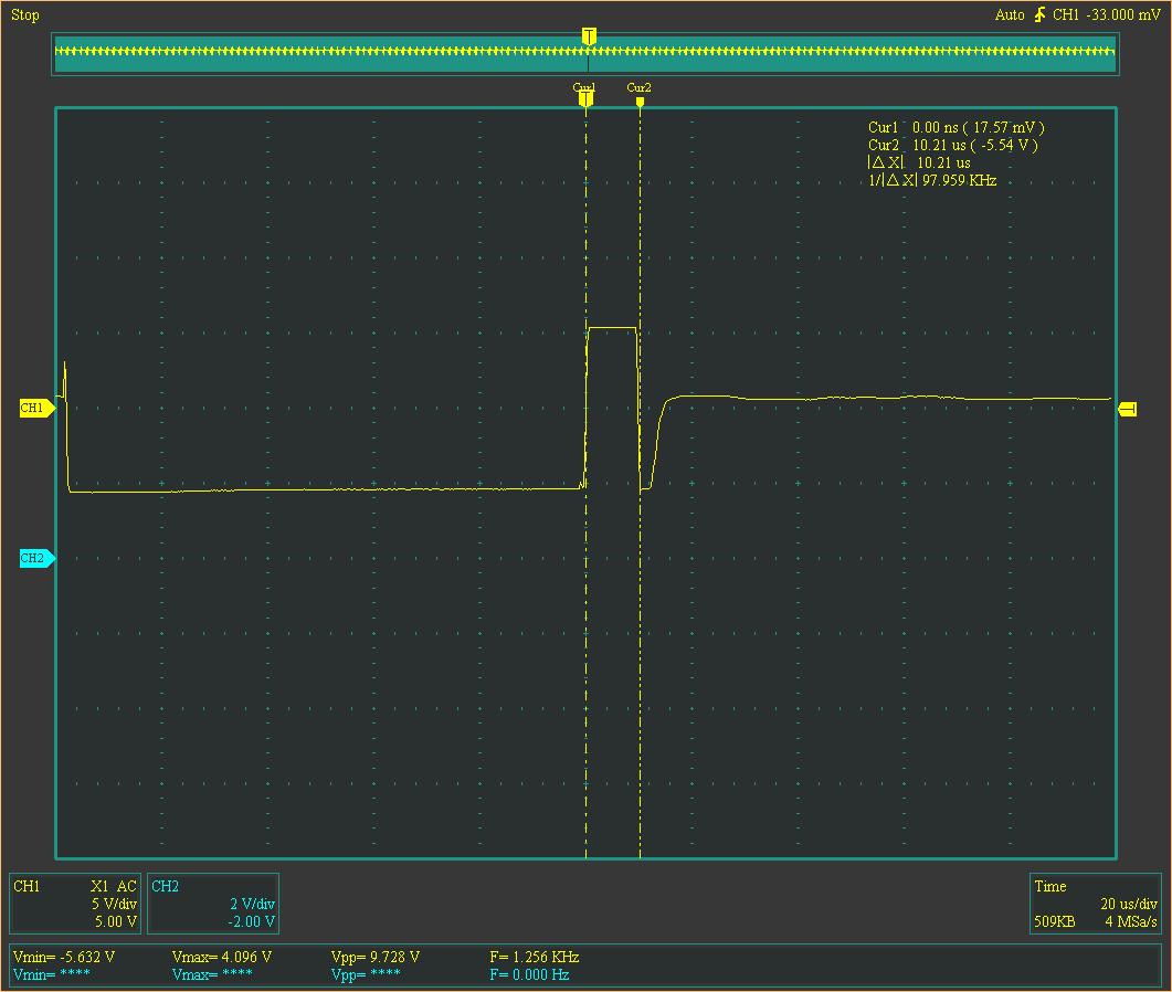

  • D10, D11 is not 1N4003 .need UF4003
    the Q2 transistor is not an IRFP460. but I don't know which one
    the signal form on pin 6 NE5534 should be as follows
Name:	LP-5 COIL 250mm.jpg

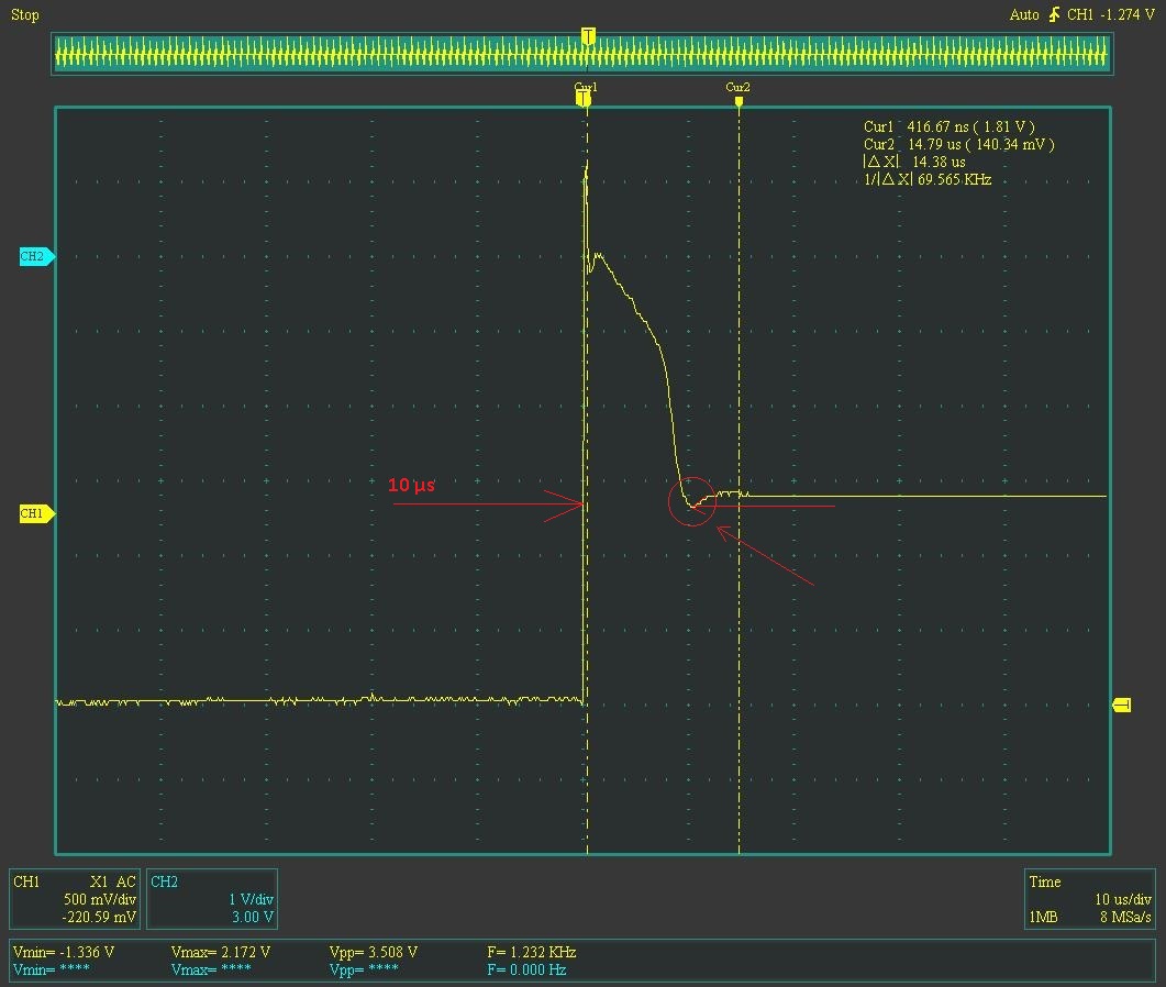

    the signal form on pin 3 NE5534 should be as follows
Name:	NE5534 PIN-3.jpg
    • measurements were made with a 250mm lorenz coil
      • mono coil Lorenz 250mm wire stranded cross section 0.22 mm (14 cores with a diameter of 0.14 mm)
        resistance 1.2 Ohm 23 turns

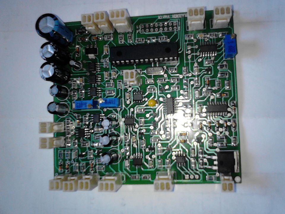

                      • just Orbit has full data on the detector but he does not wish to share it out. no schematic. nothing.
                        or, put pics of your board.
