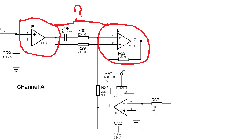

  • correctly CA3140. TL061 does not work in this scheme
      thanks #nikodimych
      061 is little working but circuit is feeding very fast channel A
      Whats the other opamp name for channel A?
      • Use generic JFET op amp like TL062/TL072

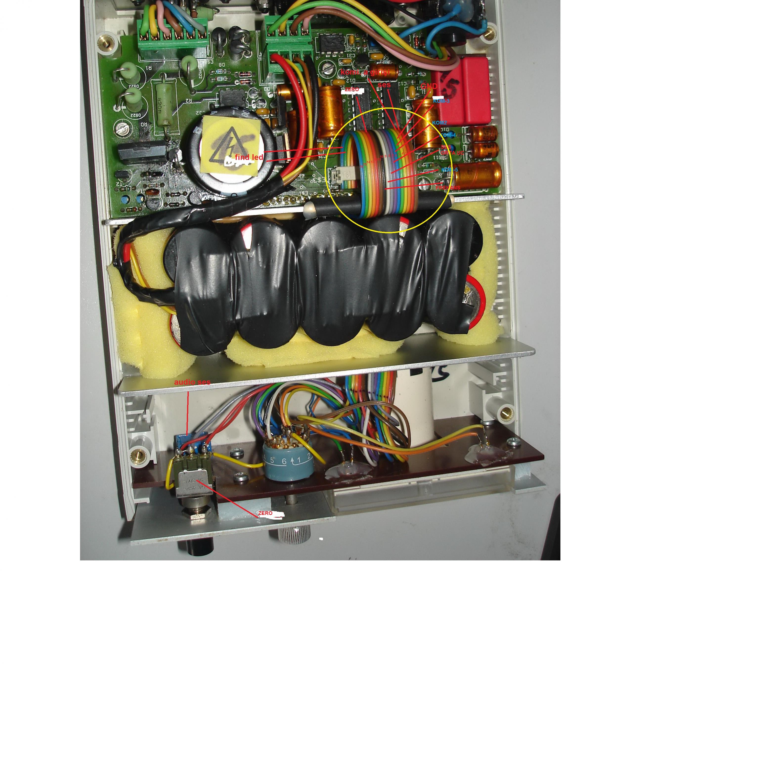

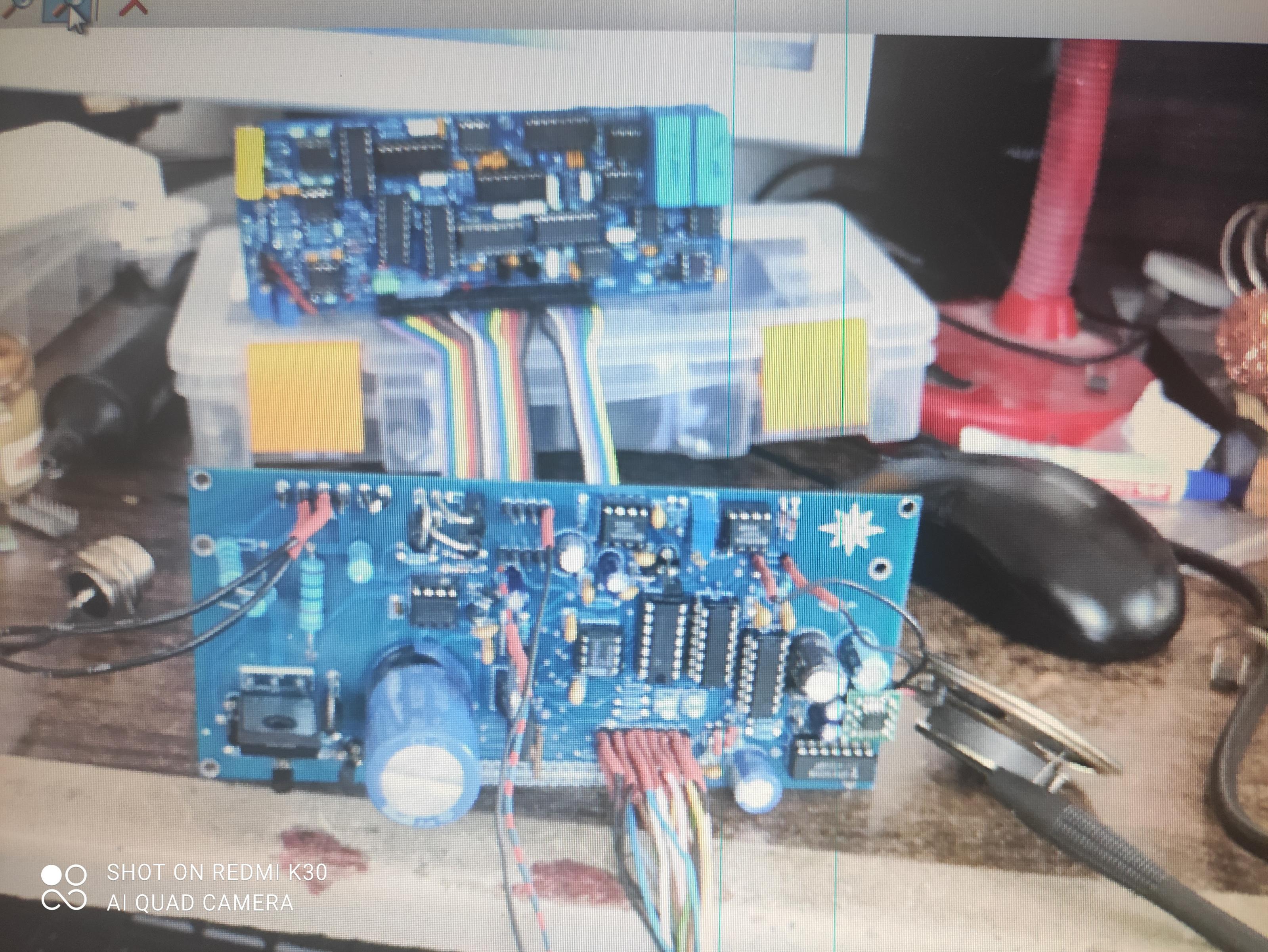

        • hello lorenz I did pulse 5 and run it. There is a problem with the commutator connections. The low battery led lights up continuously.
          https://www.youtube.com/watch?v=t4Nfi9Tt-nM
          I am used me60 have schema
          • [ATTACH] 54373 [/ ATTACH]
            bağlantı nasıl olacak. bana yardım eder misiniz.

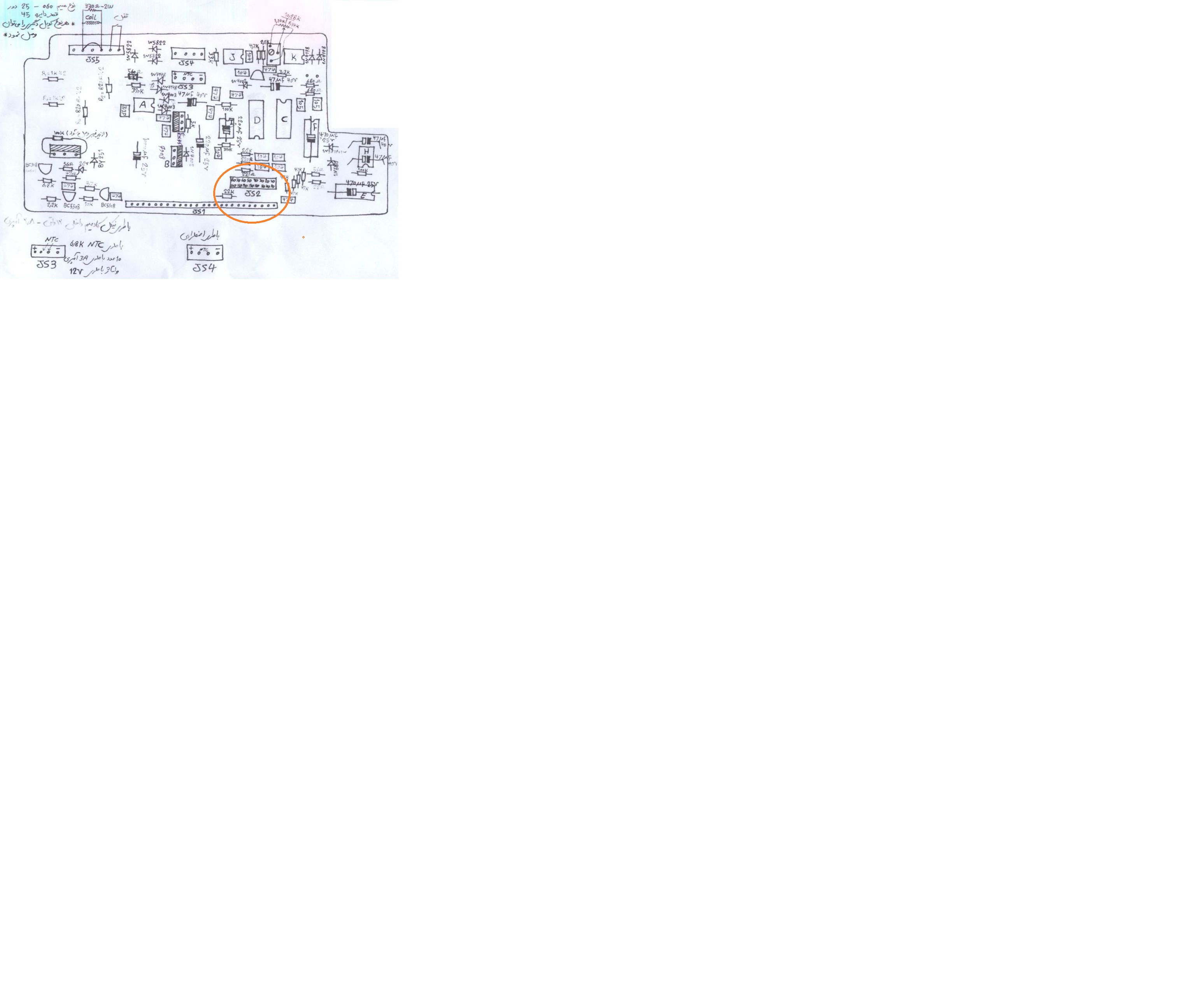

            • Are you know connection ? Can you help meClick image for larger version

                sorry,the link is dead.
                • Originally posted by YIVANKA View Post
                  Link works OK.
                  • Mdfanatik,Yıvanka thank you very much.
                    But js2 I am donete know.working but js2 note connect
                    • the detector works fine. There is a problem with the main pot and switch connections. Can you help with the links
