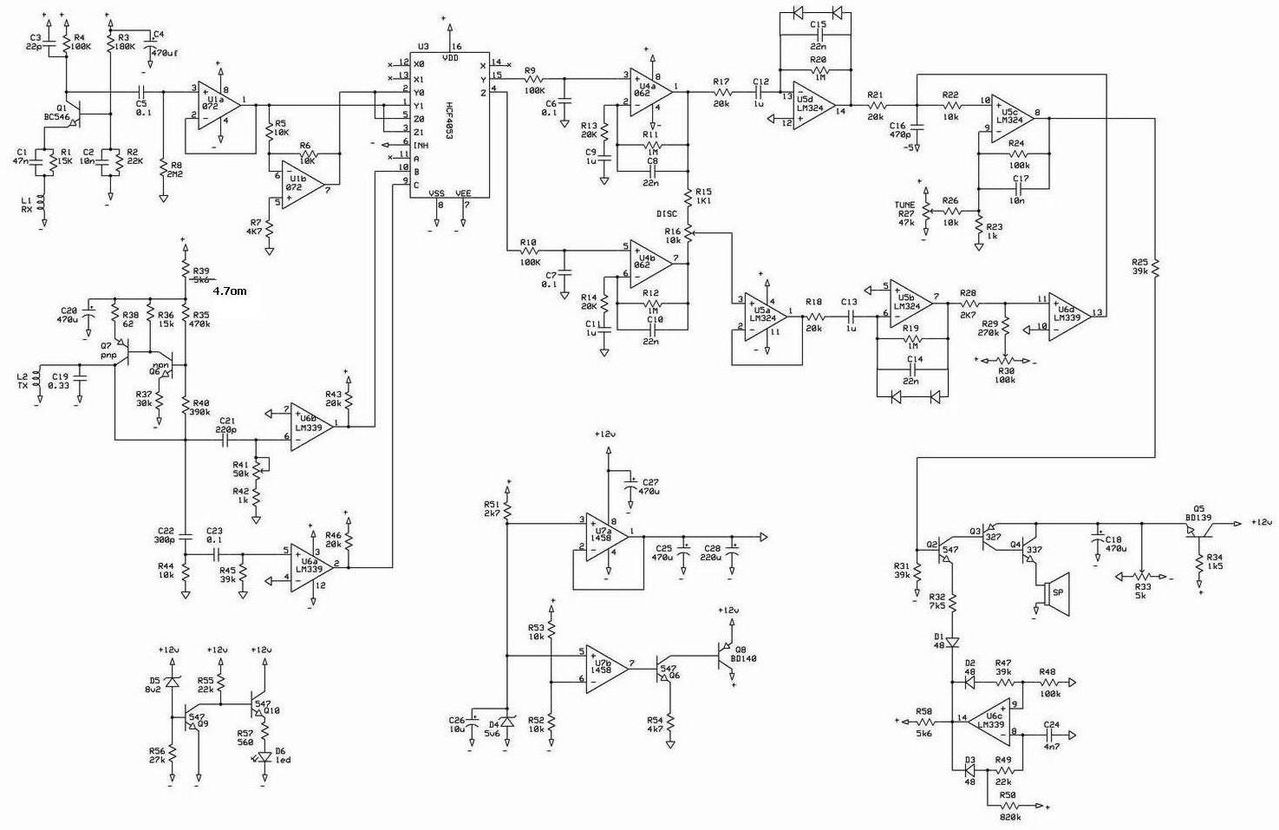

is diode x2 pin 13 and 14 of ic 324 two diodes 1n4148 in serie?

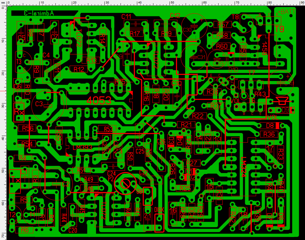

can someone upload the files for admiral 4 (sprint layout) please

ok my Admiral works
still have to find right adjustments on internal trimmer
and right tx and rx cap combination
tested with sef coil for tesoro 4pin
and minelab excelerator m
both work but they need other caps
there is an overcounted Connection
direct right under ic 1458 for what is it?
http://s5.postimg.org/o5x5ljb07/2013_08_27_170612.jpg
the power source is connected at mine between the 470uf caps

The only thing to do is to change the power of MP 324 as shown in the picture of the Turkish forum.
Download page is: http://metaldetecting.eu/index.php/topic,9.300.html
The file is DI.rar
Originally posted by bernte_one View Posti Play with the thought to connect the geotech vdi to the admiral1 (look wave shema)
and would take for x and y Connection tl062 u4 pin 1 and 7 or lm324 pin 1+14 or 7 and 8
has anyone tested already what did you prefer?
somebody thought about it?
Originally posted by Toros View PostAdmiral4 file was developed by Pantera and can be downloaded from here:
http://metaldetecting.eu/index.php?a....0;attach=2440
The file is DI.rar
