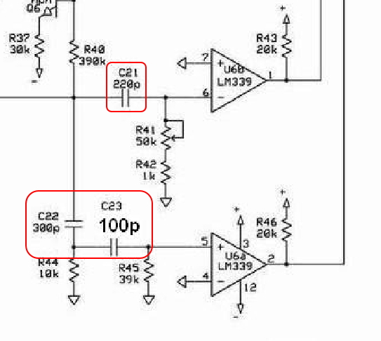

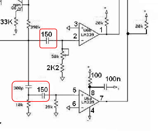

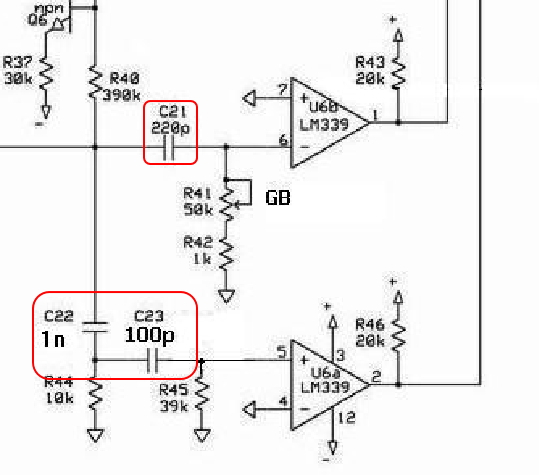

      • Hello! Collecting a WAVE and a question arose. There are many schemes with different values. For example, these. Where is right? Does anyone have the CORRECT schema with the CORRECT values? Thank you!
          • Thank you!
