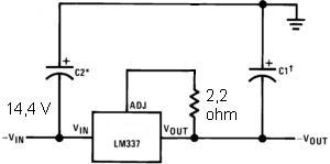

                How are you current limiting the transmit? That was originally tried on the GS 5 but abandoned later. Maximum depth will occur when the target is fully saturated and this happens at a larger tx current with pulse length designed for the metals you desire to find. Coin size objects do reasonably well with 100 usec but larger silver and copper objects or very large iron objects should show an improvement in depth with a longer pulse on time.

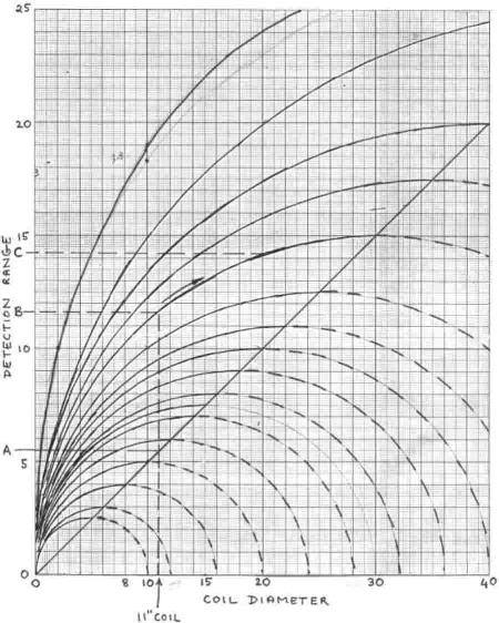

                • For those of you who may be confused with the chart, here is what Eric posted back in 2002 when he posted the chart on how to use the chart.
                  "Here are the curves I have used for many years. As Robert said, the range reaches a maximum when it is equal to the radius of the coil. Coils larger or smaller than this optimum will result in less range. To show how this works, along the bottom axis you see coil diameter, which is obviously 2 x the radius. So for an 11in coil, if we go up the vertical scale to A, we have 5.5in. Also note the diagonal line and the series of ever increasing semicircles. Everything to the left of this line shows increasing detection range up to the maximum where it intersects the line, then decreasing range to the right, where the semicircles are shown dashed.
                  If a certain metal object is just detected at 5.5in with the 11in coil, then going larger in coil size will cause a reduction (going down the dashed side), and going smaller in coil size will have a similar effect. Initially, it won’t be much, i.e. going from 11in to 8in will only make 0.5in difference but below 4in diameter, the range will drop rapidly.
                  Now, suppose with the 11in coil, you can detect an object at about 12.5in (B on the vertical scale. This indicates that the coil is not an optimum size for that particular object. If we carry on up the curve (direction of arrow) we can see that by using a 20in coil, we could gain another 2.5in (C). The curve peaks at 15in with a 30in coil. But the extra inch gained hardly makes such an unwieldy coil worth while.
                  Other factors come into play of course. The curves assume that the number of turns and the coil current is the same in all cases; which it isn’t necessarily. For the same inductance value, a smaller coil has more turns, which counteracts to some degree the loss in range. Also a smaller coil will pick up less electromagnetic noise, earth’s field noise and ground effect, which make for a smoother threshold.
                  The end result is, that with a small nugget that can be detected at between 5 and 7in with the 11in coil, so that it is on the top part of the curve, an 8in coil may well give a similar range. That is not to say that smaller coils do not have other advantages. Small coils and probes are very useful in rocky areas or searching in undergrowth. They have less drag too for water hunting, and less pickup from mineralised soil or conductive sea water plus better signal separation on close or multiple objects.
                  One other point regarding PI, is that the small object sensitivity is largely determined by the sample pulse delay. If an object is so small, or thin, or made of high grade stainless steel, such that all the signal has decayed before sampling takes place, it would not matter how small a coil you made, it would never be picked up.
                  Bed time problem for the depth junkies – If the Aquastar with a 10in coil can pick up a ring at 20in, what is the optimum size coil for maximum range, and what range could theoretically be achieved? That’s the depth at which a mere pulltab could trigger suicidal inclinations [IMG]file:///C:\DOCUME~1\Reg\LOCALS~1\Temp\msohtml1\01\clip_ima ge001.gif[/IMG]
                  Eric. "
                  Keep in mind this chart only gives an approximation and doesn't take into account noise problems or other anomalies. It does give a general idea of what one can expect if they build a larger coil and just what size might be the ideal size if you know what you are trying to find and have one of that object you can test.
                  Now in the case in the explanation by Eric shows that if you can detect an object at 12 1/2" with a 11" coil, you gain about 2 1/2 inches in depth by almost doubling the coil size and less than 4" if you triple the coil size.
                  So, this sort of shows there are depth gains but not as dramatic as one might think.
                  Reg

                    I am using the current limiter based on LM337. Not sure if the R-value of 2.2 ohms, is suitable, do not increase this value, to keep low, the voltage difference between the input and the output of the regulator.

                    JoseClick image for larger version
Name:	LM337 Reg. Corr..JPG
