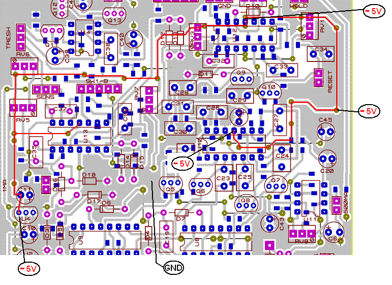

              • If using the SMD version PCB, I can assume that lack GND bridges.
                The bridges are shown as 000.
                See drawing.Click image for larger version

                • thanks dear jose
                  my pcb is smd version. when u10 not installed, leg 4 is -5v but when install u10 on location leg 4 to be -10v!
                  bridge is correct and tested.
                  • Not what the problem. I would conduct the following steps:
                    Measure the voltage at the output of U4 (79L05) should be (-5) with U10 installed.
                    If is (-10), replace U4.

                      • Amarasha
                        This is what I would do to try to resolve the problem.
                        Installed U10, I measure the voltage at U4, I follow the line of (-5) measuring with the voltmeter at all points along the way, to see from that point increases the voltage to (-10 volts).
                        It may be that somewhere GND is interrupted, or the line (-5V).
                        Could make a bridge on a temporary basis from GND to leg 10 or 12 of U10, to rule out this interumpido GND somewhere.
                        I wrote what I think, I hope this helps.

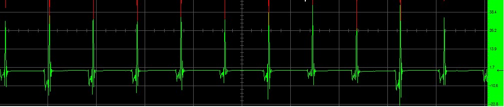

                          • Hello all
                            This is the reference that got him it came out and entered the L1 Q4
                            Is it sound To Mntabfah For the required signal???
                            Greetings to you
