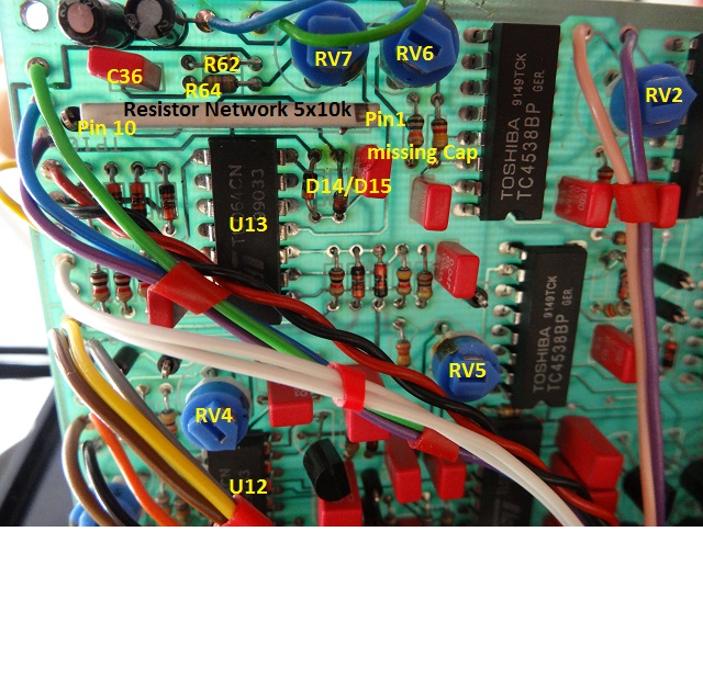

            • I have the original goldscan 4, so we have something to compare. It is without the original coil and the original battery and maybe with some otherwise set internal trimmers, but it is better then nothing. The used coil is from my Mirage and a regulatet LiPo-accu (24V regulated to 15V) is now used as power supply. I also have a o-scope.
              I´m interested to build it as a compact design machine (all in one box, the original Goldscan has 3 boxes) for inland search on not so easy ground/fields. This ground have slag and mineralic stones in it.

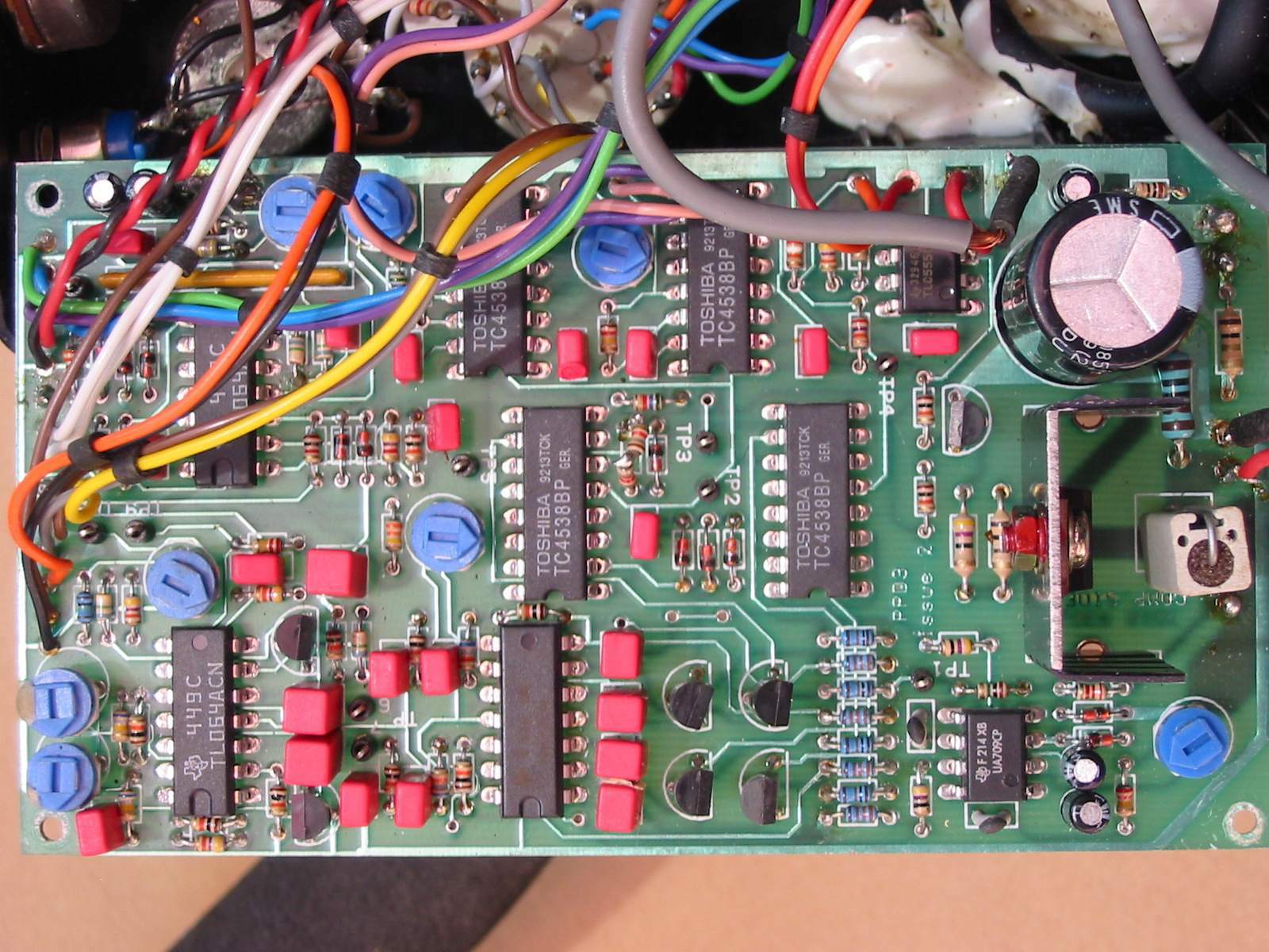

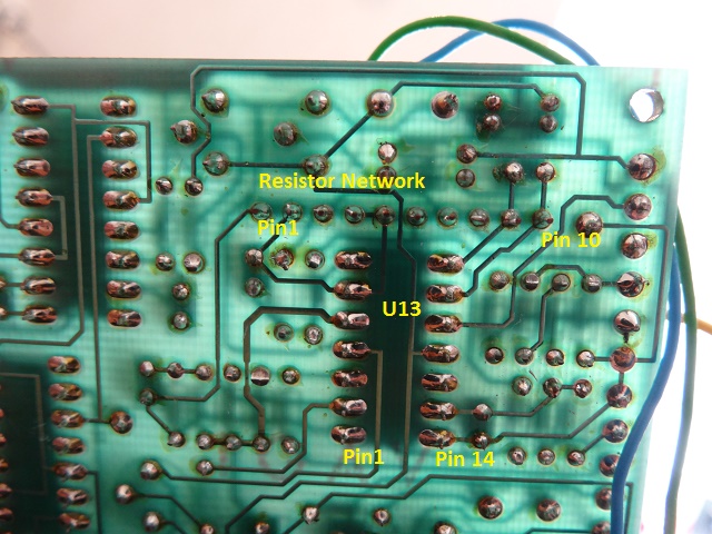

                A good place to start is with very high quality photos showing both sides of the PCB. Do you have the ability to take these? I find you do not need a super fancy camera but just strong light that is very even. Compact cameras and even the newer iPhones can take very good pics under the right light.

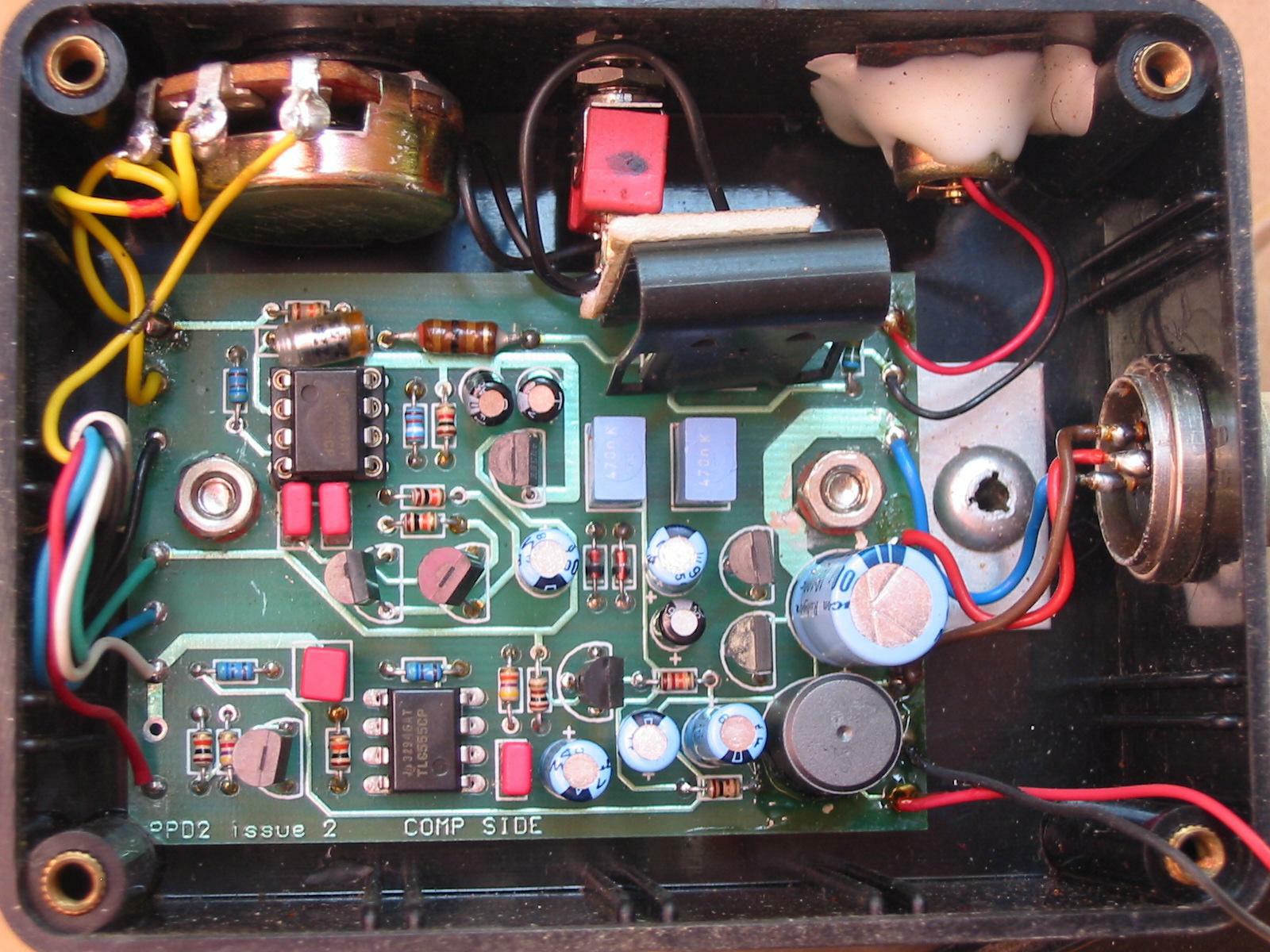

                • You can use this schematic. It is very good. I have also a lot of pictures and can make more.
                  • Here is an other one complete 1. pcb and complete 2. pcb. It is not my Goldscan. These pictures I have collected from internet. I have a lot more of pictures, schematics... from Goldscan.

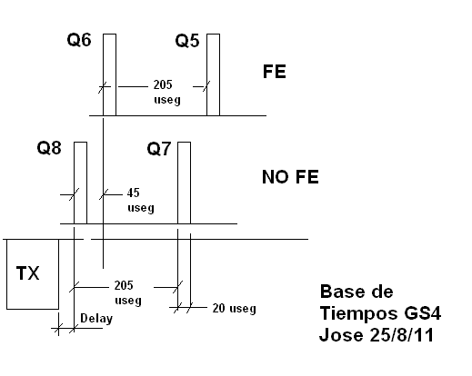

                      could you please tell me the width of your TX pulse and how many PPS, thanks.
                        JOSE
                        I do not know exactly the pulse width TX, because I have installed a preset, for optimal fit between power consumption and performance.
                        I adjusted in 150 microseconds for TX.
                        I think in the original scheme is 200 microseconds or a little more.
                        The frequency is adjustable between 450 and 550 Hz.
                        Jose

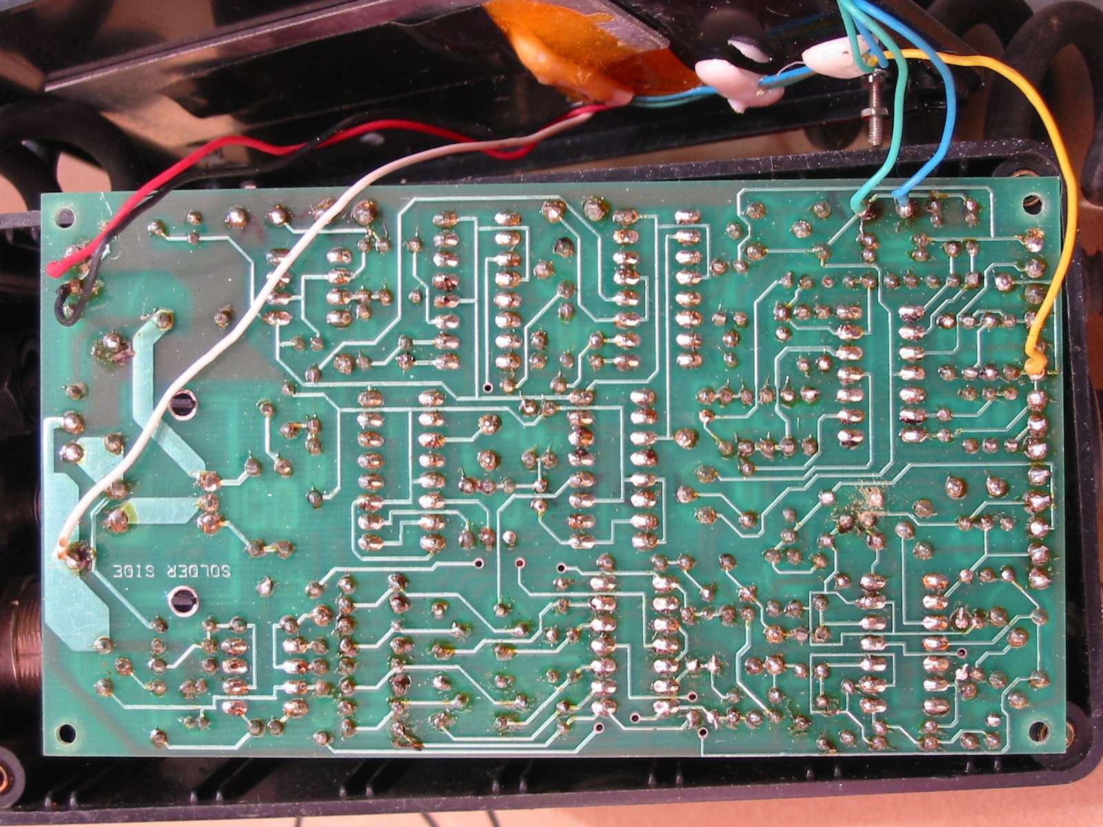

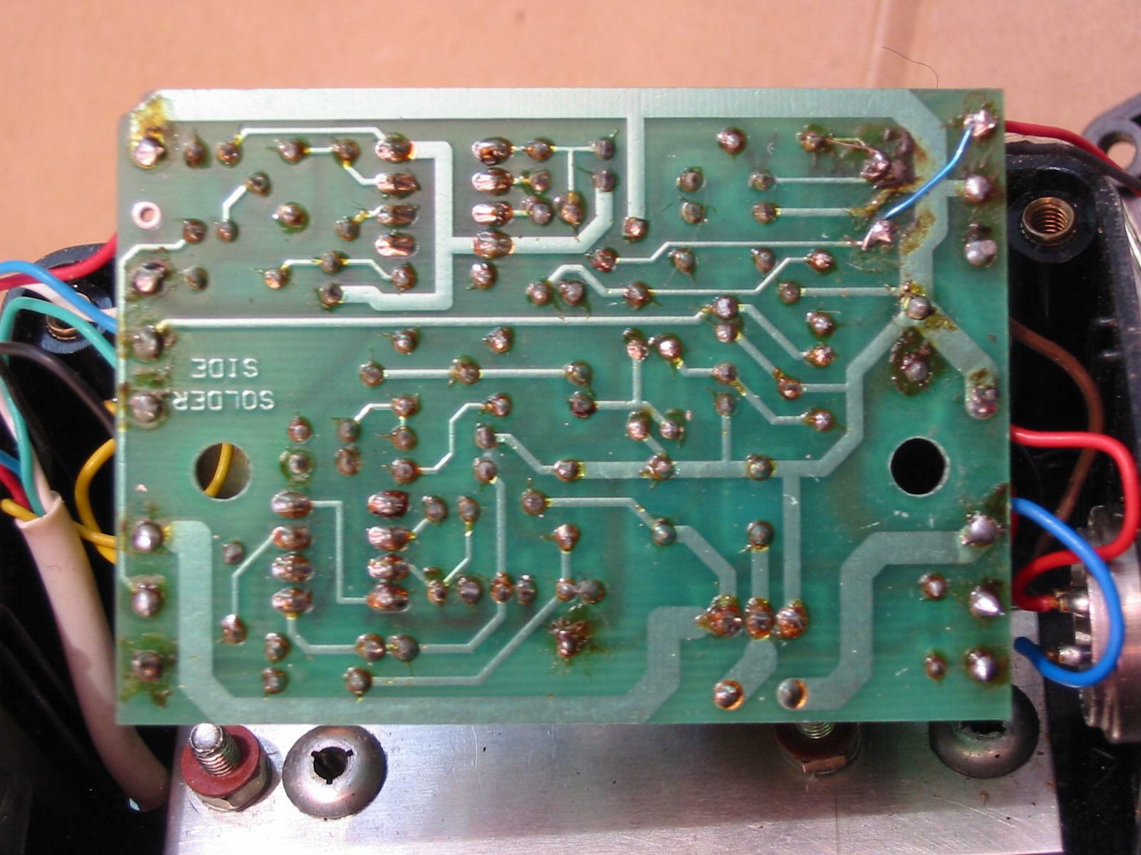

                        • MSCH Thanks for all this pictures and schematics. do you have nay pictures of the back side of the circuit boards?

                            • Originally posted by Old cart View Post
                              Here they are. It´s the same on my PCB, but the pictures are from alex. The smaller one is from the power/audio PCB.
