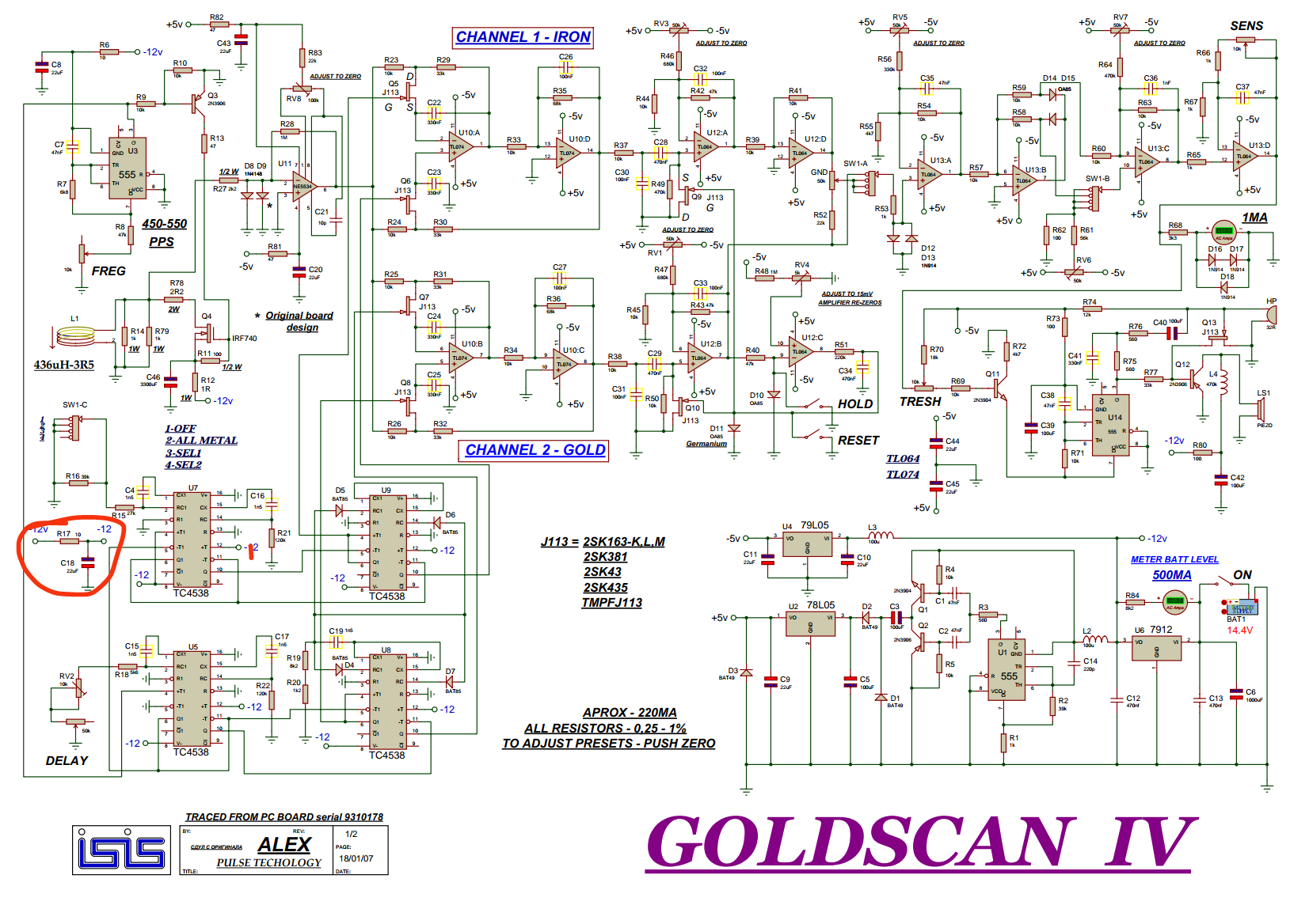

LOOKING FOR GOLDSCAN 4 Schematic.
    btw... i already "transfered" previous pcb draw into SL5, just to have better control over it and to much more easily perform some checks.
    This is just first step in process of drawing new board.
    Enjoy

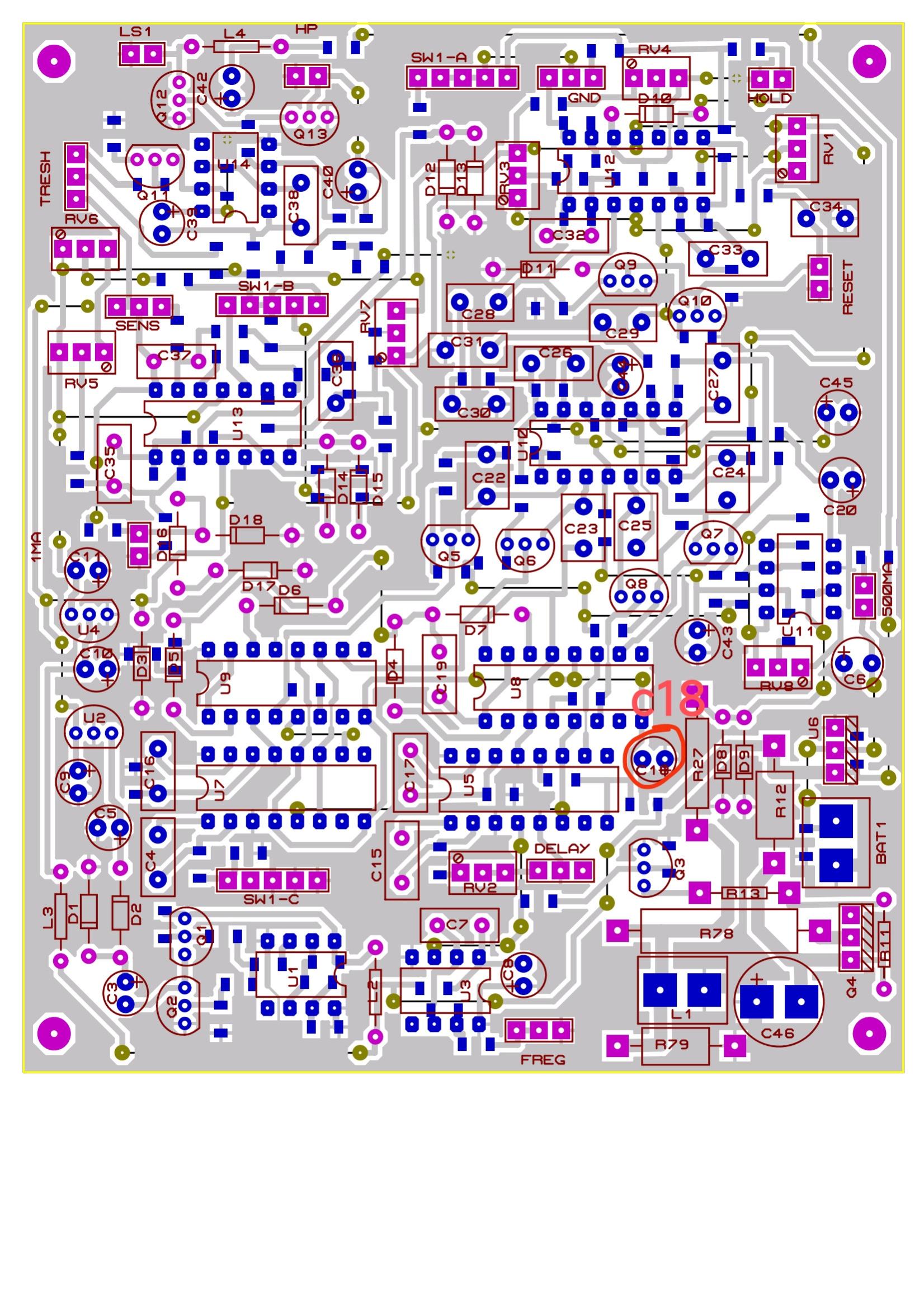

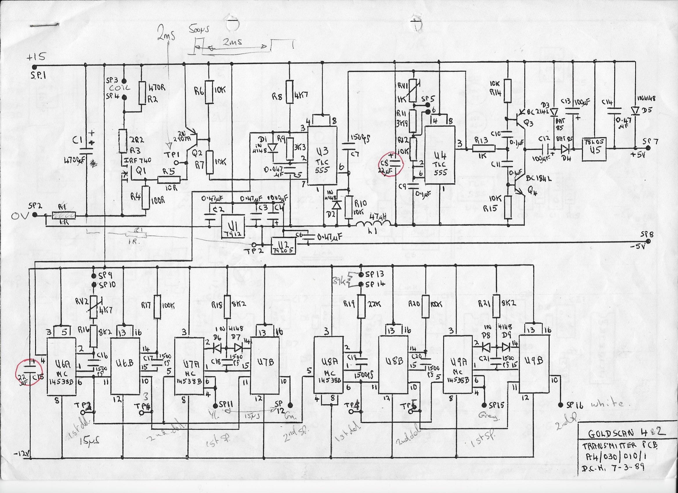

ID:	363588What is the principle?
        • Both sides of the resistor are -12
          • Hi,
            if you take a closer look at the schematic again you will see that the resistor is connected between -12v and -12. This are two different voltages.
            • Zoujiarui, It is for stabilize the voltage (Decoupling with one resistor and one capacitor)...
ID:	363589Thanks, I see. Then here should be c18, looks like c10

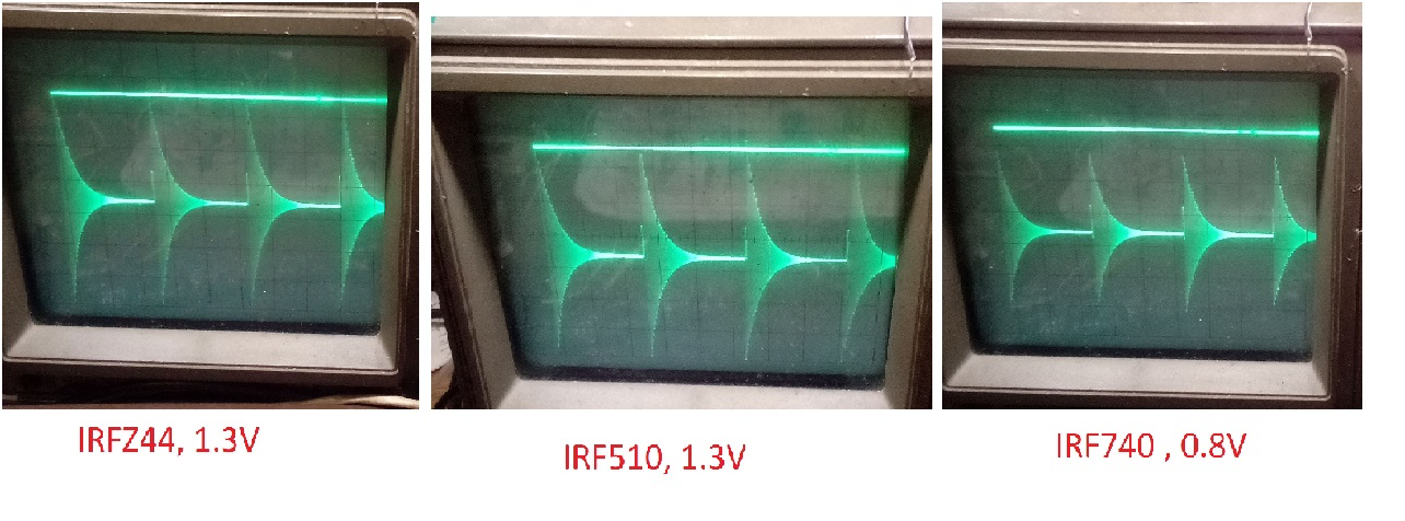

                    albeit with a reduced range. = try different MOSFET to increase Tx power, IRFZ44 and IRF510.
                    From which distance from the coil you can see signal changes for coins on oscilloscope on U11 pin #2 and #6 ?

                      • High voltage on the coil is ?
                        Tx power @50 cm
