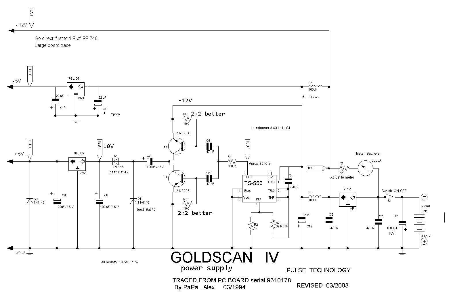

LOOKING FOR GOLDSCAN 4 Schematic.

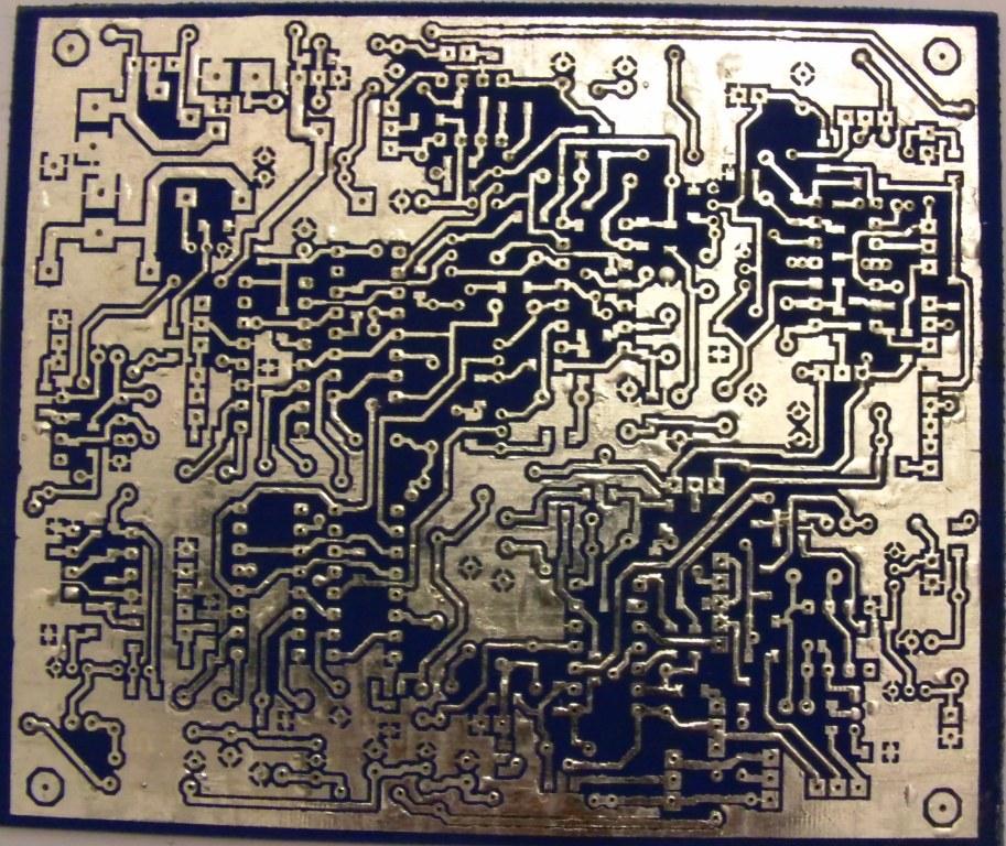

              ready to start
              here my pcb hope i can finish it this winter

                • #83
                  Wow, looks really good .... I bet a lot of people would like to build these if a drilled/etched board was available (hint hint)
                  • #84
                    if i had more time i would do some for forum member
                    but i takes to much time for me now
                    (house and family need me)
                    it is made by toner transfer method
                    you can do it easily with some training
                    drilled with 0,6mm drill

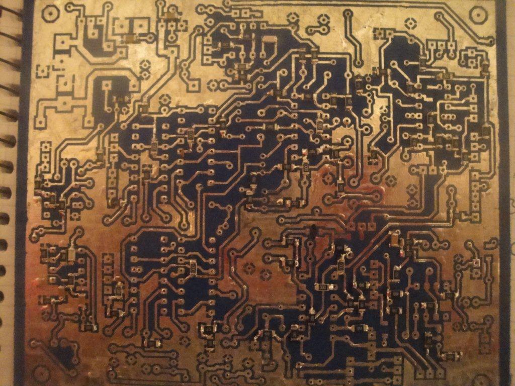

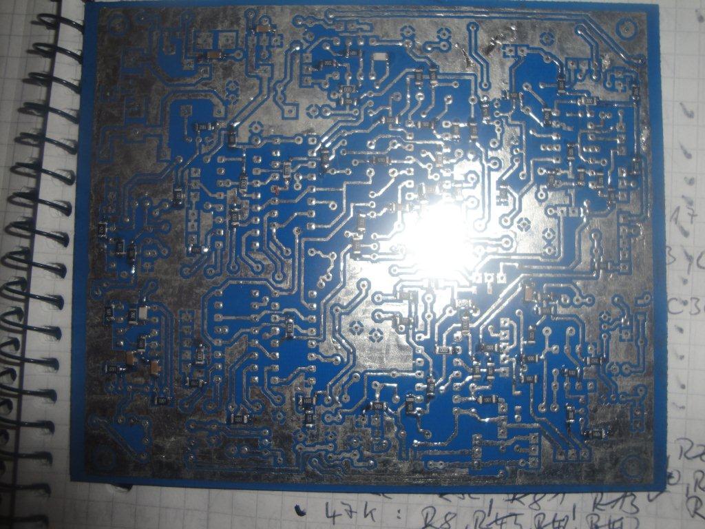

                              • #90
                                my first goldscan 4
                                I´m building my first Goldscan 4. I got a PCB from bernte_one. I want to build it with ideas from reg (high conducters, low conducters; without RV 1, RV 3, RV 5, RV 6 and RV 7; OPA 4277; other switches); with the power-circuit from porkluvr; and the Schematic from Alex.
