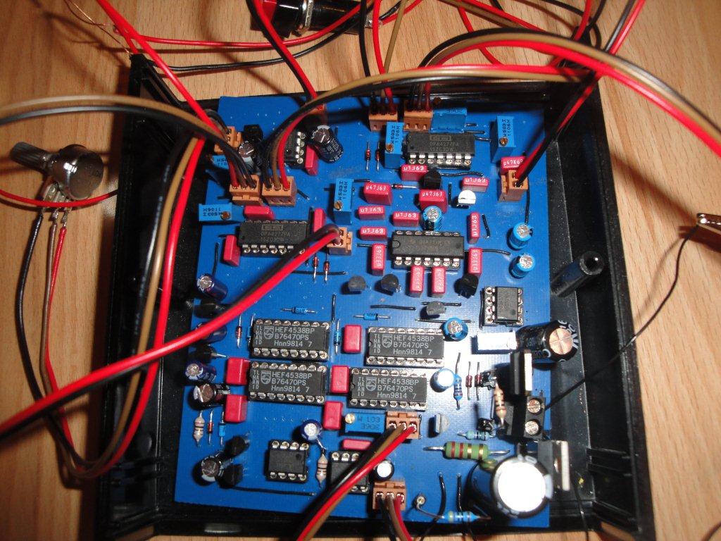

    Now the Goldscan is working.
    The deep is not so good (only 10 cm for 1 Euro) but the test-coil only have 350 uH and 1,4 Ohm.
    Next step is to build a coil with 400uH and 3 Ohm or change PCB for a dualcoil.

                  I built the GS4, the PCB used is different from what we see here, is one face that I found on another forum.
                  At first it was very unstable and impossible to adjust, the cause was the noise.
                  This noise had two origins. One is the PCB, perhaps because of poor design, and the other originated in the source of 5 volts, corresponding to the circuits 555 and associated components.
                  I replaced the 555 by 7660, the scheme copied from HH1, and the noise decreased considerably.
                  Make bridges on the PCB, which corresponds to GND, and make a shield to 5534.
                  It's working well, is very sensitive, and fully rejects iron. Be careful with discrimination, which can reject bronze coins larger.
                  There are different circuits GS4 in the forum, with different values ​​of some components.
                  What worked for me are:
                  R49 and R50 are 470K.
                  Potentiometer 10K GND must be
                  Apparently lack a capacitor between the legs 6 and 7, U13: C, as shown in the original photos posted in the forum.
                  I put nf 220.

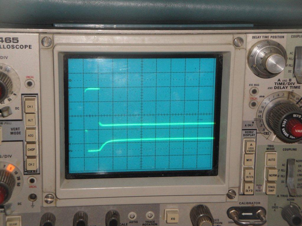

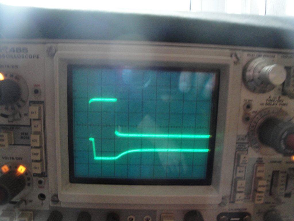

                        Here is a Scopeshot of first sample.
                        bottom-line is Output of NE5534
                        upper-line is U5 pin6/11
                        First picture 5V/15uS
                        Second picture 5V/5uS

                          The image of the oscilloscope, looks good.

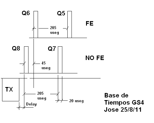

                              Señlales check for the integrator, in the channel of iron.
                              Deputy scheme GS4, home made.
                              Jose
