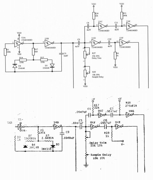

      similar shematics
      hello.
      I see nothing of diffirencies the schematic from Hammerhead project absoliutely. it's worth of time to do a project from zero point. the time is a money... the money is the gold toothes...
      yours sincerely
      Anatolij

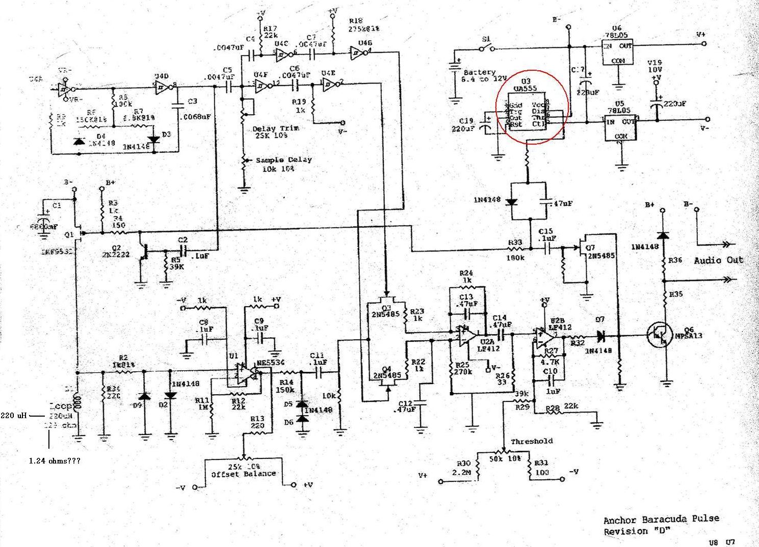

                    Barracuda "the original"
                    This is the Barracuda revision "D" (maybe original), with error (555 instead voltage converter) and some values isn't in it. Has somebody success with it?
                      Thanks Esteban.. very interesting, also KT315 posted this one before.
                      There are some striking differences between drawings - check the timings part of the circuit (also the most problematic part). Voltages, resistors values...
                      Also: where is it written what U4 is? Do we only assume 40106 here?
                      I'll try with new values when I'll have the time... I still have that nonworking PCB I made one year ago.
                      Geo, Porkluvr, ApBerg... any news on this one??

                        Hi Leto.
                        No results yet. I stop it because now i try a ATtiny4 and 2 LRL
                        Maybe after a month......
                        I tried to modify it (the sample pulses) but without results
                        Never mind

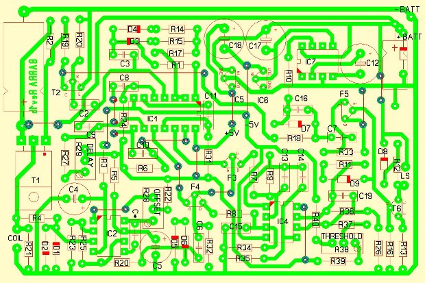

                          Barra
                          Hello Frends.
                          The first board I made was working reversed, metal near the coil made it silend, never made it working, there were also some problems in the pcb layout. Have made a new board in SprintLayout 4, Never even made it...
                          Making Pcb's is fun, even if I never built them.. (kind sudoku...I think)
                          The Schematic Esteban has send is having a wrong 7808 must be 7905 for the neg. volt.reg.
                          Wel send the new pcb, but.... there can (will) be errors in it ! if you have no background in electronics to not make it !
                          regards.
                          Ap
                            Hi Ap. How are you ???? long time to read from you.
                            I constructed the pcb from the schematic that you gave me, but there is problem with the sample timing. I tried to change the timing, using 4538 and 555 but without good results. I must match the voltage of each stage, so it is the same as to construct a New detector. I leave it and maybe an other time to try to modify again the timing so to make it to work. The basic problem is that the second sample is near to the first, so it minus the signal and the total gignal is near to zero.
                            My regards
                            btw... you make good work with the drawing of pcbs. Who program do you use???
