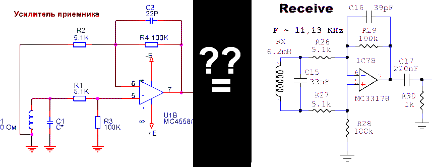

Bandido II revised schematic
    what I did mean
      The first one is wrong.
      The second (right hand) is the proper differential amp. IMHO.
        Re: what I did mean

        I see, but, if the Eldorado and some others schematics from Tesoro have RX coil connected to ground, it seems that it is not the case for the Bandido. (see Carl's schematic)

                folks, it is THE MISTAKE. that was spreadly discussed many times. you can ask Carl and Sean. but your right is to do it ANY WAY!!! (-)
                  Re: what I did mean
                  The first one works, but the ground has to be connected at the end of the coil cable (in the coil). Not on the PCB.
                  otherwise, the cable participate to the detection and each time you move the cable, it is beeping ! not stable at all !
                  I have experimented it (
                    Re: The first one is wrong.
                    As far as I know, all Tesoro designs have the RX coil hooked up differentially. The coil has no ground connection.
                    Now, I happen to have a copy of a genuine Tesoro schematic, and it shows the RX coil grounded, even though it's really not. I was once told that Tesoro (and other manufacturers as well) put intentional errors in their schematics. Seems rather silly to me, but there you have it.
                    - Carl

                        Re: Bandido II revised schematic
                        Ok Gene, Dave, Gary, Carl....
                        Most significant was to agree at least with the schematic and the values of the components.
                        The polemic with the ground connection of the cable can be easily checked.
                        Do you agree ?
