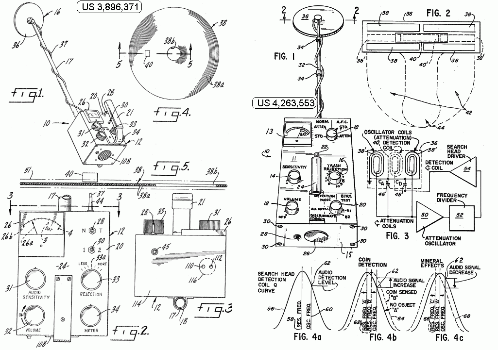

    Could you post a picture of the machine so we could match it up with a schematic from a patent?

      There are two patens ussued to mr. Hametta (president of A.H. Electronics):
      US 4,678,992 Electronic metal detector
      and US 4,263,553 Discriminating metal detector with compensation for ground minerals
        Daniel, to which of these models is similar your machine?

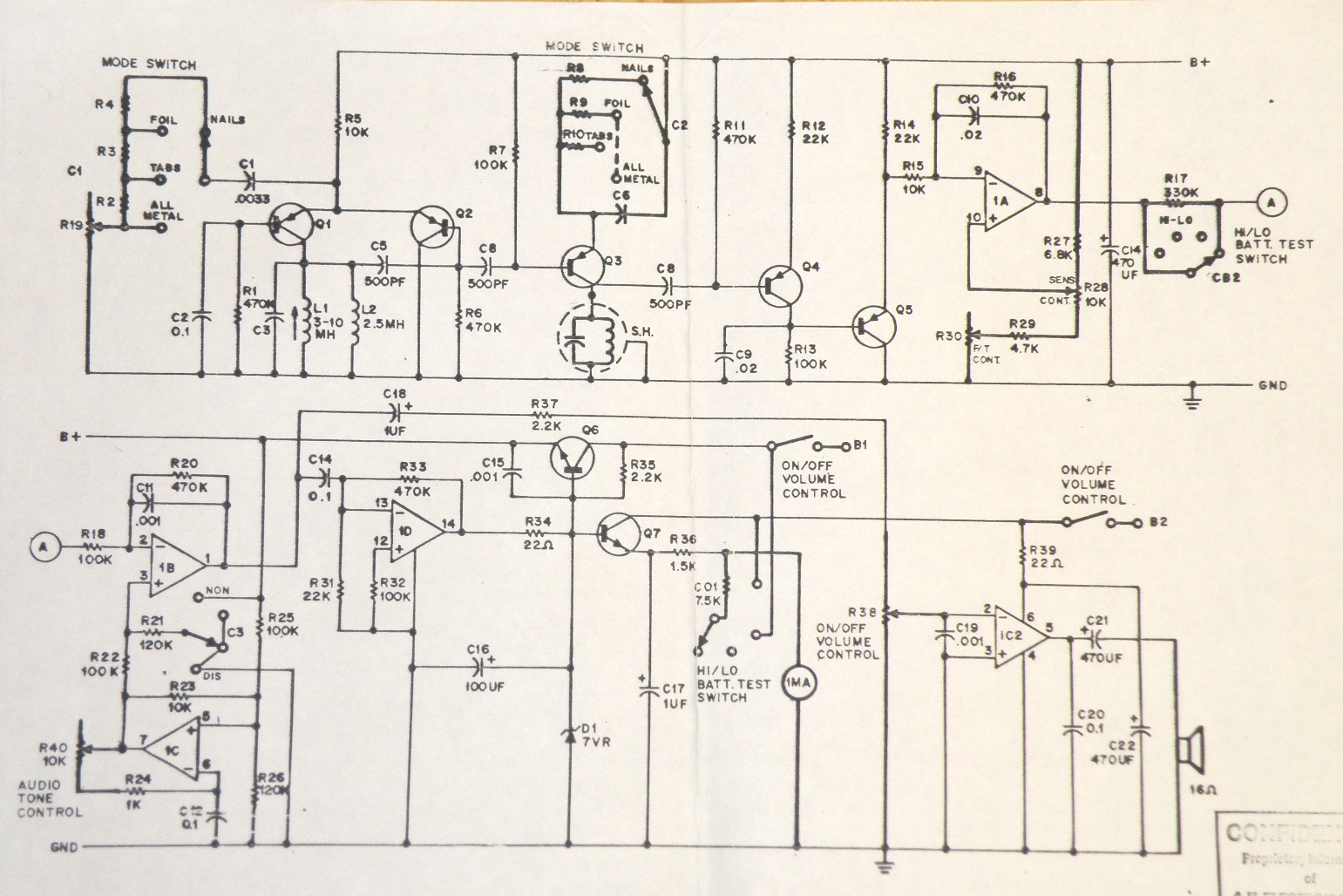

                  well first off im sorry for not posting pics..the guy that worked on it sent all the old components back with the detector.he replaced the 14 pin ic and all the transistors and about 5 small caps.not sure if he replaced the electrolytics but i think so.also replaced the metal tuning can.ive got a schematic that he sent me if i can figure out how to post it..ok i think ive got it..thanks for the replies so far

                      Actually it would kinda make sense if this was an intermittent failure. From the schematic that you posted above this detector is represented by the 3,896,371 patent shown above.
                      The question I have are which transistors were replaced, what the numbers were on them, and what are the numbers for transistors Q1, Q2?
                      But I do not think those are the problems, My bet is that you are dealing with a dirty pot R19 which is 30 years old and could have loose crumbs of carbon on the wiper causing loss of tuning. I bet that the company did not replace that, as it's not always an obvious problem. According to the patent the value of this pot is 1K, but I would measure it to make sure. In fact, if you take it out of circuit and put a digital meter on it you might be able to see the value wander on it over time. A couple of ohms is not bad, but tens of ohms would be.
                      If it was me I would switch out the resistors in the part of the Q1 Q2 circuit (R1, R2.R3) with metal film resistors which will add some stability. Change C3 to a polystyrene capacitor.
                      If the transitors Q1 and Q2 are germanium types (not unheard of mid 70s) then that would be another source of instability. Ge transistor's gain can skate all over the place with a change in temperature. I would use a couple of matched 2N3906 transistors there instead.
                      But I would change R19 first and see how the performance improves and if this fixes the problem or not. Then chase after improvements.
                      This is an interesting circuit operating at about 53 KHz that doesn't fit in any specific detector category, but probably has the same sensitivity as a BFO. Apparently it does have some discrimination ability that at the time would have been pretty rare.

                          Two other things. I would also change out all of the electrolytic capacitors at this point. I really did not read carefully your post about how the needle would get pegged. This really could be an old cap problem - C14, C16 are primary suspects. I would also get some contact cleaner and clean the various rotary switches in the machine. After that I would get an O'scope and trace the signal (after the caps were replaced) if the problem persists. Welcome to the world of troubleshooting!
