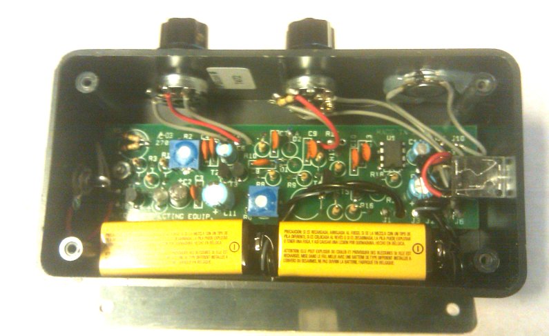

                  This is what the inside looks like. It works well going thru concentrates to see if anything of value might be there or not. Good for poking around tailings dumps as well. Useless for much of anything else.

                      Here's a schematic I drew many years ago. Its missing some values. It looks like they up
                      graded the audio in photo. The one I had only had a piezo speaker and no ICs. It's a loaded loop detector (studfinder) which uses a ferrite core. Easy to breadboard and get working.
