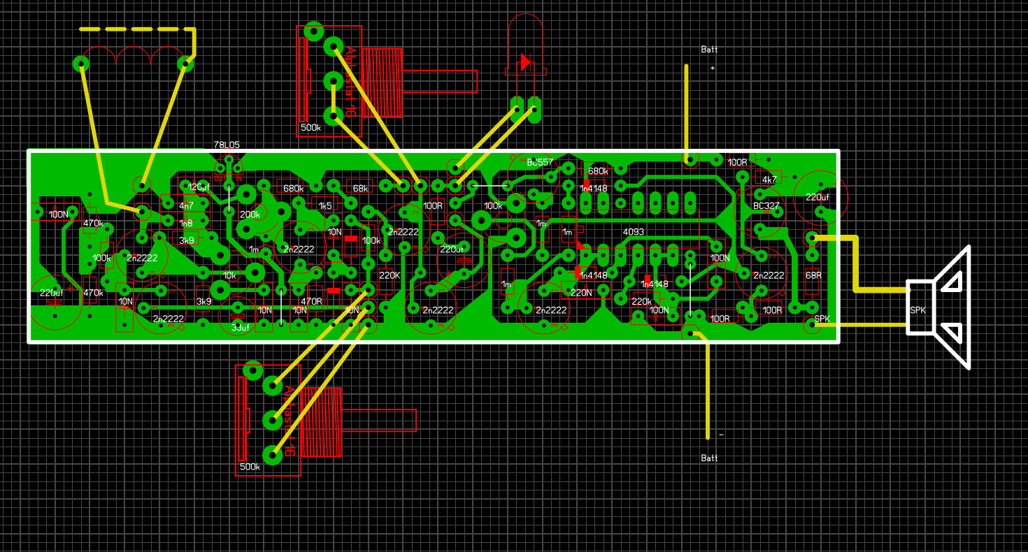

  • sorry guys this is the final ignore previous 2 lay files had to add the 78L05 to it
    md20-final.rar

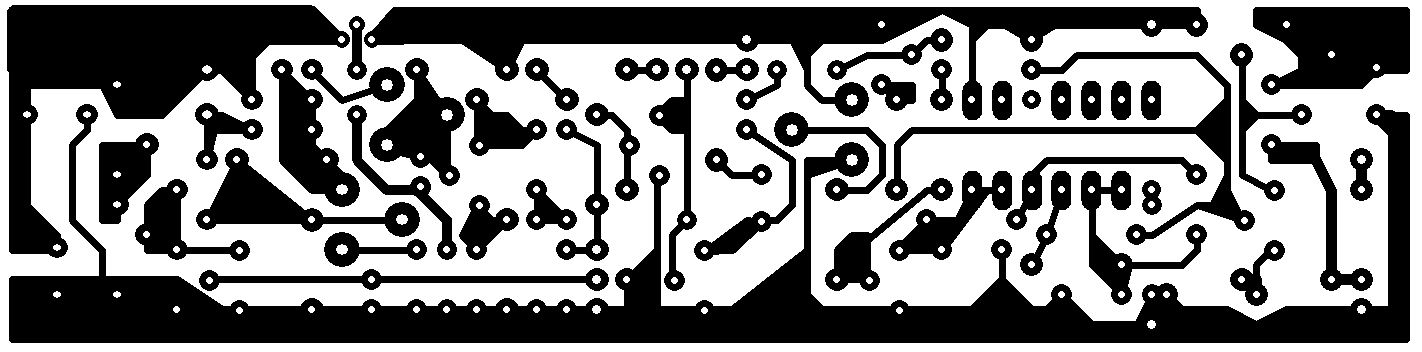

    • Can you post just the Copper Layer ?

        • Which one is the Last? Fixed for the Attached md20.rar ???

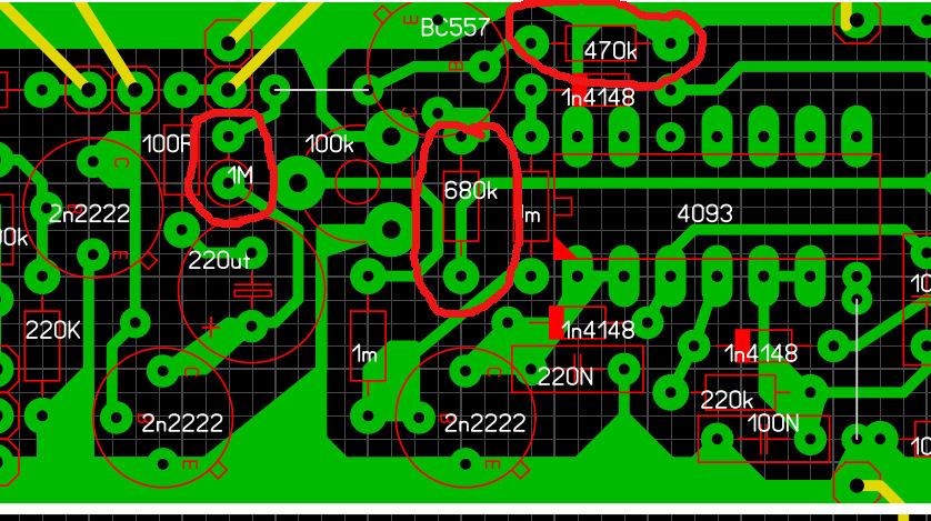

          • yes it is the the one marked MD20-final circuit board should be right now i just have to check last resistor values i used around VCO and this is the final values i have soldered in I would suggest some one check against the circuit diagrams as i had to reverse engineer some of it because of the changes i had to make.
