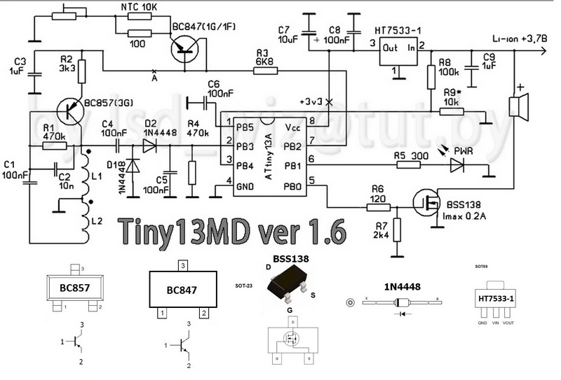

            • this is the Russian pin pointer thermal stability circuit that i found not sure how well it works haven't built it yet.
              shouldn't be to hard to adapt to this circuit it is everything around the NTC resistor on the positive supply line to the oscillator.

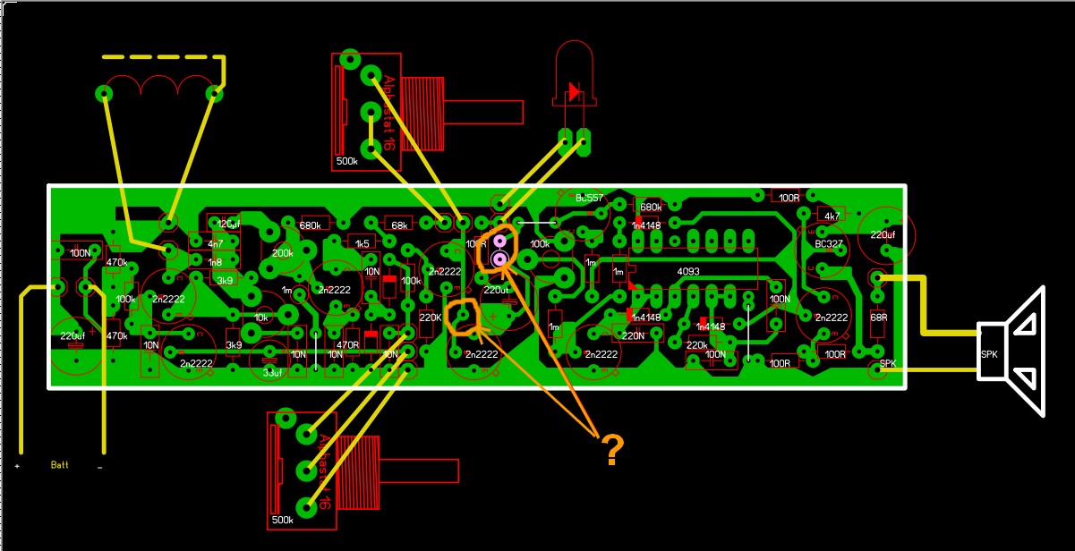

                      • Please help. What is in these places
                        • Sorry my MD20 schem/lay has a 555 ic not 4093. I have not come across this before. Perhaps it is something else??
                          • Thank tim
                            Maybe there 's an error in this pcb
                            • Read through thread from start. You will find answers to all your questions.
                              • Yes it is dom44 version 4093 is VCO (post #153 here). Sorry db/karim. My bought MD20 with 555 works just fine. Your query-below LED seems to be an end-standing resistor( see schem for value). Nothing connected at point above 2n2222 (?)
