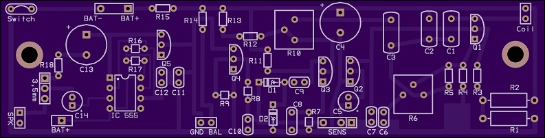

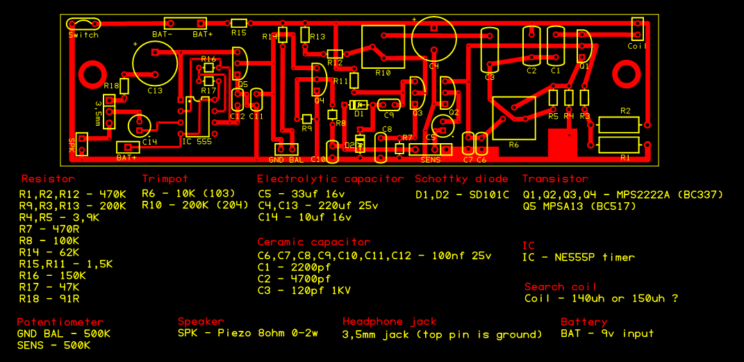

              This IMG and Lay6 is the best version I have. Schem is NOT MD20 but MD8 (pre-555).

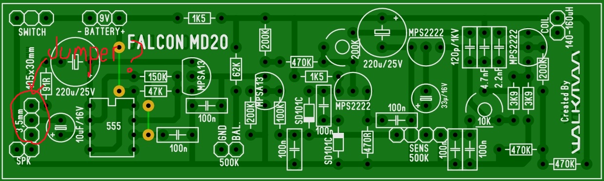

              which one is the best MD 20 with 5555 or 4609 ?
              • hendra, my Draw. Not test it.
                Enjoy it
                SD101C or Bat48, Bat85, 1N916,1N5817
                MPS2222 or 2N2222
                MPSA13 or BC517
                you can use.

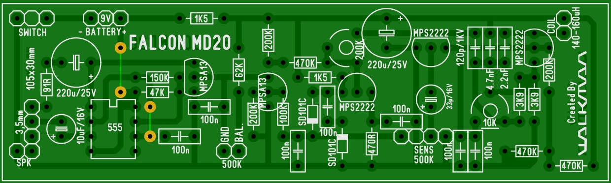

                • Originally posted by walkman View Post
                  Enjoy it
                  MPS2222 or 2N2222
                  MPSA13 or BC517
                  you can use.
                  Thank You Walkman
                    Enjoy it
                    MPS2222 or 2N2222
                    MPSA13 or BC517
                    you can use.
                    3,5 mm it's jumper ,..on your draw ?

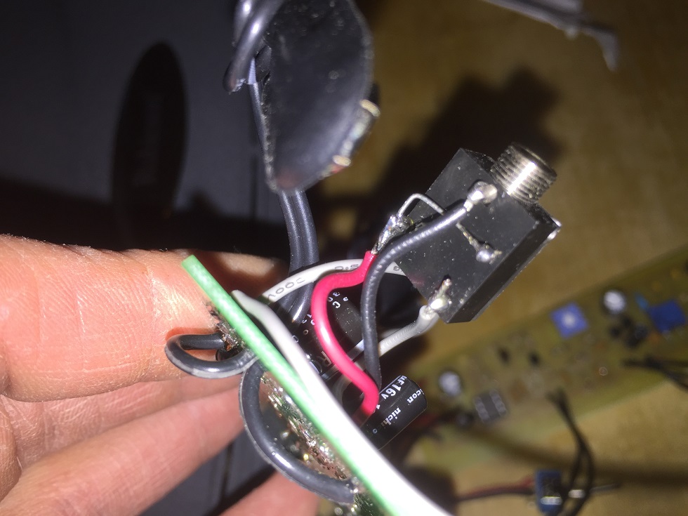

                        3,5mm it's headphone jack

                          hello walkman, original MD20 use two baterai 9v , it's one baterai just power for audio?
