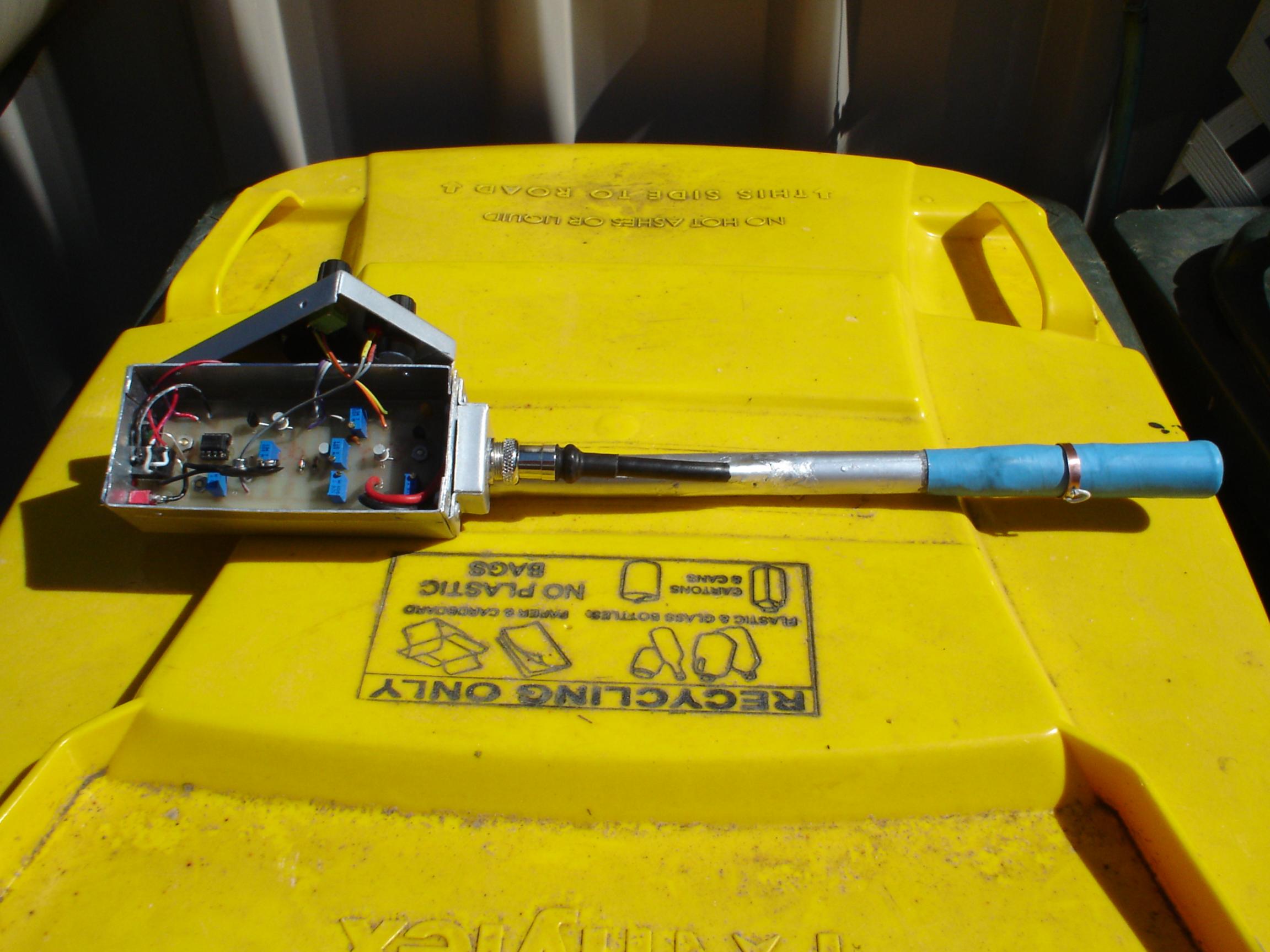

                    Noro, my coil is wound on a 10mm ferrite rod 100mm long using .2mm enamelled wire tightly wound about 50mm long and measures 153uh and 1.5 ohms it is now shielded and covered to make it waterproof so a picture will not help you.
                        Hi Noro,
                        No only wound on ferrite rod picture above the shaft is not aluminium it is plastic just painted to match the box below the ferrite section.
                        Regards, Ian.
