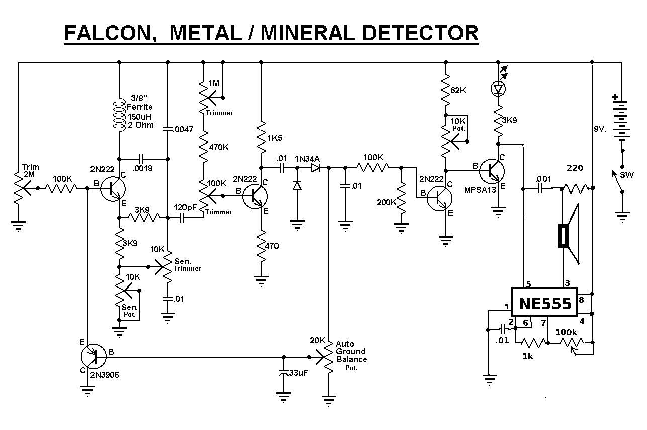

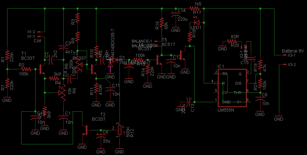

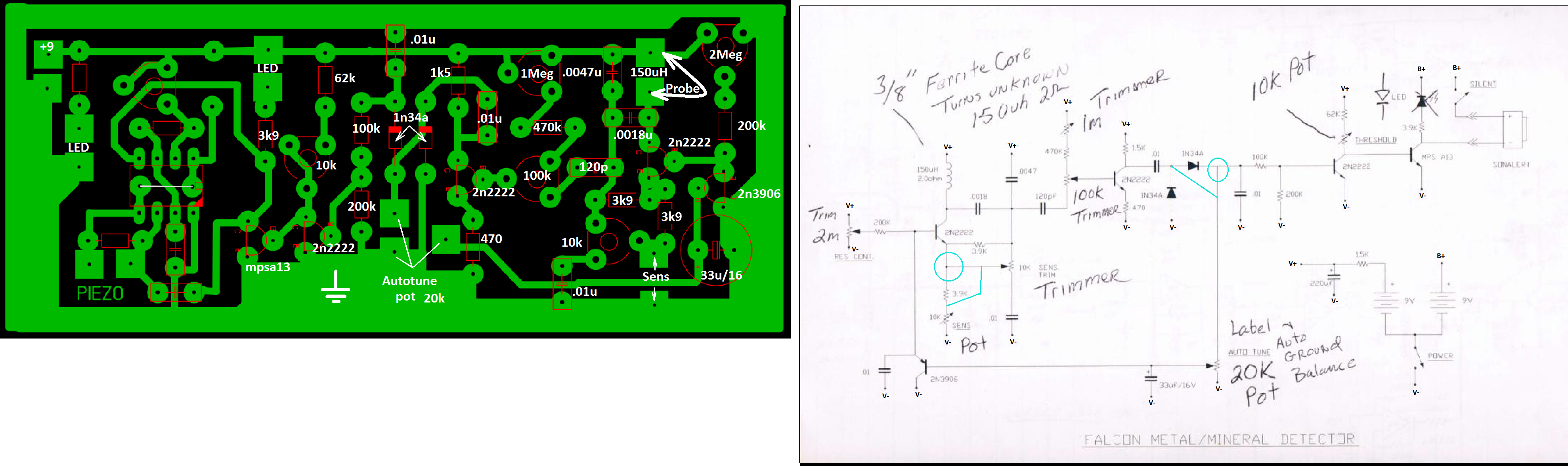

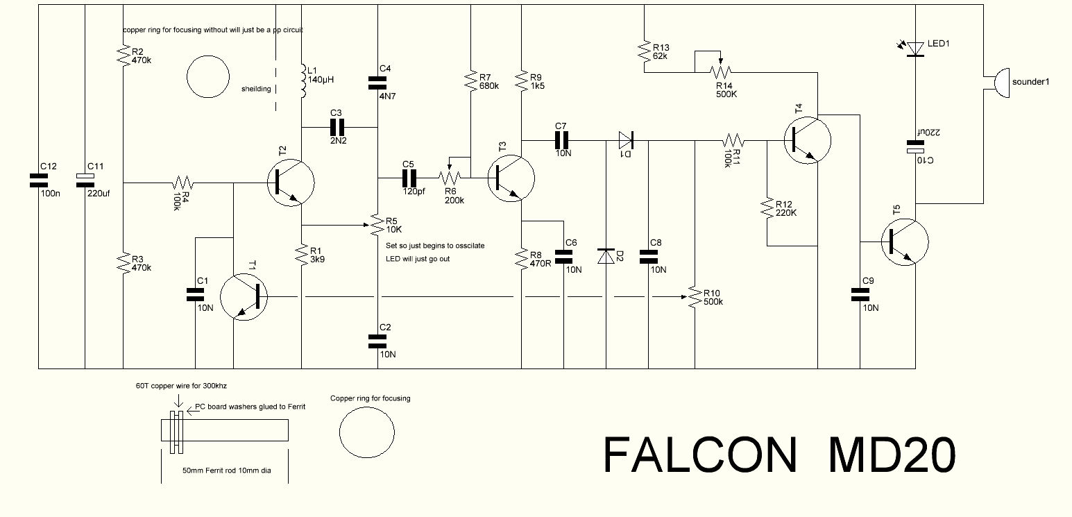

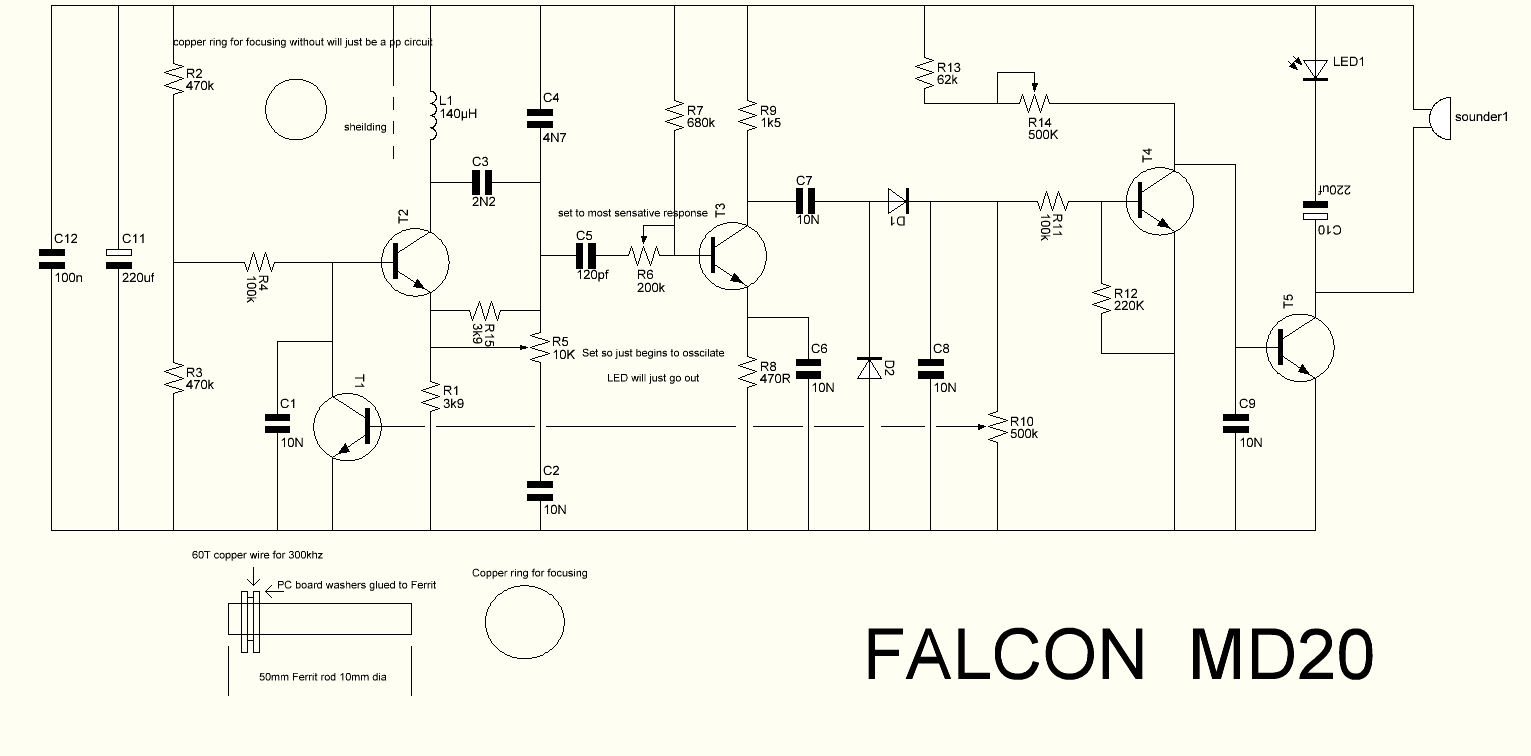

Hello my neighbor.Your schematic has a few differences to the one posted here. When I re-checked the board here, it is correct. I will put them here so you don't have to search.

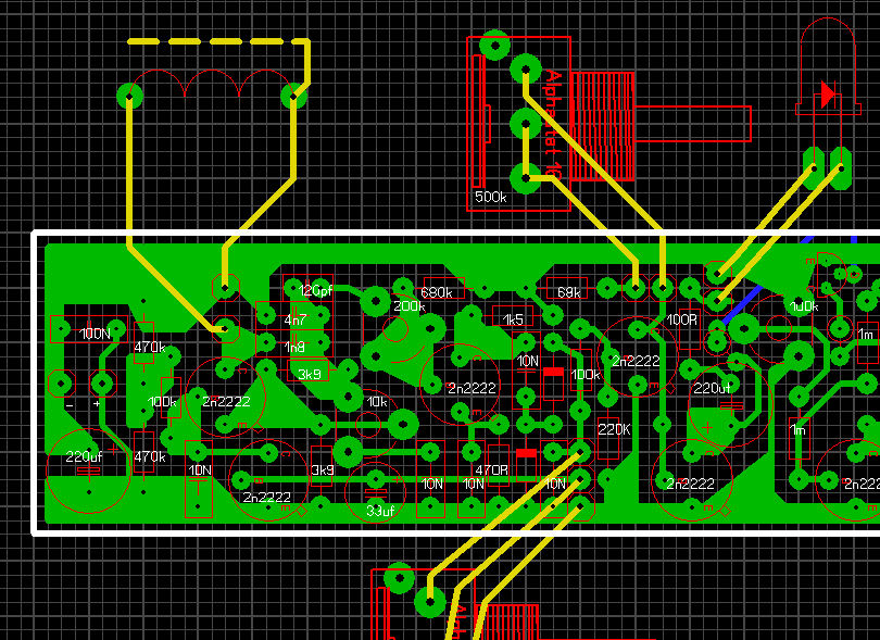

This board LAY file is the one here called LAY1.
ic 555

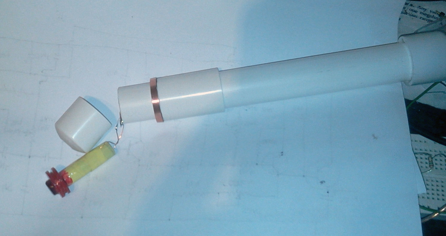

yes it does the 555 is just an oscillator to drive the speaker it replaces the sounder i am currently working on a vco as i think it will improve the sensitivity by altering amplitude as well as frequency of the sound at the moment its basically on or off switched by the final transistor, but as it stands it works just like the commercial unit will pick up a 3mm piece of component wire at 5mm easy the copper ring is the key and its placement in relation to the ferrite rod and the the coil shape, it doubles or triples the sensitivity of the unit.
i have also found the shielding to be important it must be a broken circle if it forms a ring will desensitize the unit as i have found through experimenting the same as a conventional metal detector coil. i am playing with conductive graphite on the end cap to act as a shield.

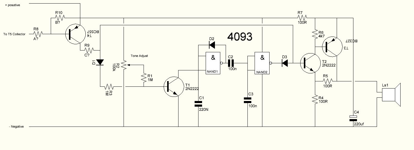

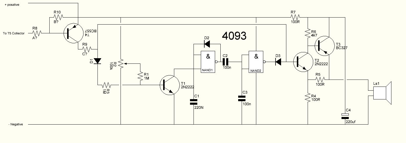

I have almost finished the VCO section works great but not getting enough tonal change for my liking I have to play with some part values still.
This is the VCO looking for A,B and C Values A is 1meg and works fine image4 is wrong BC327 is upside down cant remove it.Attached Files
Dang Tim. Sorry to be hearing that. You can do fine without a pancreas. Can't they remove it or has it moved around ? It's Never over until the Fat lady sings, Right ?
Dom, Novel Idea on the VCO. What Diode was you thinking there. I see a zener being used in other Nand Gate VCO's. Don't understand how they work.
