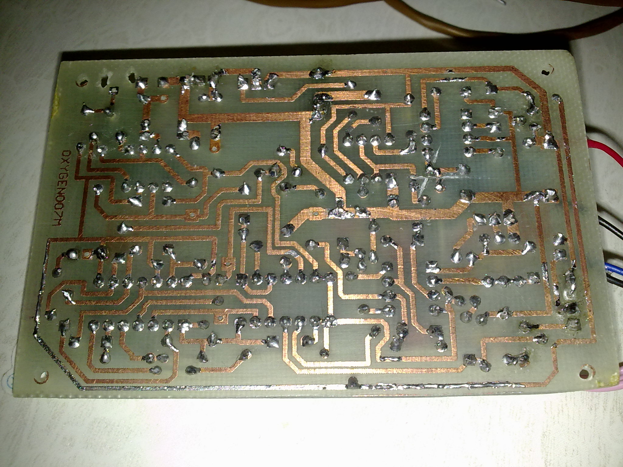

        silverdog, can you see any problem in my board? if you see please let me know.

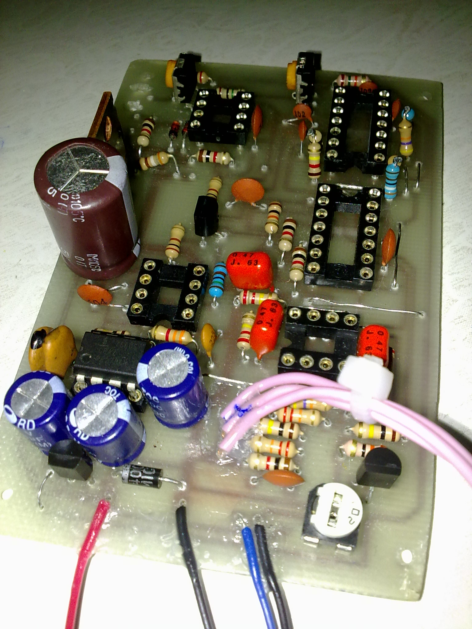

              surf pi board
              not easy to see, funny looking C7 ?
              If you have 5v at 7660 pin8 then ok upto that point
              If 7660 ok, then gnd on pin3 ok ? C7, C14,C15 ok ?
              where are you maybe someone near can help ?

                Hi silverdog
                thanks but how i can know that gnd on pin3 is ok?!
                C14,C15 are 220uf 25v and C7 is 470nf - C17 is two 120pf in parallel that gave me about 240pf, yes it is a few funny but i cant find 220pf !!!

                  • #54
                    Silver
                    you can test gnd on pin 3 using your voltmeter in continuity setting
                    http://www.firehow.com/200912125665/...a-circuit.html
                    one lead on any gnd part of pcb, maybe battery negative, the other onto pin3, you should get a sound or display will show zero
                    You should use your schematic and test each connection

                        If you end up placing a parts order you might think of just replacing all the ceramic caps with mylar film ones. Much more stable over temperature and preferred. Where are you located that you can't order parts easily?
                        I thought from earlier posts that the 7660 was working as you had like 11V in and -9V out back then (thought 5V regulator was bad).

                                Another thing, looking through forum entries regarding your board there was a problem with suggested orientation of a transistor - I think it was Q6. Did you get that right?
