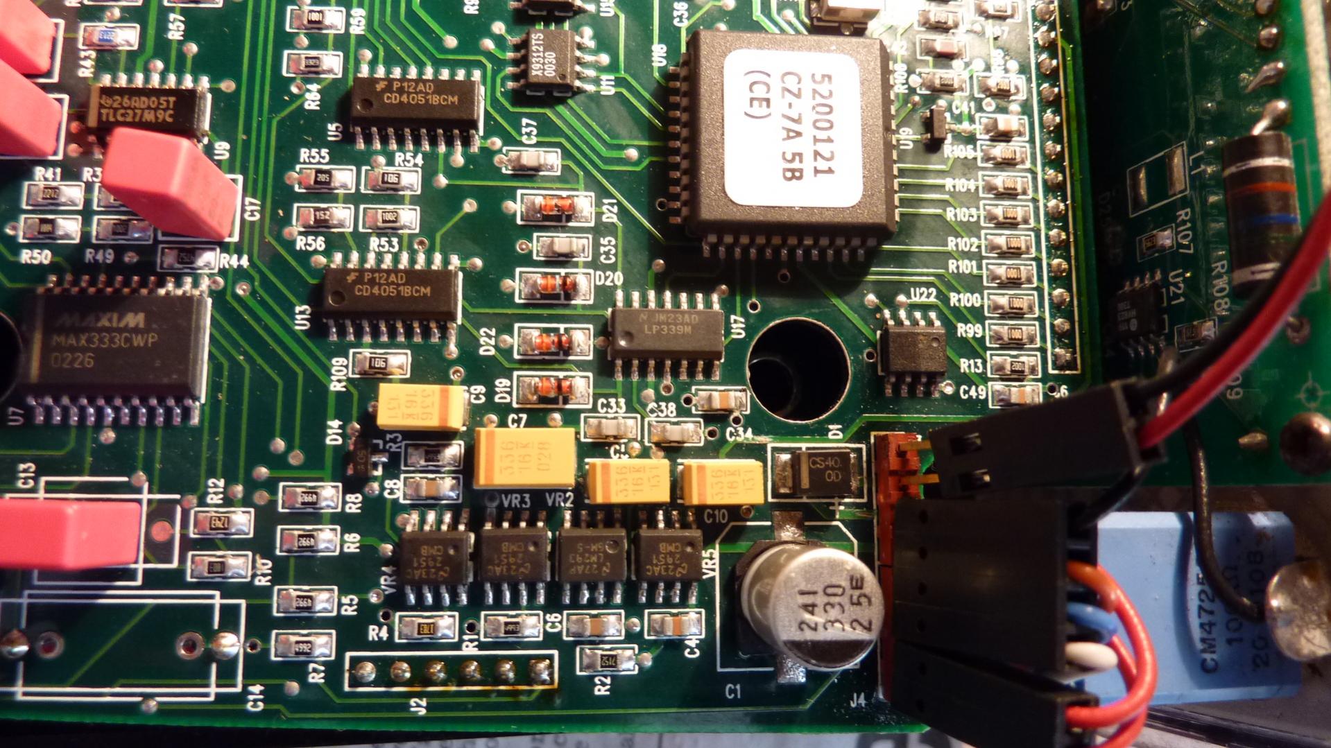

    On the subject of my other faulty Fisher Cz70, I have now established that the CZ6, CZ7, CZ7 pro and CZ70 pro all share the same twin surfaced mounted pcbs.
    I have a power supply problem where no voltage is being fed to the circuits and where you would think it should be easy enough to troubleshoot, but the fact is without a schematic, trying to trace the thin tracks on both layers and under the huge array of ics is not easy task.
    I believe someone has connected the two pin power connector (J3 18v) the wrong way round as it fits in both ways unfortunately. So, with two good 9v batteries, the 18v supply is present between battery minus and both the cathode and anode of D1 -which is a type CS400D and cannot find any data on it, but it tests ok out of circuit.
    Do you know what kind of diode is this? Also, I get no voltage reading across main electrolytic C1 so it looks like this is the area where the problem may lie??
    I have never worked on one of these circuits before and surface mounted components are a nightmare to source, never mind removing and replacing them without the correct tooling.
    I do need to establish what exactlly is D1 before I can continue the tedious task of tracing the supply link and other lesser feed voltages to the different stages.

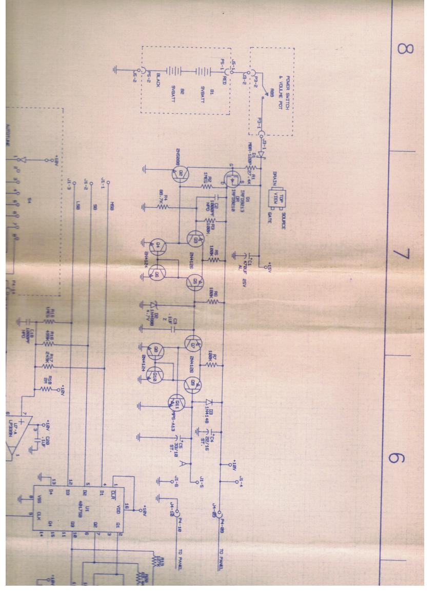

      Hello . It is actually a discontinued VPO104n3 P-channel FET . So NTE326 should work . Look at the pdf data folder and also a nice clear schematic from this forum already !! Other opinions are welcome .

        Tony, See post #11 in this thread.
        http://www.geotech1.com/forums/showt...&highlight=cz5
        The attached schematic is a CZ5 power supply. As I recall the CZ70 base circuit was similar to a cz5, but with a LCD display.
        For the diode use any schottky rated at 20v or greater, 1 amp.
        Regards Mark

              Tony,
              Can you post a photo of the power supply section of the pcb?

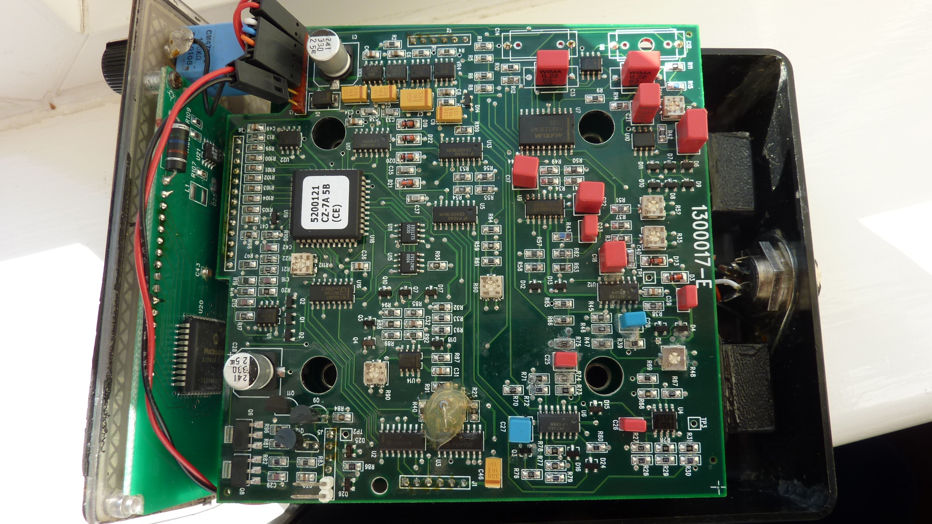

                Fisher CZ5/CZ7
                Hi Mark,
                I am enclosing a couple of shots of the power supply and main board.
                In the past when I had to contact Fisher US about anything to do with technical
                stuff relating to any of their detectors, I was always referred to a UK approved
                repair shop which I do not trust and are very expensive, specially with anything
                like the complexity of these CZs.
                I will try them again though but I do not hold my breath.
                Anyway, let me know if you can spot anything there. I can see there is an 8 pin LM293
                ic. which is of course a voltage regulator but like I said before, nothing is feeding it
                at the moment.
                Tony
                  Nice photos, you are right that power supply is different than the analog CZ's.
                  From what I can see there are 3 LM2951's. These are adjustable voltage regulators.
                  Maybe one of them is for the display circuit +5v? The other 2 for the analog circuits?
                  The LM293 could be a low battery detect or virtual ground (see 1280X schematic)
                  Last edited by Altra; 05-10-2011, 07:26 PM. Reason: Lm2951 discontinued search "LP2951"
                    I missed it earlier. It looks like water or battery juice leaked on the board. I would clean that before doing anything else. If you did not notice look around U12, LM339?, C20 etc. on your first photo. You can use alcohol and gently clean the area. Use a pin or exacto knife and scape the corrosion off. There could be a short in that area which is killing your power supply.
