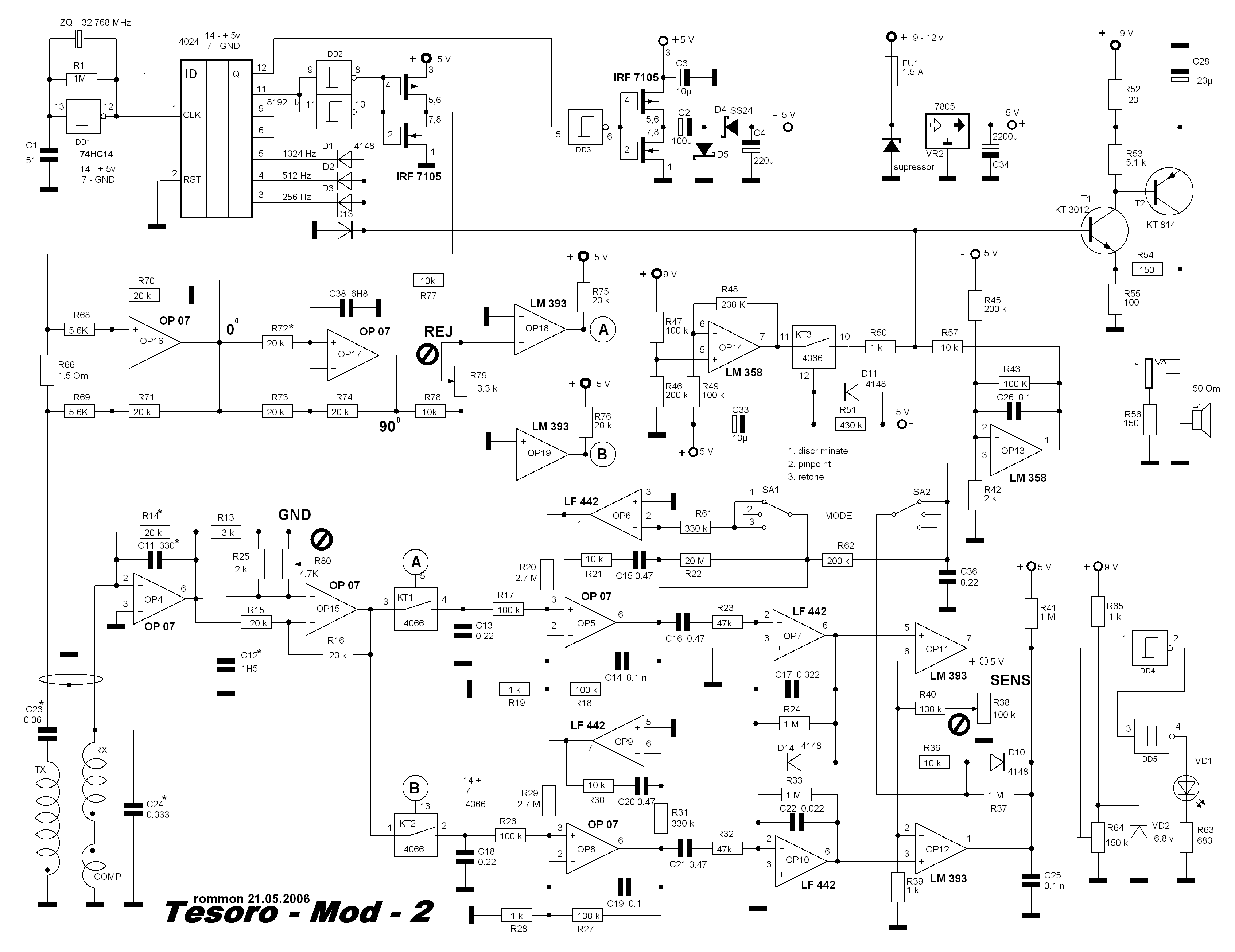

    A collection of circuits
    http://phazitron.narod.ru/archiv/schmd.htm
    Tesoro's modification. it was offered by ROMMON in 2006 year. for a collection.
      Which Tesoro model is the modification for???
      KT315,
      Which Tesoro model is the modification designed for? Thanks....
        Yes, is there a way to know what is a mod vs. what is original?

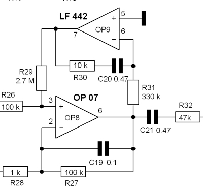

        Also, I'm interested if anyone can explain the purpose of the following circuit configuration, with two op amps in a feedback loop. What is the design advantage of it?

          this circuit makes continuous opamp output near to zero or zero , slow integrator, auto zero,auto bias,

            this is SAT. or S.A.T. or Self Adjusting Threshold. please google 'By Mark Rowan & William Lahr - How Metal Detectors Work'

            There are a few potential points of confusion here. Some metal detectors are equipped with a feature called "Self Adjusting Threshold", or S.A.T., which gradually increases or decreases the audio output in an attempt to maintain a quiet but audible "threshold" sound. This helps to smooth out audio changes caused by the ground or inadequate ground balance. S.A.T. may be very rapid or very slow depending on the metal detector and how it's adjusted, but strictly speaking, S.A.T. implies a motion mode of operation. This is why you will hear certain metal detectors referred to as having a "True Non Motion" mode; meaning, of course, an All Metal mode without S.A.T. Another sometimes confusing thing is that some discriminators allow for adjustment down to the point that the discriminator responds to all metals -- in other words, it's a discriminator that doesn't discriminate. This is something very different, however, than the All Metal mode previously described. For this reason we often refer to it as a "Zero Disc" mode.

              A nice collection. Can anyone from Geotech comment on how these schematics compare with the ones we have already on Geotech? Any new ones in this collection not on Geotech? Any differences between ones on Geotech and ones in this collection?
              Obviously I'm looking at the Golden Sabre Plus, and seeing some interesting things, like the ICL7660 voltage converter instead of the CD4024 counter in the TGS.
              -SB
                Silver Sabre Plus circuit very similar to TGSL with some nice variations to consider.
                Something interesting going on with the DISC, GB sync pulse generators. Audio circuit of course of interest.

                  Originally posted by Melbeta View Post
                  KT315,
                  dear Melbeta, some sarcasm was there... in reality it is yet not mod for a tesoro... but new device. some people in russia has very low level in english and silent like a polar russian bear with me in the forum. I have to give the schematics from another side too... if they are so silent. and if ivconic will give me some respect...
                  have a nice Day there
                    Thanks for explaining it to me....
                    Thanks for explaining it to me, you have an nice day yourself.
                    Melbeta

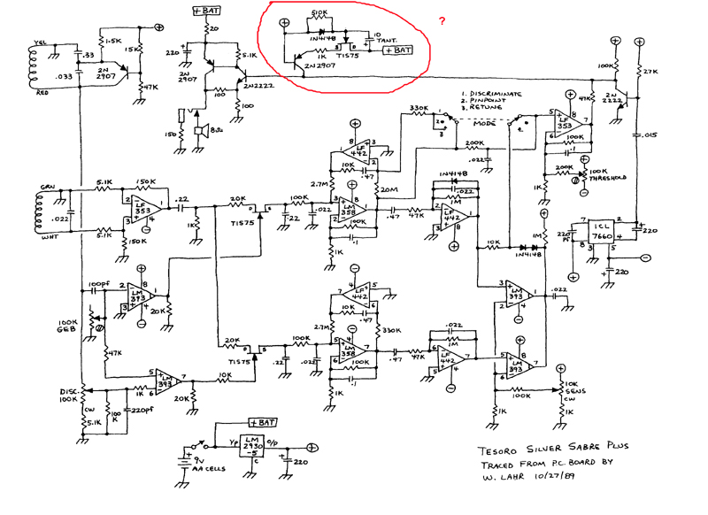

                        Silver Sabre Plus audio V+ question
                        Can anyone explain the audio transistor power supply section (see circled in red) in the Silver Sabre Plus schematic?
                        (maybe beeps when battery low?)
                        -SB
                          This is battery check.
                            Note that when we turn detector on, the tantal capacitor starts to charge with timeconstant 510k*10u=5 seconds.
                              Thanks, I should have recognized that!
