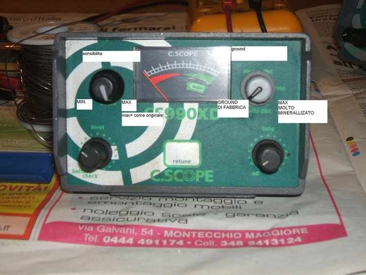

                  I know very well c.scope 990xd-990b-1220b, I have repaired many, I use in my research on ww1 990xd with a change in ground and adjust the sensitivity, the change improves performance
                    Would you be able to give us the details of the changes you made to your 990XD?
                    Kind Regards
                    Jim.
                      as soon as possible I want to explain my edit
                      Devis from nord italy

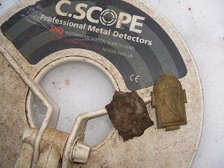

                              Kappenabzeichen world war 1
