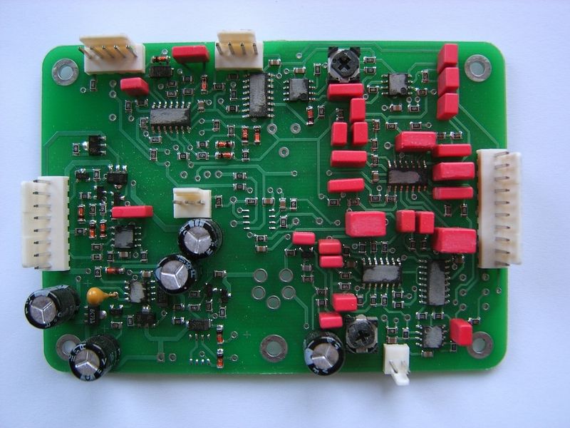

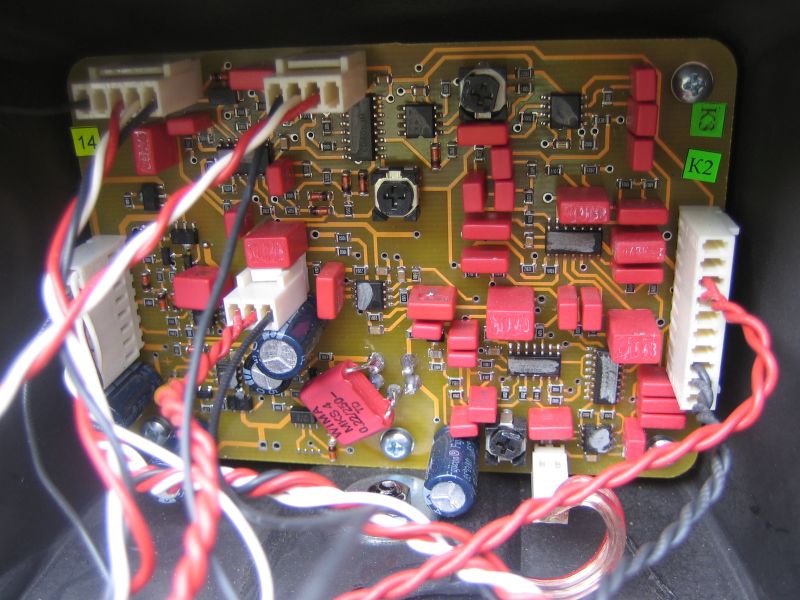

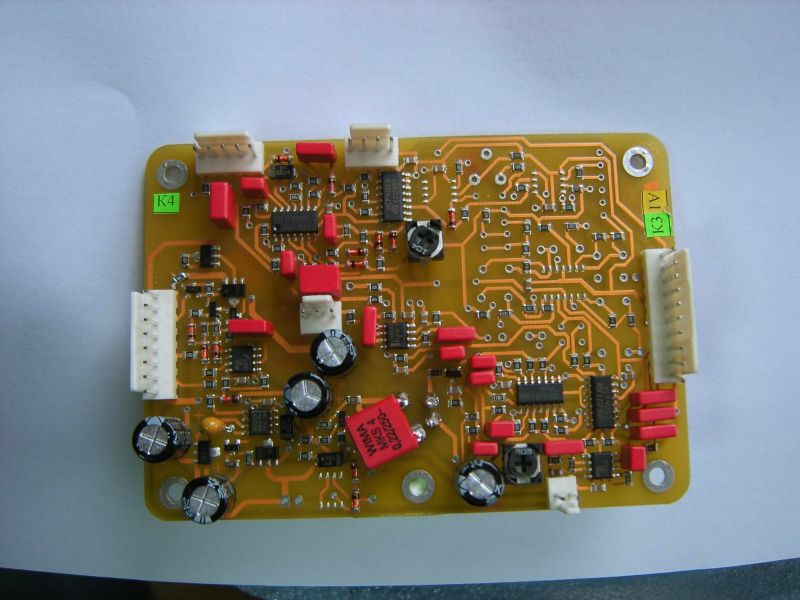

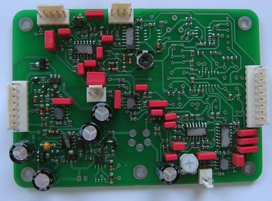

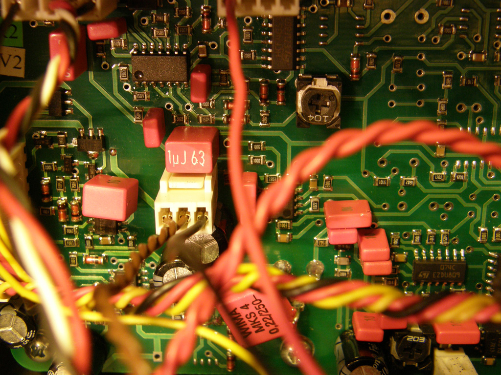

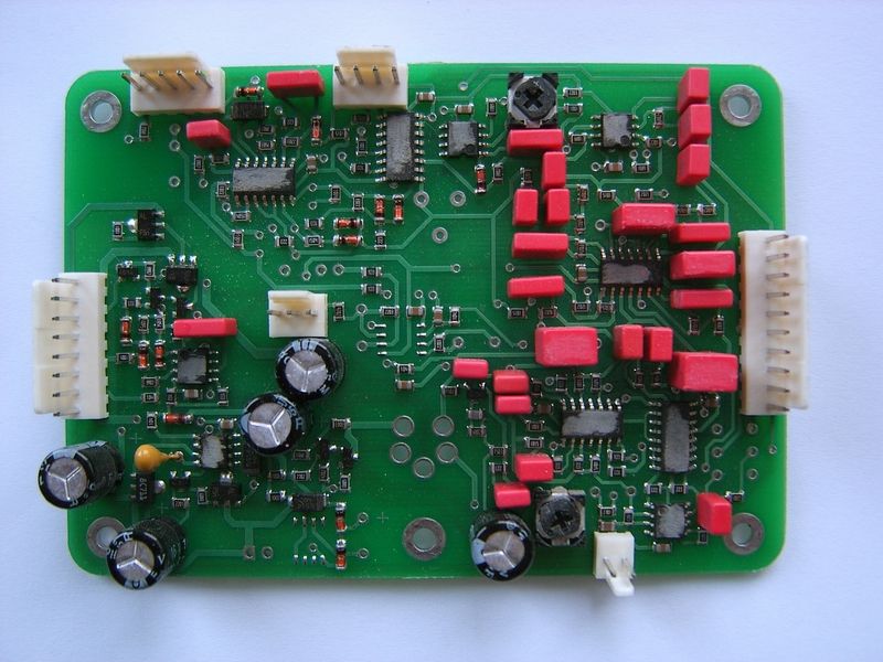

                Here are some images of PCB with the Bulgarian Forum
                  Thank-You Maikl for posting pcb photos . Of course IC chips are sanded off !!
                  Ivconic correct , probably is TGSL . I am trying to find Bulgarian forum now .
                  Best Regards............Eugene
                    This version maybe not.
                    Looking at RX stage i recognize Fisher's like.
                    This is probably derivate between several schematics.
                    Could be something similar to SMW but more complex.

                        I made wrong presumption here!
                        More i look on photos - more i think is Magnum variation!
                        Maybe 2 channel Magnum?
                        In that case, Amtech, such quotes could be right.
                        Oscillator indeed can be pushed to high power.
                        So... Magnum or other name - Wave!
                        But also looks more improved.
