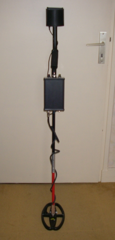

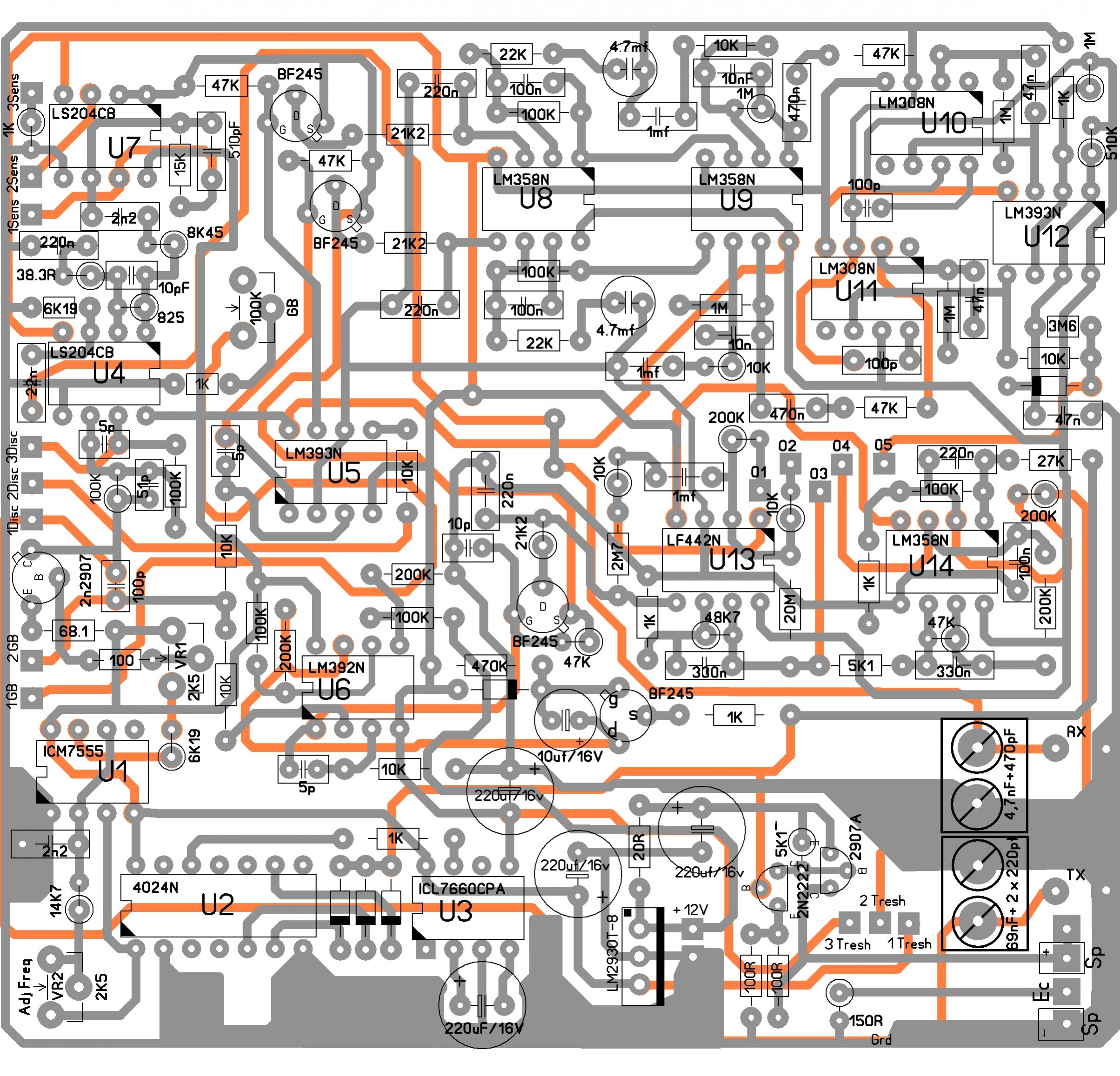

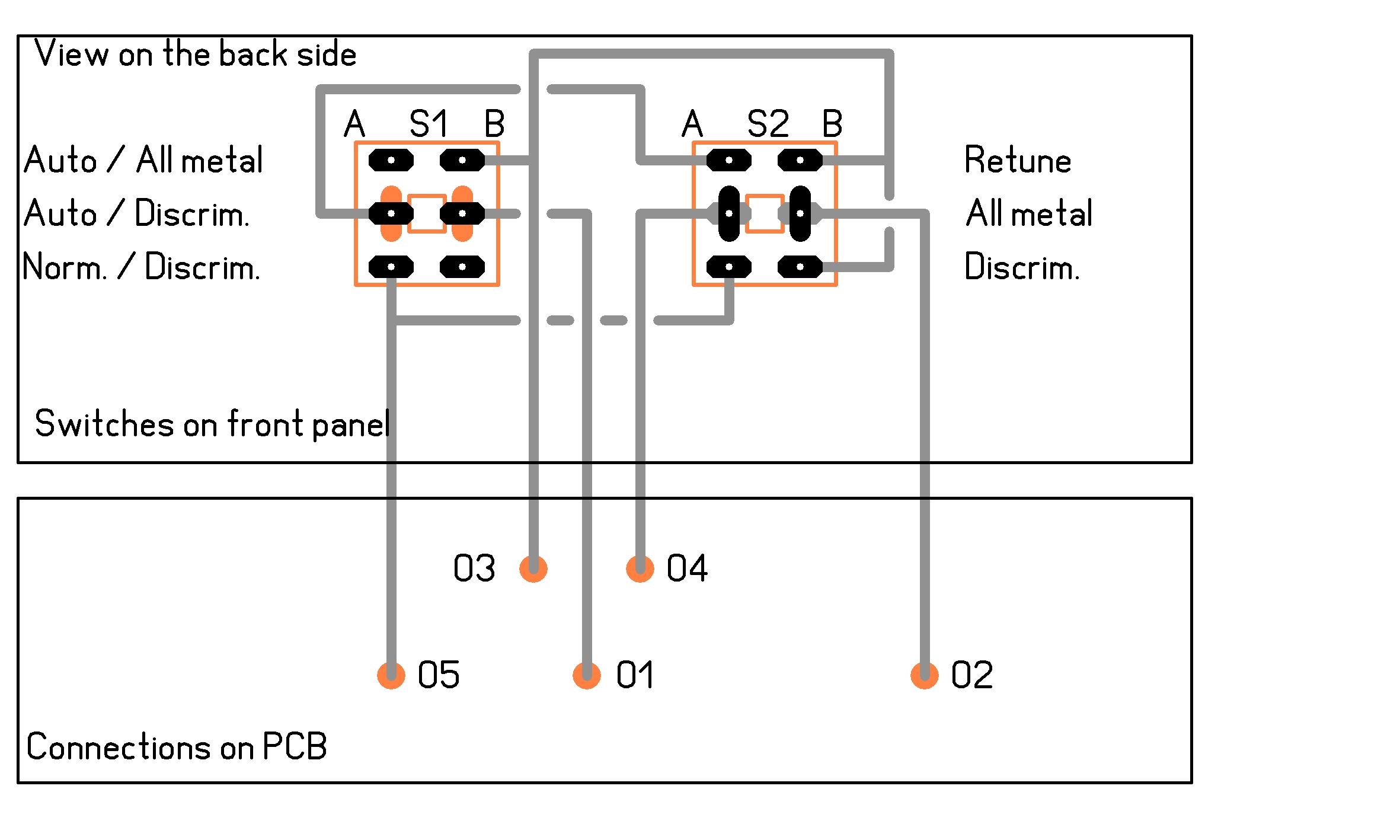

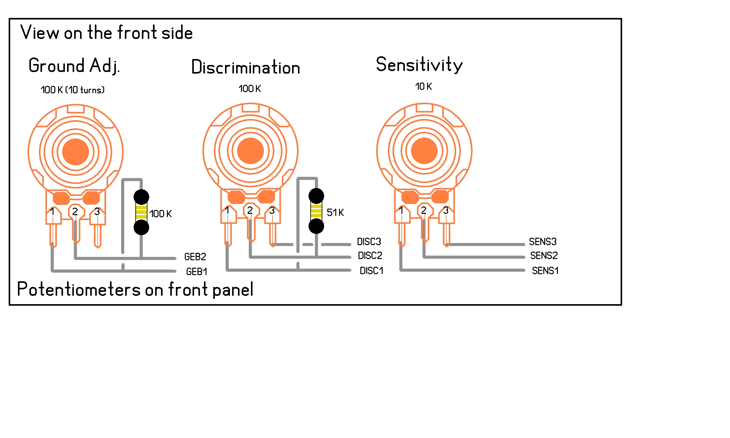

            • My LuBa is working
              Hello all
              My first try was not so bad, I will you give all informations concerning this.

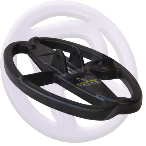

              I us one NEL DD Coil Sharpshooter 5.5” x 9.5”
              Values:
              TX: 3.2 Ohms 0.92mH
              RX: 71.1 Ohms 15.52mH
              Please find the PCB values and also connections switches and pots.
              • Very beautiful pictures. A lot of work. Can all this (together with the "LAY") file placed in one file ("RAR")? Would have been fully completed project. Thank you.
                • Originally posted by smity View Post
                  Hello my fried, I do it, good luck.
                  All the best
                  • Hi all
                    I put the coils in a carrier fiberglass cast that I have.
                    For now, I have not yet filled with resin polyrethane
                    With the disc still, I always have very good result but when I swing on the coinage, it does not ring.
                    For proper operation, I increase the value of GB resistance but I lost 5 to 8 centimeters.
                    Prédica2, I did the tests you suggested but there is no obvious improvement. Discrimination is OK with R10> 180 but with cap on RX for my 2N7
                    Best regards...

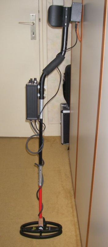

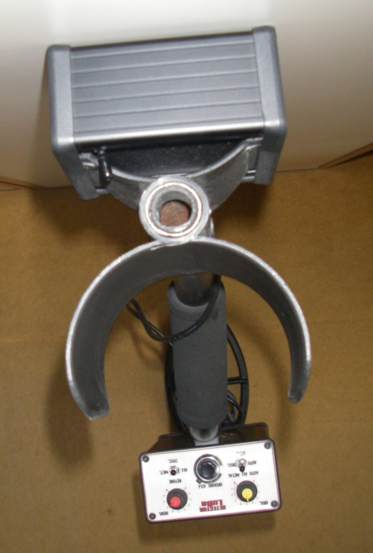

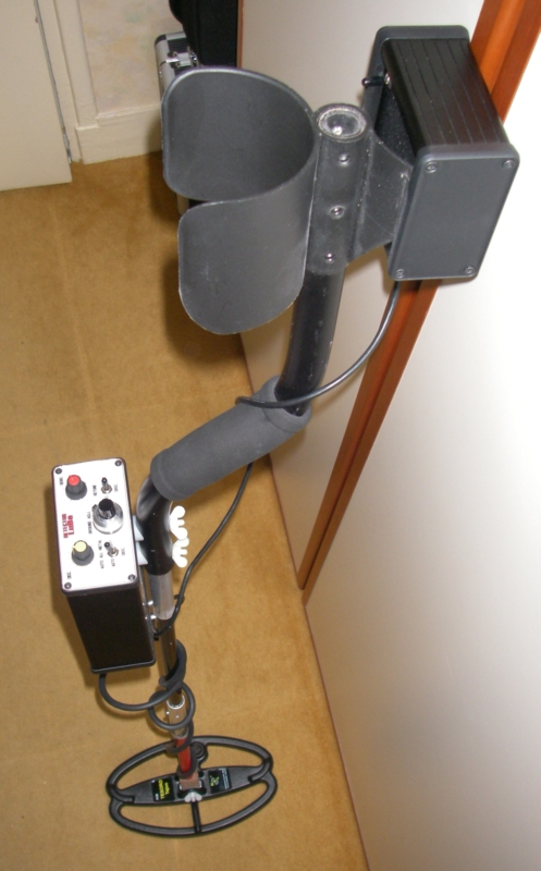

                    • Hello all
                      Some pictures of my work.
                      • Legaucho, you made quite a nice detector there.
                        Could you do little test with a gold nugget and post results here ?
                        Thanks in advance.
                        Regards Marko.
