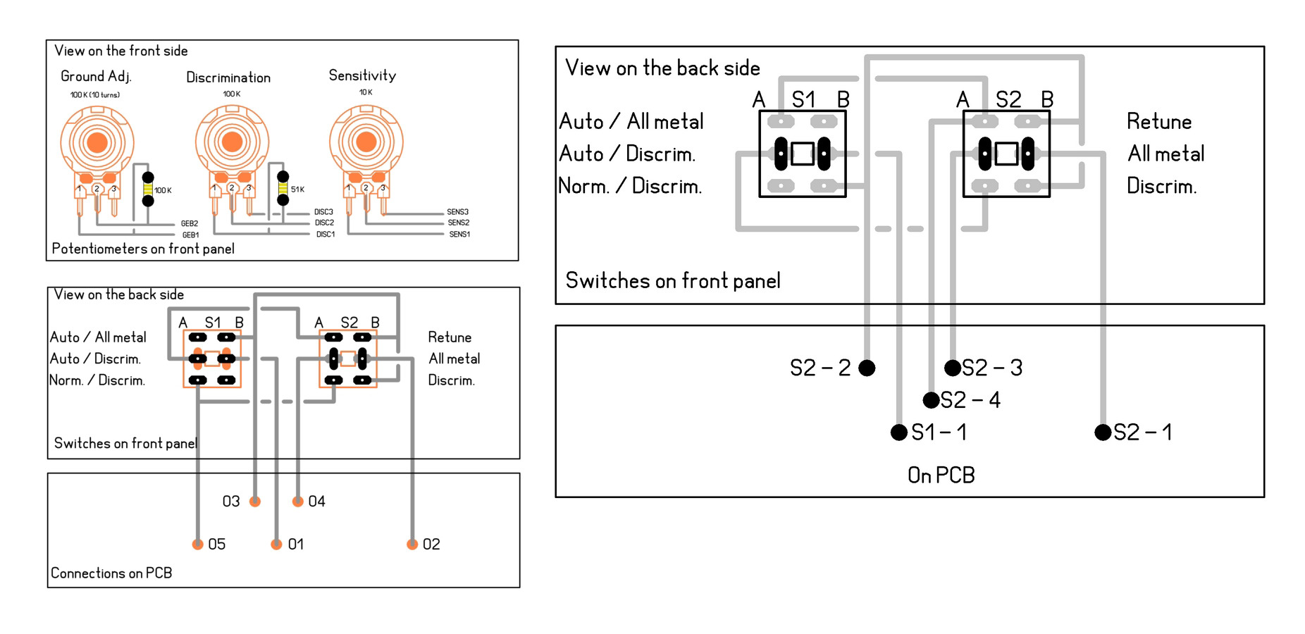

      • What is correct tri-state switchs connect?
        Version 1 left or version 2 right?
        • All wire connecting same absolutely
          Only text label turn up-down
          How to choose?

            • Originally posted by Derx View Post
              Hi
              Please see my post 103 on this topic page 7, the version is left one corresponding with my PCB connections ( 01 - 02 - 03 -04- 05 ).

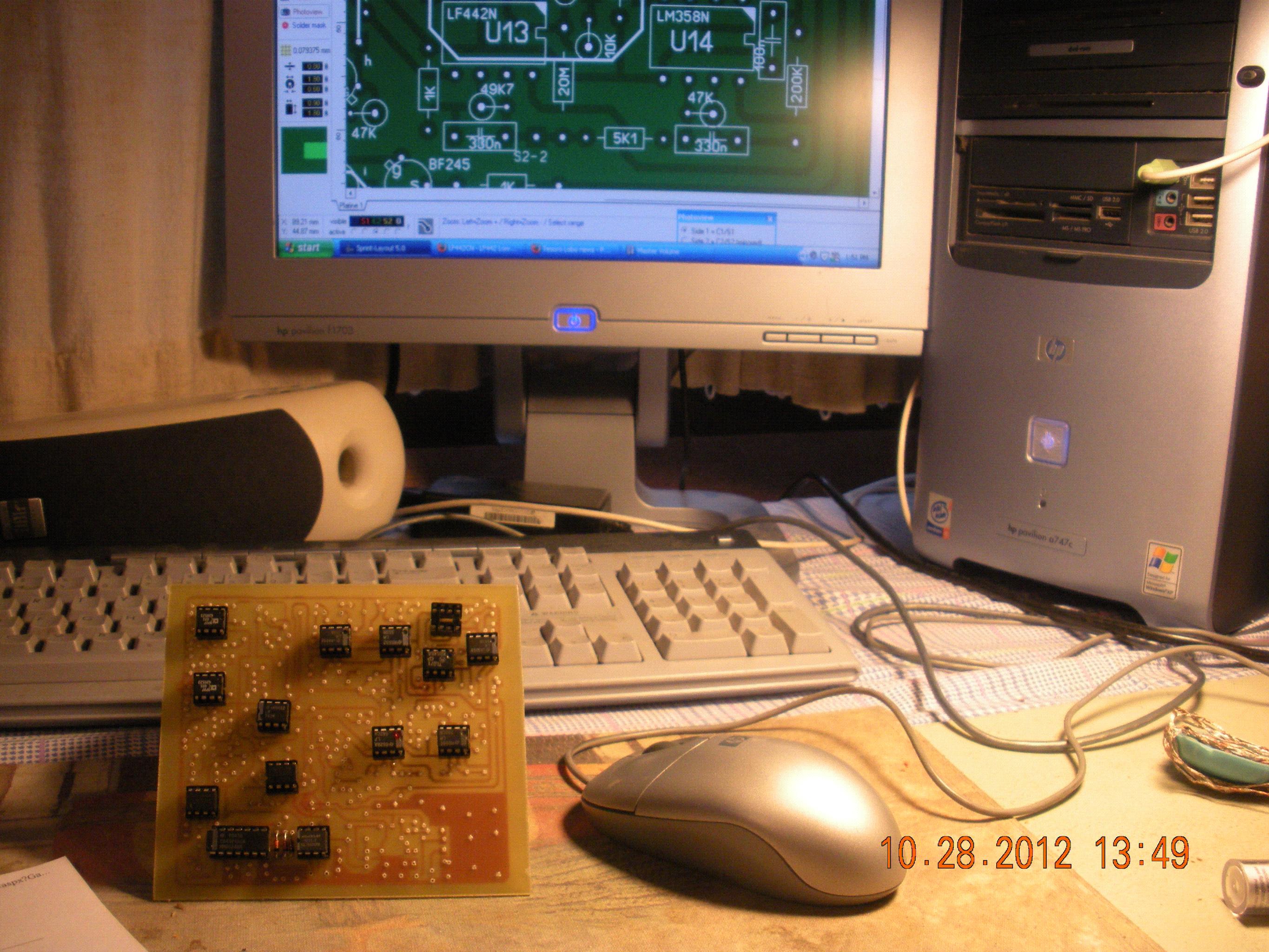

                  • I finally got started on the Lobo Project, its a miracle !! Just need to find a substitute for LM358. The next step is to solder the caps and resistors .
                    One thing I learned the hard way so far is "always make circuit boards with silkscreen for super fast parts placement !! I now use sprint layout with "x-ray view" image to help place the parts .
                    Regards..............Eugene

                    • Cool Beans! Looking Good.
                      Why Sub the LM358?
                      • I have everything else but the LM358 !! Just wanted to get some opinions on a perfect substitution .
                        It should turn out good , I am checking the schematic as I go and making a new parts list .

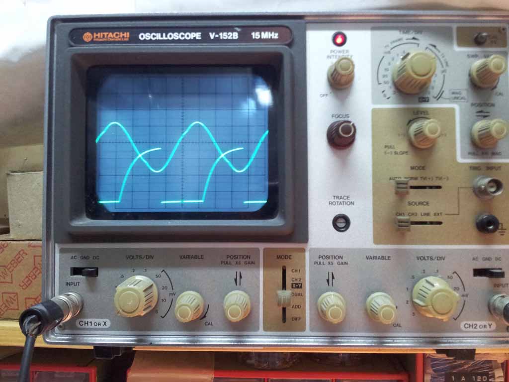

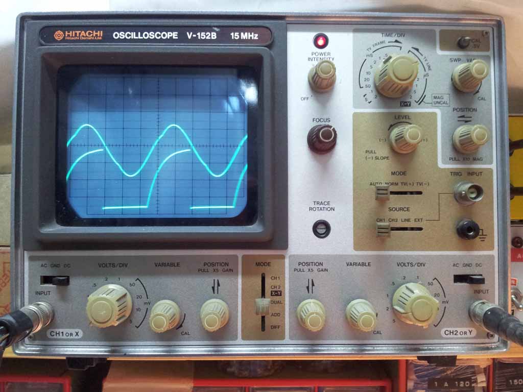

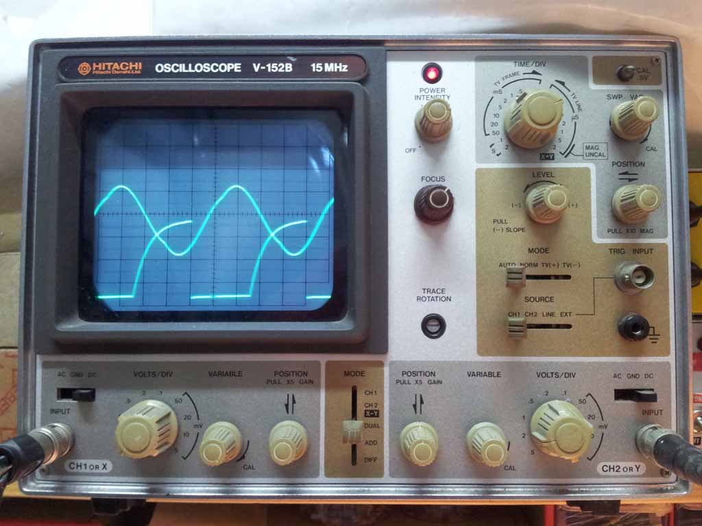

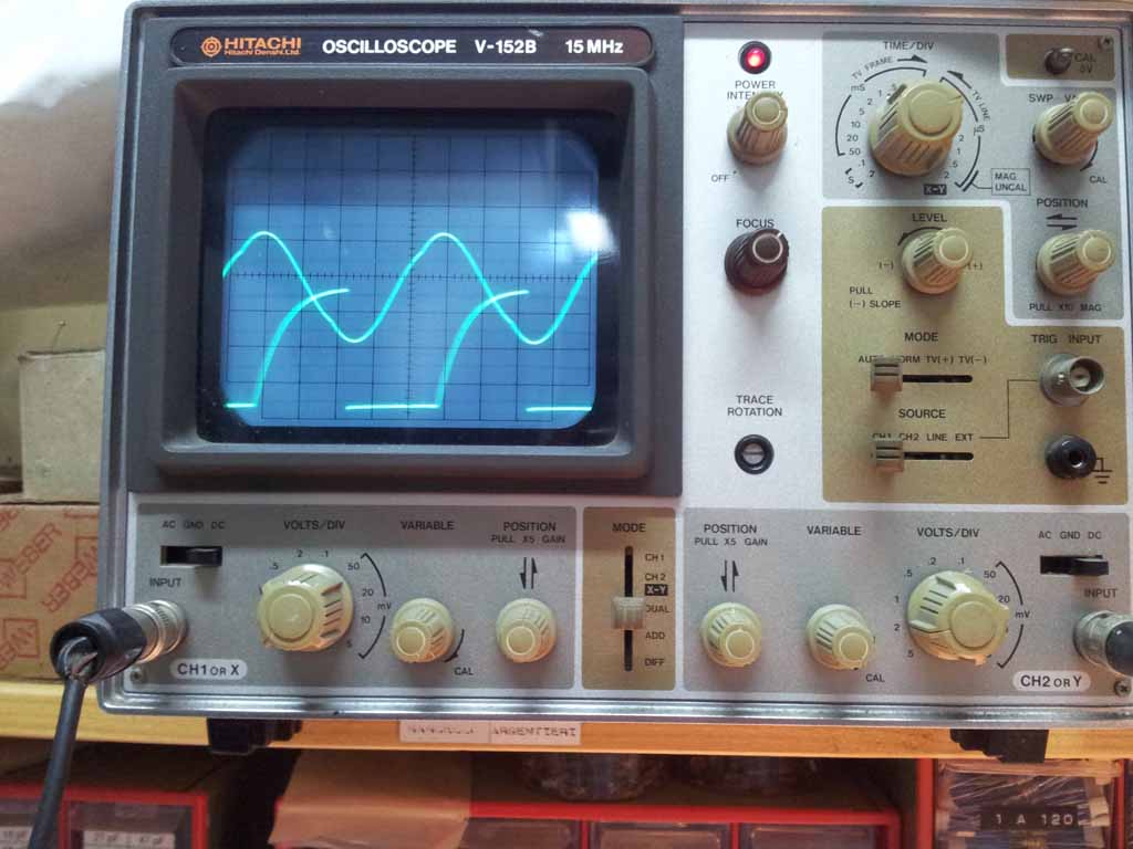

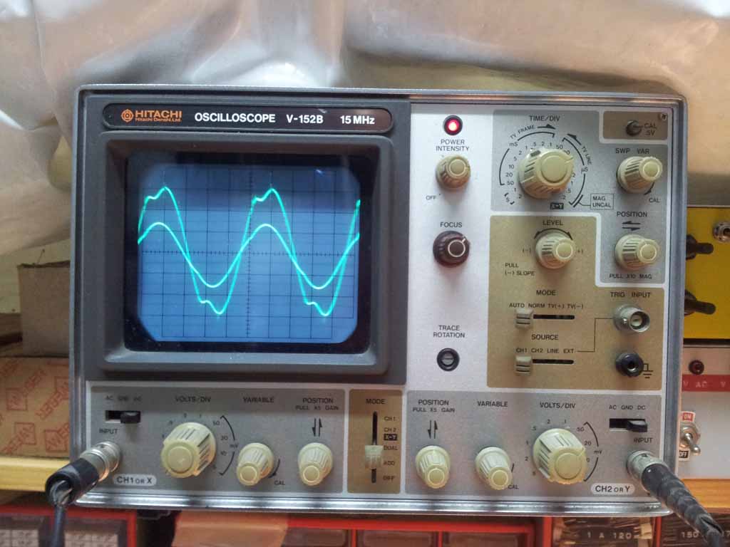

                            • I made the Tesoro lobo.
                              For testing I connected the search head of 9x8 silver umax.
                              for the moment it detects 1 euro to 15cm.
                              GB works well.
                              Disc does not work well.
                              I'm working on.
                              Pin1 U7A
                              Pin1 U6A GBmin
Name:	Pin1 U6A GBmin.jpg
                              Pin1 U6A GBmax
Name:	Pin1 U6A GBmax.jpg
                              Pin7 U5B DISCmax
Name:	Pin7 U5B DISCmax.jpg
                              Pin7 U5B DISCmin
Name:	Pin7 U5B DISCmin.jpg
                              • Why don't you tell us where the other test point is connected? You have only listed one connection for each of your photos but we can plainly see two scope traces. What is the other test point ?
