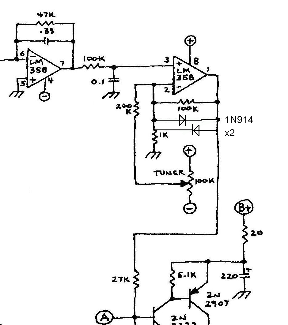

  • Both TLC27M2 and LF442 suck at 1/f noise. They are precision op amps, and perhaps they would perform better than a lower noise option in a quasi non-motion circuit as they are, but again, maybe not. LF442 is a bit quieter, but I'd try TL072 instead. TLC27M2 has 300nV/sqrt(Hz) at 1Hz and with a gain of 47 it greatly exceeds offset capability of this chip. Hence chatters.

    • Regarding compressor, I'd try this configuration:
        But does that noise 1/f become relevant anywhere in this circuit? Signal from Rx loop is probably 1000 (guess) larger. I.g. 50 mV signal on loop compared to 2 nV 1/f noise.
          That's a great idea! But then that's a clipper - You need to preserve the gain of 100 which it may not have with the diodes as configured. Back to back zeners with a resistor makes more sense imho. But this takes care of the turn on noise, but not the "sensitivity" problem (as far as I can tell).
          • 1/f noise is relevant because with these gains and noise, it appears in mV values already at the output of LF442, and it is a dynamically changing component, same as targets, hence chatters. Air signal is cyclostationary and only AM noise on top of carrier may pass through, and that's why Tx noise performance, and power supply filtering matters. With good induction balance both cyclostationary carrier, and the offending AM noise are diminished, so that's one of two reasons to go for a better IB.
            A compressor with diodes, or a clipper as you noticed, provides log function over the input signal, and it's output is + and - 0.5V or so. Being a part of a non-inverting amp, it is a soft limiter, as the non-inverting amp can have a minimum gain of 1. For small signals it provides full gain of 100.
            I noted that this kind of limiting makes for much softer experience of targets than without a limiter, and the loudness is much closer to our perception of proximity than the raw signal, which is too sharp.
            There is a potential to distribute gain somewhat differently to better use compression, and my drawing is just a suggestion of the possible course. Because of only 0.5V swing my suggestion would not give much loudness. A better way of doing compression would require reducing gain in this stage from 100 to 10, increasing gain of the previous stage more than 10 times and introduce compression there. It works beautifully with IGSL.
