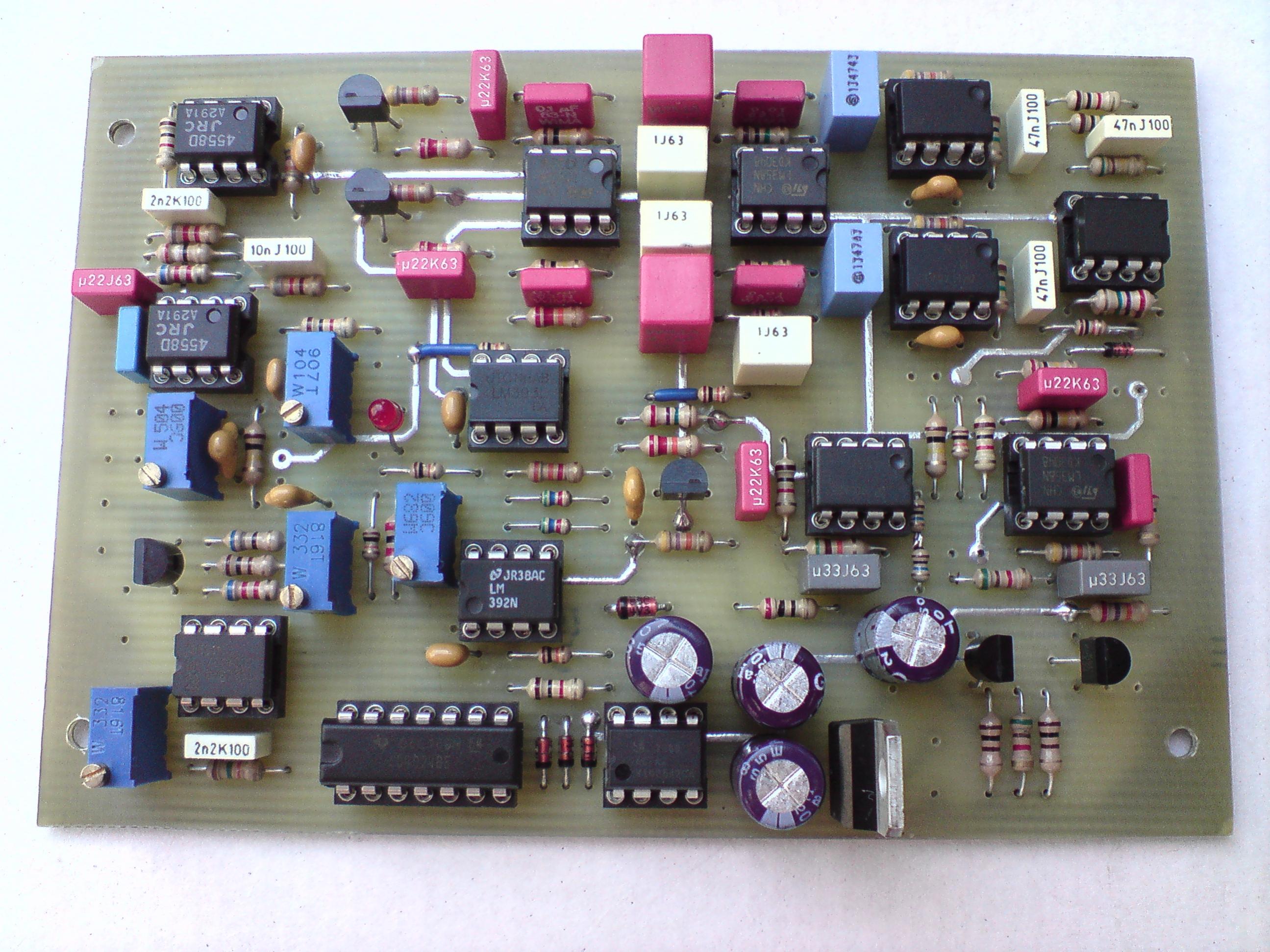

                  Shevakotik: Hello. How is your project? It looks perfect with a two-sided homemade PCB with a very good finish.Congratulations! Tell me: Does It Work? Could you make the coil? Tell us a little about that. (And maybe you could help us a bit with the Russian language )

                  • Colleagues, help me, please. I built Lobo was a problem - poor sensitivity. Building your detector had available to original Tesoro Lobo. In my unit, I used the original coil Lobo. My detector sees coins (on discrimination) to 5 cm, and the ALL METAL does not work. Even built a coil that sees the coins in my detector, also at a distance of 5 cm. In my Lobo integrated circuits and transistors are the same as in the original - the only thing that is different is I instead of 39.3 ohms 38.3 ohms. How do I increase the sensitivity of the device? What to look for? Thank you for all the answers!
                    • I would add that I have NE555 instead of 7555 but I think it does not matter. Please help me.
                      • 7555 is a CMOS version of a NE555. Because Lobo uses discharge pin 7 to drive a PNP, I don't expect much difference in driving capability between these two, but because it uses pin 3 to make it oscillate, the CMOS version should have superior symmetry. Again, it would not make much influence until you hit the noise floor. At 5cm you don't.
                        I believe your 555 is not tuned well. It provides frequency drive for a coil, and Tx coil is supposed to run near resonance. Most probably you'll need to tweak 555 frequency to hit the Tx resonance. Do you have something to measure amplitude of 20Vpp?
                        I also believe a capacitor parallel to Rx coil should be omitted. It is supposed to improve noise performance, but it provides only a negligible gain with considerable coil loading. If omitted nothing cardinal happens, only the rig becomes less touchy.
                        • I borrowed from a friend oscilloscope (it has two channels but only one probe) so I'll check on that though well I do not know - what points should be checked oscilloscope to properly tune the coil? I also have a question: which is the responsibility potentiometers on the PCB (except treshold). Is the C14 should be 250p or 510p (I noticed that the more sensitive is the 510p). Thanks for any answers!
                          • You can start by tuning your Tx for maximum amplitude. Adjust a scope for 100V on a working input, and tune the frequency on 555 for resonance. To do that adjust VR1 for some small amplitude on Tx coil connection (with coil connected, of course), and find a maximum amplitude with VR2. You might need to reduce amplitude with VR1 again when you are close to resonance, Once you find the resonance increase the amplitude till the maximum and a little bit more. You should get about 16Vpp at Tx coil.
                            Then tell us the difference.
                            • Davor Thank you for your response. After many attempts is better. The C7 - 10p treshold has not worked. I changed the 10N and operate. Then swapped C14 (250p) at 560p - that only had (originally in Lobo 510p + / - 5%). But there is a little problem: the limit of audibility is annoying throbbing sound. Can anything be done to make the sound more smooth (as to increase its frequency?). I have to add that I am using oryginelnej coil Tesoro Lobo, on the oscilloscope I have some problems because I have a faulty probe. Discrimination is very poor but it works (R10 - 100K). The NE555 to R4 (15K) added in parallel (trial and error) 47K and so I picked up the frequency. After the change range (maximum sensitivity) is almost the same as in the original Lobo.
                              • Glad to hear that. I noticed some odd capacitor values, but didn't bother much with them as I did not build this rig. I might build a lite version if time allows.
                                Anyway, for the sound quality, play with diodes at U2. You may extract a diode coming from pin 5.
