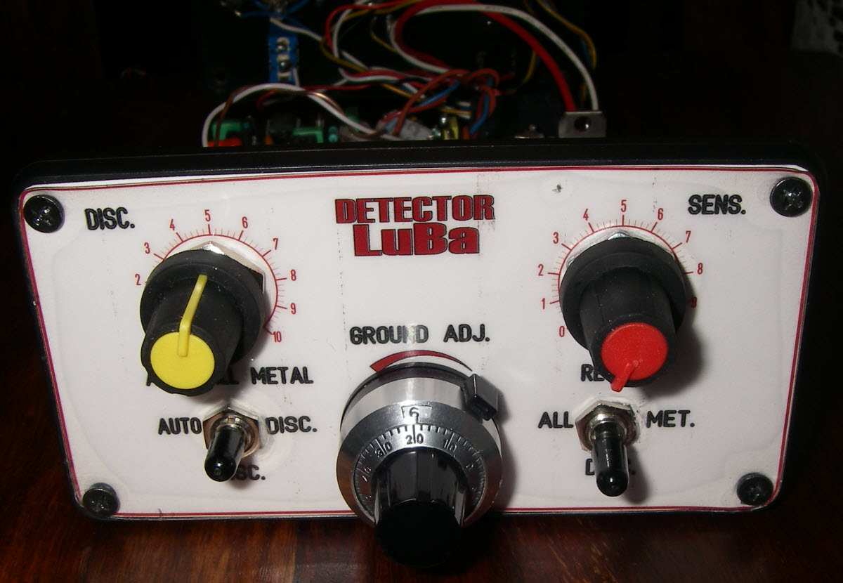

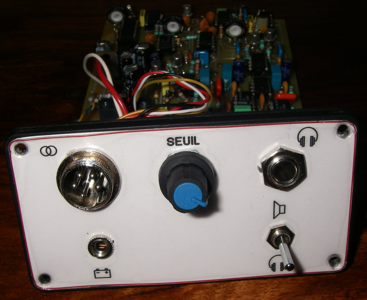

    • Hello all
      Connections on rear plate now..
      • Very very nice!!!!!
        Good work

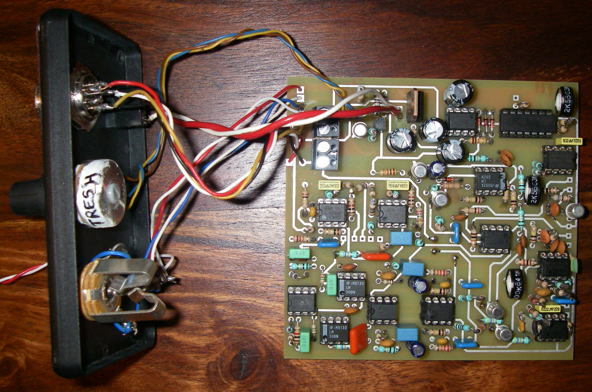

            • Hello all
              Before the last step, all connections ready now.

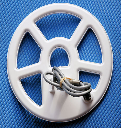

                  • Originally posted by Legaucho View Post
                    I will used one TESORO 9'' X 8''
                    Is that a 20Khz coil?
                    • Originally posted by homefire View Post
                      Hello
                      The caracteristics of the Tesoro 9'x 8' concentric coil:
                      RX = 6.54mH ( 24.9 Ohms )
                      TX = 6.03mH ( 26.1 Ohms )

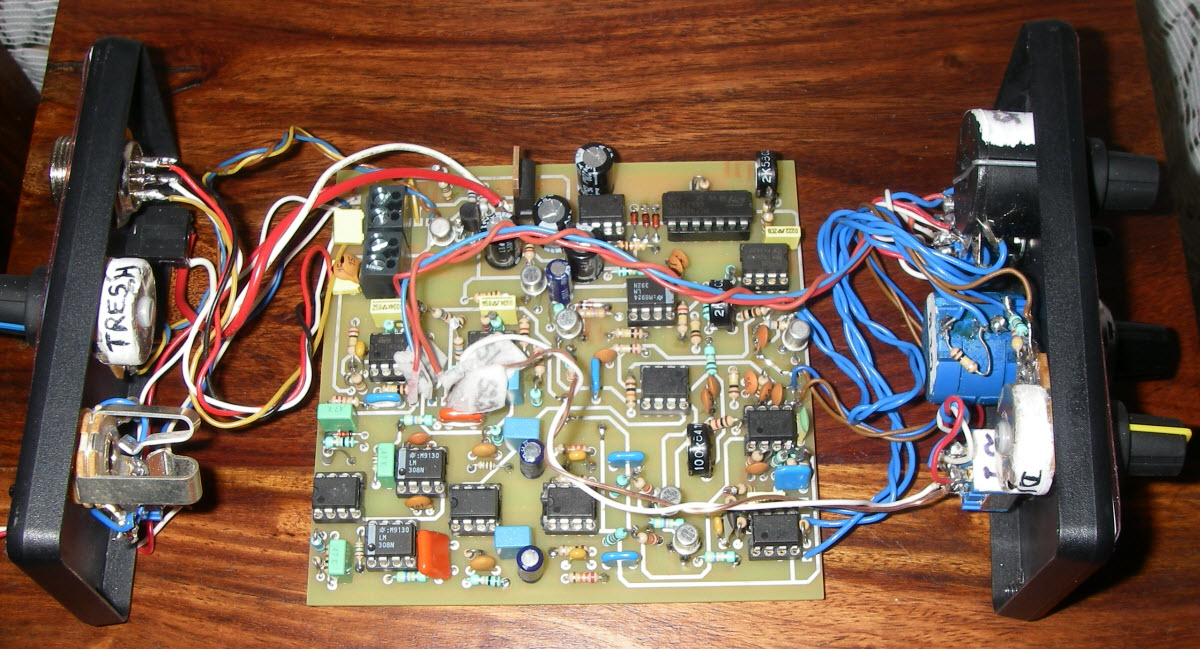

                      Good news, my first try was not not so bad, no mistakes on PCB and all function is running, I must finalize the discrimination, I am currently on :
                      RX stage one 4.7nF capacitor and on TX stage one 15nF capacitor. Can someone help me refine these parameters to obtain the initial 20 kHz of the detector.

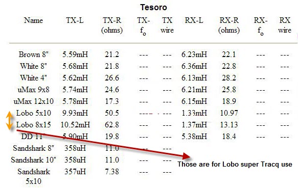

                      • hello
                        the last coil i buy was for cibola, vaquero, lobo supertraq
                        combination of 1mH and 16mH
                        are you sure you have the right coil?
                        you can caculate frequency
                        when you now inductivity and caps for the coils

                            • Legaucho, what do you have in the way of test equipment?
                              You need to choose between either using the factory coil which was designed for a different machine, or the home made coil which may or may not be properly aligned. And we need to know what you have in the way of test equipment before you will get any good advice.
                              Just my opinion.
                              The Fisher coil probably has the wrong connector so shouldn't you forget about that, at least for now?
                              It is relatively easy to figure out how to find a capacitor to tune a TX coil to a particular frequency, but it will be much more difficult to align the receiver phase to the correct angle for your ground and discrimination channels to work correctly. I really hope you have a dual trace oscilloscope.
                              edit: For the 6.03mH tx coil you should use a .01uF capacitor and about 600pF in parallel to tune to 20kHz. If you can, select a .01 that is slightly high and then you won't need a parallel capacitor.
                              edit: With the 6.54mH rx coil I think you should use a 3nF capacitor in parallel. That should give you approximately the same phase as what a 10mH coil (with no parallel capacitor) would.

                                First change the 15nF on the TX to 10nF. This will give you 20.5kHz. which should be close enough. As a "calculated guess", I would also replace the 4n7 cap on the RX with a 10nF. If the residual voltage and phase are incorrect, then try adding a few pF across the RX cap until you get the right values.
                                As porkluvr says, you'll really need a scope to do this properly.
