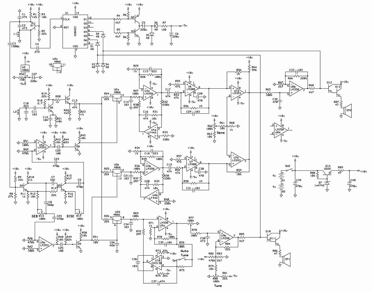

    any info would be greatly appreciated. PCB photos, IC's list etc.

    Here U go.. I do not know the source of the schematic or how accurate it is.

      I have this one as well.
        thank you very much, colleaguis
        I did think there is something specific in power suply... because 4 * 9 V batts... but now see they stay in parallel.

          Yes.. At least the DMCiib can run on only 2 batteries.
            wert9 gives photos of the PCB.

                I've never had the opportunity to use a Nautilus. Looking at the circuit, it appears the disc audio is at a much higher pitch than the all-metal audio. Four times the frequency, two octaves higher? Is this correct? Does this help distinguish the two 'information channels' more easily?

                  Ground reject Discrimination = 950 HZ,
                  Non-Motion Discriminate and Non-Motion Ground Balance = 240 HZ
                  I have not used the DMC11 but probably runs like the DMC11b without tx power boost and coil balance.
                  The unique feature about these detectors is that the all metal channel will be much louder and sound before the disc channel if it's iron or a low conductor.
                  The disc channel will sound louder and about the same time as the all metal channel if it's a high conductor like copper.
                  The two channels have much more information in them when you hear them together.
                  It's just what you need for relic hunting. Too bad Nautilus has not kept up with technology and come out with a SMT circuit and a lighter box!

                          Thanks for the explanation, Don. I've thought about tinkering with one of my machines to add the second audio channel, but now I have seen the Nautilus cct, I have a better idea of what would be needed. Mixed-mode is still a rare feature, I recall that the Rutus Jupiter has it, but there's very little written about that machine yet. Regards.
