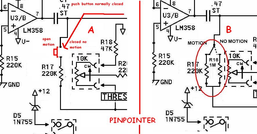

                  This is one project, unlike most of the others I've built, that won't end up in the junk bin. Appears the only thing missing is a pinpointing mod.

                    • I would have had mine finished last week but forgot to order a 4093. The coil measures 2.3 ohms. I've read alot about coils and think that 21 turns might be better. But for the sake of wire I elected to start high and then reduce by a turn. Still experimenting with wire guage. Just tried with 22 awg and not so good results so far.
                      Have you seen the pinpointing mod somebody posted for the surf pi older model? I know very little about electronics but can sometimes follow directions if they're in english.

                        • Have not seen pinpoint mod for surf pi yet... maybe you shoul'd adjust this one first for more depth or something.

                            • I haven't yet altered my first coil. But 1.4 ohms seems to be the desired resistance. And my first was 2.3, I think. I'm attaching the pinpointer mod I was talking about. It came from here but in the surf pi first edition. Once you build your detector then you will see that if you move a coin across it and stop, the sound stops. I have a friend that owns a White's 5000, I believe it to be. His has a pinpointing button on it. Momentary open. Just not sure how to implement it on this version. But I do know someone locally that is pretty good at this stuff. I'll ask him next time I see him about it.
                              As far as video, I live in the backwoods, hill country. The only option for anything close to high speed internet is satelite. It's over priced and still not fast enough to watch videos.
                              What are you going to use for power? I'm using a 9 volt battery at the moment.
