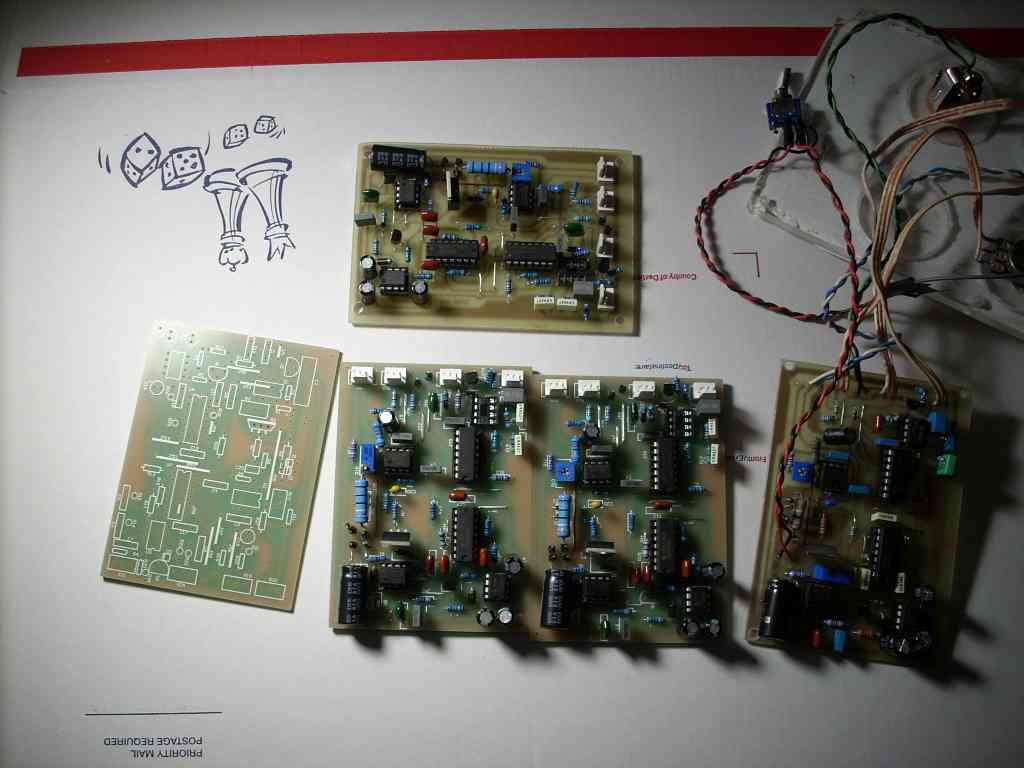

                        • I tried a NE555 and it wouldn't work for me. And with a LM358P I had no sensitivity. Maybe don't scrap your old board just yet. I liked this detector so well I bought lots of parts and built a few boards. IM me if you have a problem sourcing parts.

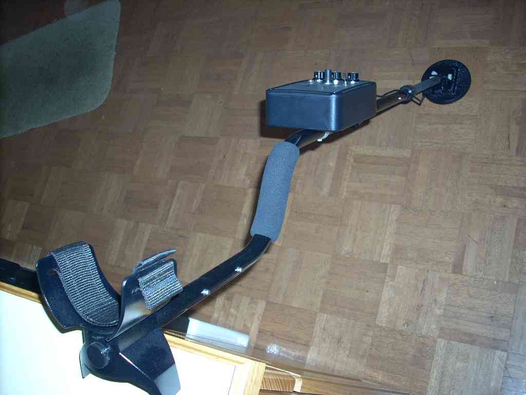

                          • My home-made Surf PI Pro.
                            • This looks like professional job, on boards and all together.
