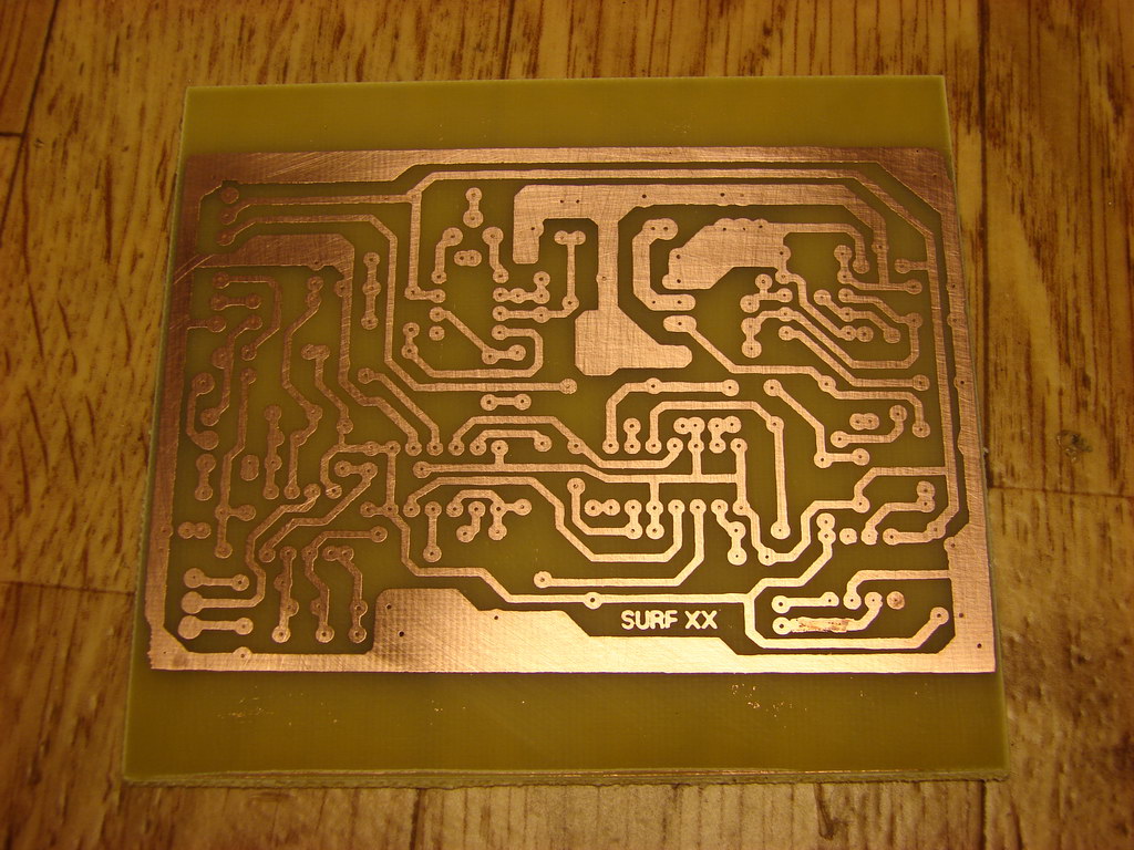

    • Desoldering components from old detector I noticed that offset trimmer 100k is only 87k ... that is one of problems ?
      Can it be used or I must search for new one ?
      Assembled almost everything on new PCB, still need to connect pots and coil.
      • That is within the Tollance of 20%.
        • homefire, thank you, I didn't know that is in tollerance.
          Resistors are mostly 5% tollerance
          • Silence is golden (?) from metal detector band
            Just finished my PCB 2 soldering and started device and nothing... same voltages as should be.
            Must aquire few ICs.
            LM358P is going to recycle bin.
            His friend NE555N also ...
            Rest of them ICs...
            NE5534P
            SMD one (7660) is working fine, giving out -4.0-4.5 V
            HEF4066BP NXP and HEF4093BP NXP
