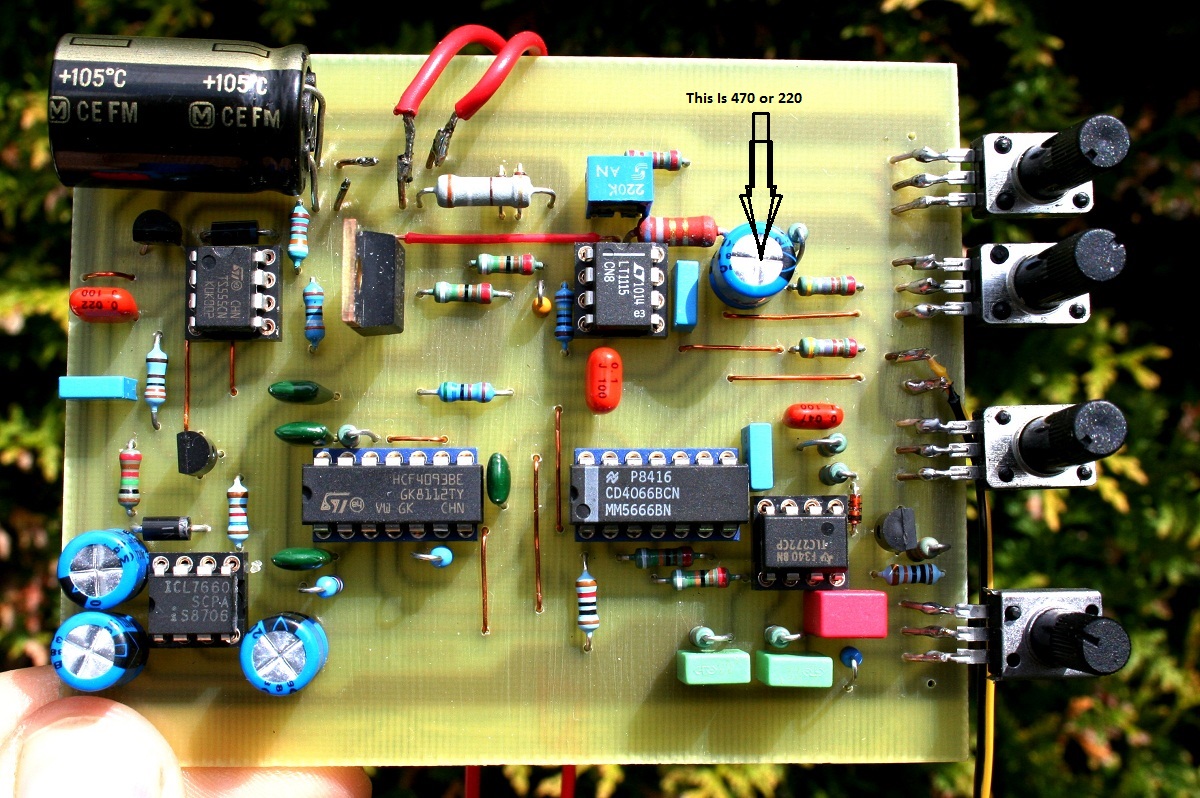

  • Remove all IC's but leave the ICL7660 on the pcb, then check how much current the pcb is taking from the battery ,must be less then 40 mA ,
    and check if you have + 5volt and ca. -4 volt on the IC sockets look at the color bmp
    Tell the results ?
    • paku i think your problem is same like this guy have,check your board again i am sure u have direct connection in board
      check this thread
      http://www.geotech1.com/forums/showthread.php?19503-Little-help-D/page3

        how much current the pcb is taking from the battery ??
        can you tell me what tools i need to test that pcb voltage

          ok will start check now thanks
          • thanks all now my board is working thanks to seadoggy have nice doggy style hahaha

              • the problem is soldering not sticking

                      • but why the Pot tresh , Delay, Sens ,Is Not function just volume and R2 5k pot work only
                        • Can you check orientation of pots should be like in this picture
                          http://www.geotech1.com/forums/attac...1&d=1336742626
                          also check cabling from PCB to pots

                            i have remove all ic and leave ICL7660 i get 7volt on my board
                              In that picture 220uf or 470uf
                              • Originally posted by paku View Post
                                [ATTACH]23813[/ATTACH]
                                on this board is TS555 but on the placement part is TLC555
                                Witch one is true!!!!
                                Sory im confused confused confused confused
                                TLC272 on that board, but on placement schematic! LM358
