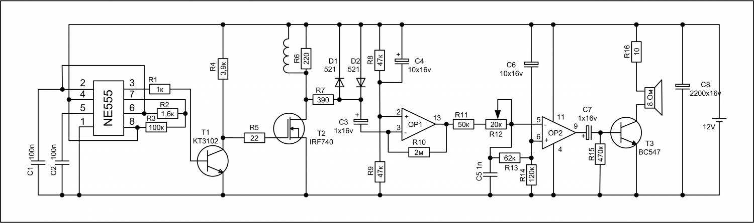

  • Yes, certainly. It will be simple in case of scheme start without this resistor the metal detector to have smaller sensitivity. I assembled here such simple pulse metal detector.Click image for larger version
    In this simple scheme only threshold strengthening is adjusted. I achieved result of sensitivity in 23 centimeters but that took a subject at a bigger depth to us 2 ways are given: to increase energy of an impulse of a rating or to lift cascade strengthening. The first way demands bigger power consumption, - drag the automobile accumulator on the cart, and the second - doesn't demand a big expense.
    I will notice one serious lack of the scheme: to the 3pin of the 555th timer it was necessary to attach one more transistor and already through it to give on a gate 9640. It is so possible to receive more cool impulses at first and I will fall down

      • sdesic, view voltage on pins 4093:10pin , 11pin, 3pin, 4pin. View voltage on icl7660

          • 4093 pins 10,11,3,4 all -4,37V
            7660 pin 5 -4,37 V
            pin 7 5.05 V
            pin 8 4.98 V
            pin 1 0.0 V
            pin 2 2.4 V
            pin 3 0.0 V
            pin 4 -2.17 V
            pin 6 1.22 V
            • congratulations!!! You found one of the misoperation reasons. The matter is that the scheme works if tension differs from face value no more than 0,3 volts. At a voltage of 4,3 volts from out 7660 the scheme works incorrectly. There are two ways further: to **** to itself brains with replacement 7660. Probably from 6-10 chips to you will carry - I tell it by experience of other participants. For some reason best of all work 7660 in soic case.
              But personally I against use 7660 as it has very low frequency of transformation of tension and this low frequency it will be necessary to adjust\syncronize to the frequency of the 555th timer. It is simpler and better to put 79l05
