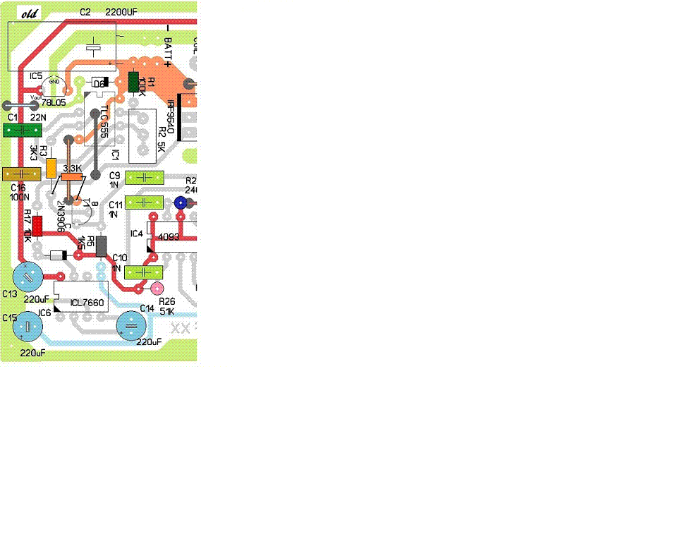

  • I did not realize the update of ApBerg, is a matter of testing.
    What worked for me, is like being in the image below.
    If this mode, the detector does not work well, is likely to be another cause why your detector is not working properly.
    JoseClick image for larger version

    • hi Jose you said this before "I had problems with the Surf PI, already discuss elsewhere in the forum, but I repeat again, to try and help those in trouble. The cause was a malfunction of T1, apparently by the type of 555 that I'm using, producing poor bias of this transistor This transistor (T1), saturated and collector pulses are weak or low amplitude making it run incorrectly the 4093, the pulse delay, appears immediately after the pulse TX, (no delay work), producing MD malfunction. The best way to check if T1 works well, is with the oscilloscope. Without oscilloscope, you can measure the voltage between collector T1 and GND, and should be around 3.8 volts. If the voltage is higher, in my case was 11 volts, then T1 is not working properly. I solved the failure by installing a 3.3K resistor between emitter and base of T1. Jose " in my case T1 emitter measures "-3.30v" so what do you think the problem is ?? Mohamed

          • Mohamed, I apologize to you all the forum, for the mistake, it must be "-3.8 Volts" collector of Q1, ended check with my Surf PI.
            Moving a little R2, (TX pulse width) in my Surf Pi, came to the "-3.6 volts", so I understand that Q1 is working well in your detector.
            You will have to search elsewhere failure.
            Also check the front.
            Coil connected, the voltage at pin No. 6 of 5534, should be near 0 volts, approaching oversized metal to the coil, the tension on the same pin, must be "-0.5 volts" (negative 0.5 volts).
            Hope I'm not wrong again.
            Jose
              Mohamed, I apologize to you all the forum, for the mistake, it must be "-3.8 Volts" collector of Q1, ended check with my Surf PI. Moving a little R2, (TX pulse width) in my Surf Pi, came to the "-3.6 volts", so I understand that Q1 is working well in your detector. You will have to search elsewhere failure. Also check the front. Coil connected, the voltage at pin No. 6 of 5534, should be near 0 volts, approaching oversized metal to the coil, the tension on the same pin, must be "-0.5 volts" (negative 0.5 volts). Hope I'm not wrong again. Jose

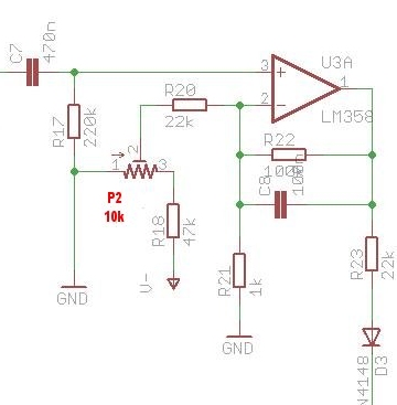

                      The detector worked from first time but the sensitivity was not good. After a fine adjusting to delay and offset trimers it had the ability to detect a coin at 12.. 13 cm only. I saw that there was not response when i changed the tune potentiometer. So the problem was near it...
                      After some time i saw that with the resistors that Silverdog gives must use 100k potentiometer. BUT Silverdog writes at part list for surf at his site that the potentiometer must be 10K. I replaced it with 100k and all OK. Another very good PI detector for underwater detecting.

                        • Hi Geo, if you mean the threshold potentiometer, tube the same problem, but I replace R18 for another 22K, and it worked well, This already wrote before.

                              Works well the threshold, can be set to silent or very low?. if not so, replace P5, on the other 100K as Geo says.

                              • Geo
                                The lack of sensitivity seems to be a common problem,
                                however I have a 10k pot for P2 and all works ok for me.
                                P1 = 100k [Trimmer on PCB]
                                P2 = 10k [Tune: Potentiometer]
                                P3 = 100k [Delay: Trimmer on PCB]
                                P4 = 1k [Volume: Trimmer on PCB or Potentiometer]
