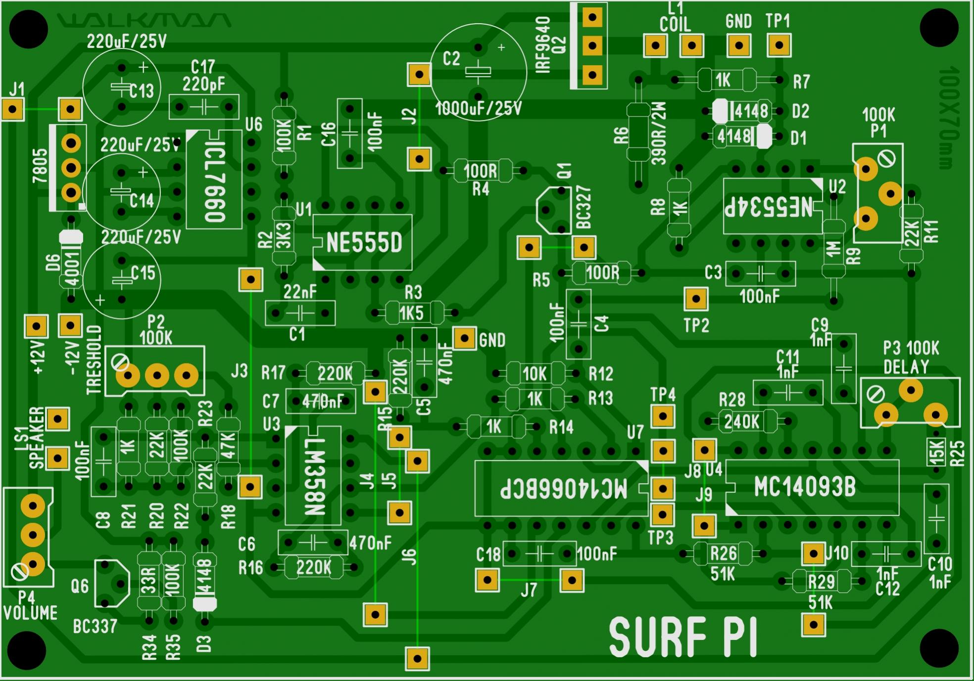

    • Hi friends; my surf pi pcb ( specially for geoscash1 )
      • Thanks Walkman, nice job...
        • looks nice,is it final?

                  • Hello, I apologize for asking but I made the board with all components and there is no sound, can anyone tell me how I can check the board or something?
                    • Originally posted by walkman View Post
                      If I am not mistaken, what you drew is actually for the Surf PI Pro. That's good because we are not drawn off topic, but it is bad because you have mislabeled your work which is bound to create even more confusion than what already exists.
                      We already have about three versions of Surf PI to try and keep straight (not counting the pro model). Why didn't you call it what really is? What is the name of this thread?
                      • Originally posted by farafero View Post
                        I had a similar issue when I first made mine. It ended up being a bad piezo buzzer. I replaced it with a new one and it fixed the issue.

                            Why don't you show us a few pictures of the board, from different angles?
                            If you have a multimeter you will need to verify that your power supply voltages are correct. Do you need for somebody to show you how to do that?
                            • http://pics.data.bg/categories/1/%D0...4ae323a2065/1i
                              http://pics.data.bg/categories/1/%D0...e7d9852976c/2p
                              http://pics.data.bg/categories/1/%D0...acbe347ab80/3v
                              Here are a few photos, where to measure with a multimeter?
                              • Yes those are photos... I was hoping we would get to see photos that were IN FOCUS so that somebody could possibly identify the different components. I can't tell one resistor color from another.
                                Sorry, but those pics are mostly useless.
                                edit: Meanwhile, try and make sure that none of the solder on the back of the board is bridging any two adjacent traces. Make sure traces are soldered on top AND bottom.
                                By the way, when soldering, more solder is not usually better than less solder, it goes the other way around. You should make your solder connections look nice and neat. Do NOT use excess solder on the joints. Use only enough solder to make a nice neat joint. Then make sure the PCB is cleaned well (spotless is good) with alcohol or something else made for removing flux.
                                Solder flux should not be allowed to cake up but should instead be cleaned pretty much as you go along... hour by hour, not day by day.
