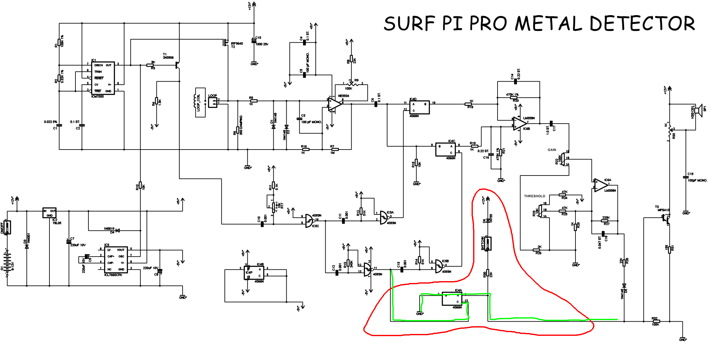

    • LED low batery indicator
      I would like to throw out audio battery check, and make the check visually via LEDs.
      I wonder, if I remove everything that is marked by a red line, or do I leave the green line, in order to the unit working normally?
      Thanks!

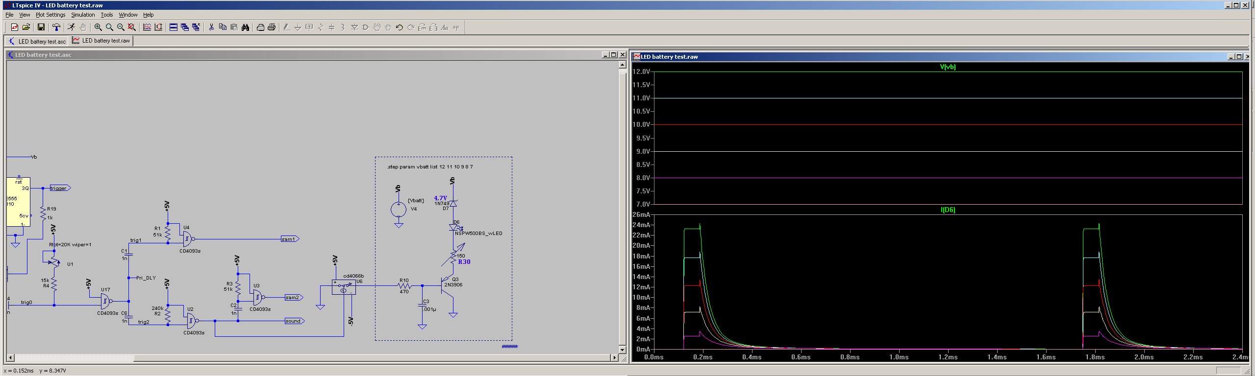

      • It would be a bad idea to power an LED through one section of the CD4066.
        If you can kludge in one resistor, one transistor, and one capacitor, this should work. The capacitor is there to quash what otherwise would be a nasty spike.
        You might want to use a different zener, and adjust the series resistor according to the lower limit of acceptable battery voltage. Even with the R30 being zero, the 1N755 would be useless with a 12V battery unless you wanted the LED going from full brightness to fully dim as the battery fell from 12V to just slightly lower than 11V.
        ----------Click image for larger version
Name:	LED battery test.jpg
        edit: I just realized that I used a model for a white LED... After replacing it with a RED LED model, everything still looked about the same except that you should increase R30 to about 200 ohms... to keep current below .03A
        • I was a little clumsily expressed ... hard for me to find the right words, sorry.
          Just want to know if I can this input of CD4066 (defined by a red/green line) disconnected from the rest of the circuit, and to continue to work normally?
          low level indicator would later incorporated, something like this:
          http://dmohankumar.wordpress.com/201...ners-trial-10/
          I need knowledge of technicians, because just draw tile, I stopped in this detail. I want it out, if it is not necessarily required for the normal functioning of the device.
          So if this input 4066 is just to drive baterry check, then I would be happy to shut down, but asks you to confirm someone who knows, or who may be tested.
          Thank you!
          • You must keep this part of the circuit, audio wont work without it. Not just battery voltage test (this will actually work without IC), U4A is audio chopper, used to modulate U7A output with audio tone derived from U6D. Do not remove it.

              • If you have problem making\routing PCB traces, you can swap IC pins. 4066 chip contain 4 independent analog switches, 3 used in circuit. Each have one control input and two switch connections, marked U4 A,B,C,D. You can interchange them, also interchange switch outputs. For example if you change U4A (pins 13, input, and 1,2 outputs) with U4B, not used in circuit, (pins 5,4,3,) or U4C or D this will work. Also output pins are interchangeable within same section, for example pins 1,2 or 3,4 etc can be connected in any direction if this can simplify PCB layout. Same is for sections of U5 and U6, can be swapped.

                  • Sorry, Harp. I realize that I did not really answer your question (I was actually hoping that would not matter if I showed you something simple but still workable) - but by the time I had worked out the details I figured I may as well share it.
                    Of course it makes a lot more sense for a battery monitor to have a "battery bad" LED come on suddenly, rather than having a "battery good" LED slowly fade away.
