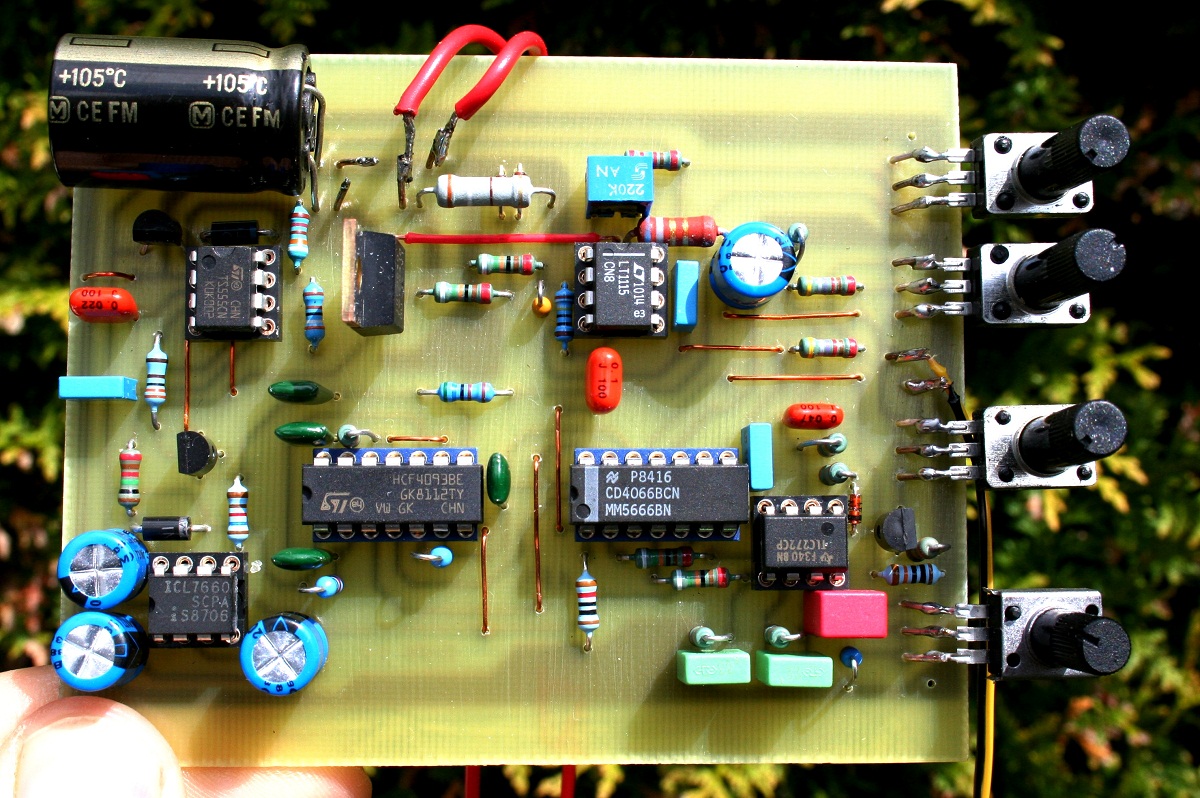

                    • #85
                      thanks ApBerg
                      and I have another question what is the reason of the 1000uF capacitor because when I inserted it the out put of TL071 -that I replaced the NE5534 with- was bad and By removing it the signal form TL071 becomes much better
                      I appreciate any help thanks
                      terhaka
                      • #86
                        Originally posted by terhaka View Post
                        thanks ApBerg
                        terhaka
                        Think you better use NE5534 or a LT1115 if you can get it.
                        question what is the reason of the 1000uF capacitor :
                        After the fet (Irf9640) is switched on, the 1000uF cap. can supply fast the needed energy to the coil, the battery's cannot give so fast the energy that is needed ..
                        In the time that the fet is closed the battery's refill the 1000uF cap.
                        Think that the 1000uF cap. is a bucket full of water, if you empty it you have in a short time plenty water, in the 'time out' it refills via a water hose.
                        In a PI design the tracks that are needed for the "batt-cap-coil'' circuit need to be solid and short...
                        Hope it is clear... or somebody can give a better explanation..

                                hello jim
                                i have finished your pcb design yesterday
                                works from first start
                                many thanks again
                                next days i will start to tune and change some parts
                                like recommended from ApBerg
                                i think i change: ne5534 to lt 1115, main cap value and reinforce the solder tracks to coil output
                                but i could need some infos to get best setting point
                                so if anyone can give me datas for testing points where i can set up right voltages at ic
                                i would be happy
