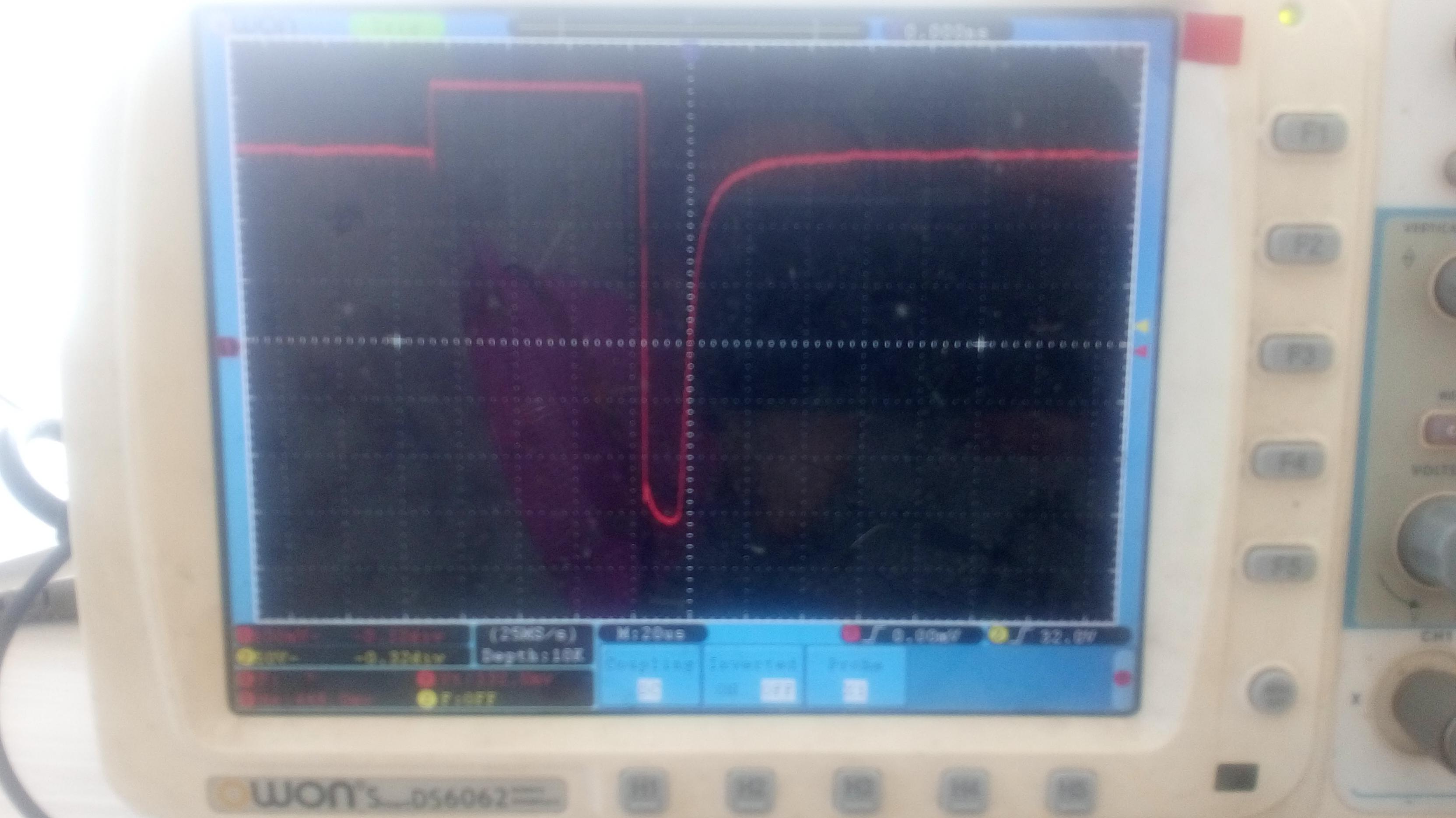

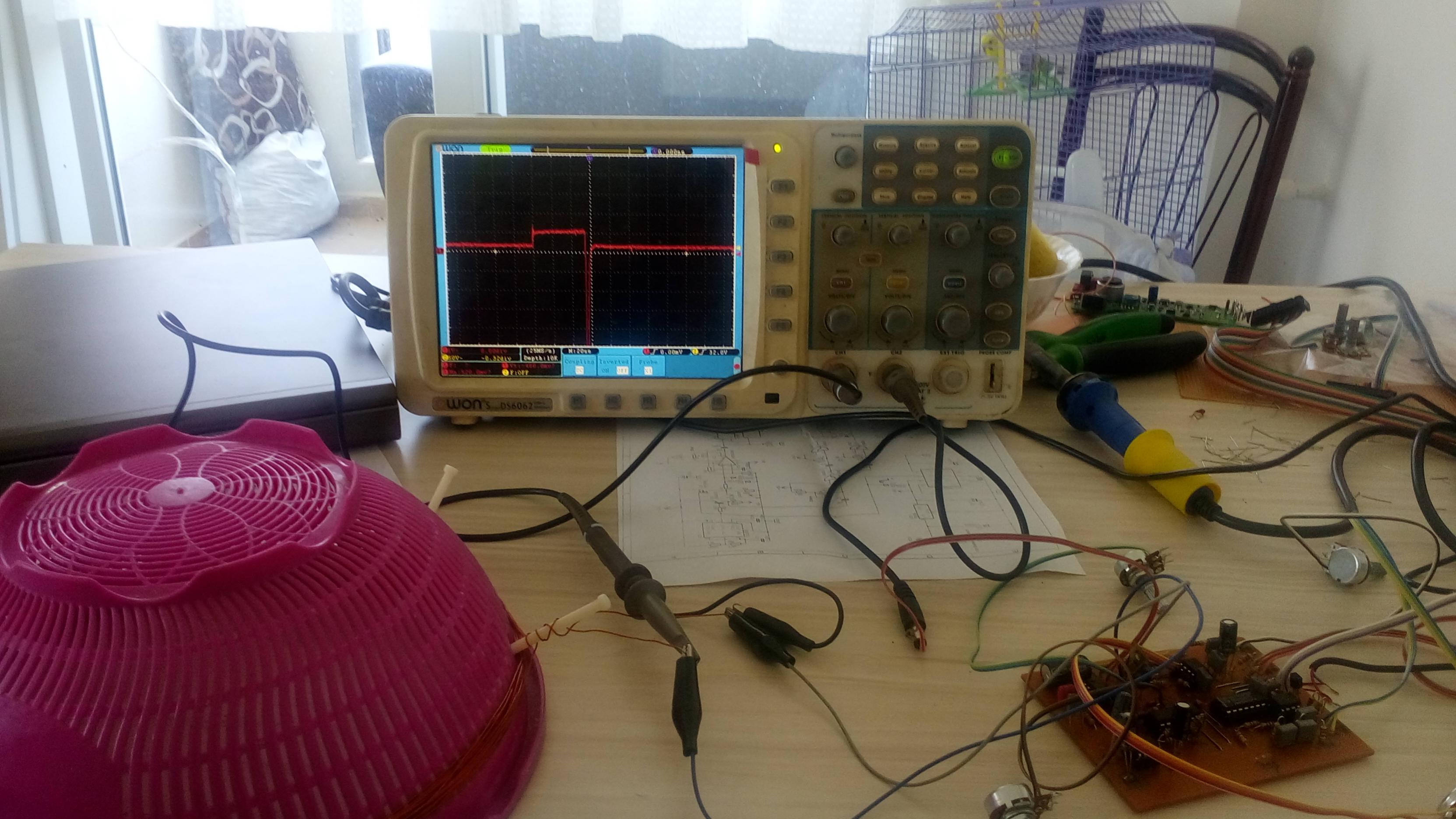

              Hello.
              My circuit has no sound. If I only set delay resistor its making sound. I saw signal on scope but I couldn't understand what's wrong. Any idea?
              • Set the delay Resister? Elaborate.
                • I success got a sound but it doesn't see iron. And which pin that I can see curve on scope ?
                  • Look at the output of first op amp.
                    • it was working little bit under distance of normal (1euro=15cm) with iron discrimination. i just remove 1k pot instead of 1k resistor. than its gone. it sees 1euro at 1cm hardly. i guess my PCB has too much week solder
                      anyone has idea what there is no distance?
                      thanks
                      • LOL, Put it back normal with the Pot. Check the damping on your coil. What you you using for the coil ?
                        • The coil appears to be wrapped around the pink plastic basket on the left of the picture.
                          • Yea, I seen that but wasn't sure it that was what he was using. If so he was doing OK at 15cm. LOL
                            • coil is 0.55mm 23turns with 24cm diameter at picture pink plastic i guess my PCB is not good (by iron transfer)
                              I saw NE5534 (first opamp output) on scope here;
                              20uS every square on scope;
                              1euro = 1cm distance i try to set delay pots but nothing chanced
                              • Try to measure at the center pin of the delay pot, due to the setting it must change from 0-5vdc.
                                May be the problem is on the pot.
