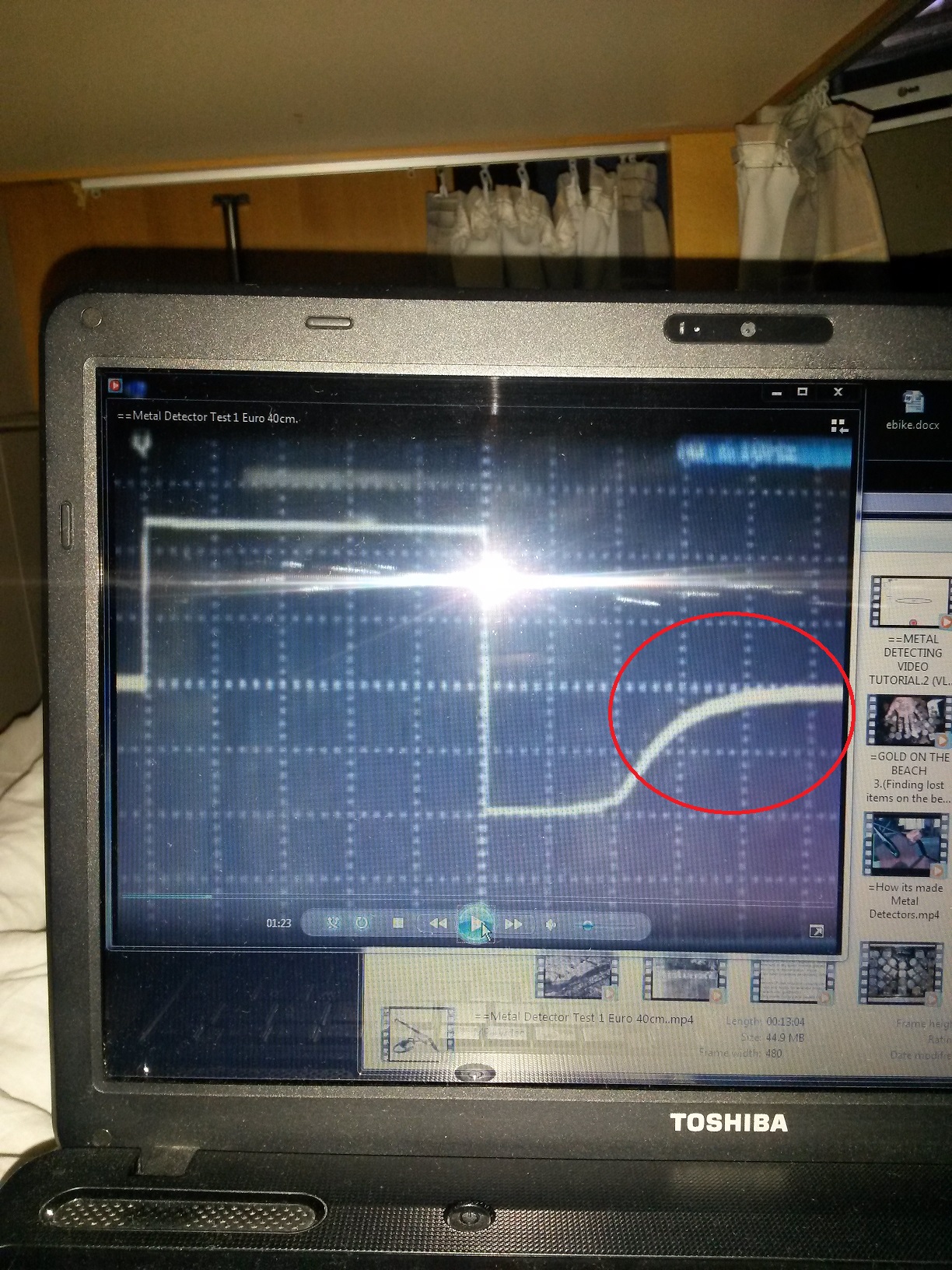

      output of n35534 pin6 is like in this picture? do you have a change in the curve when approach metal to the coil? (where the circle is)

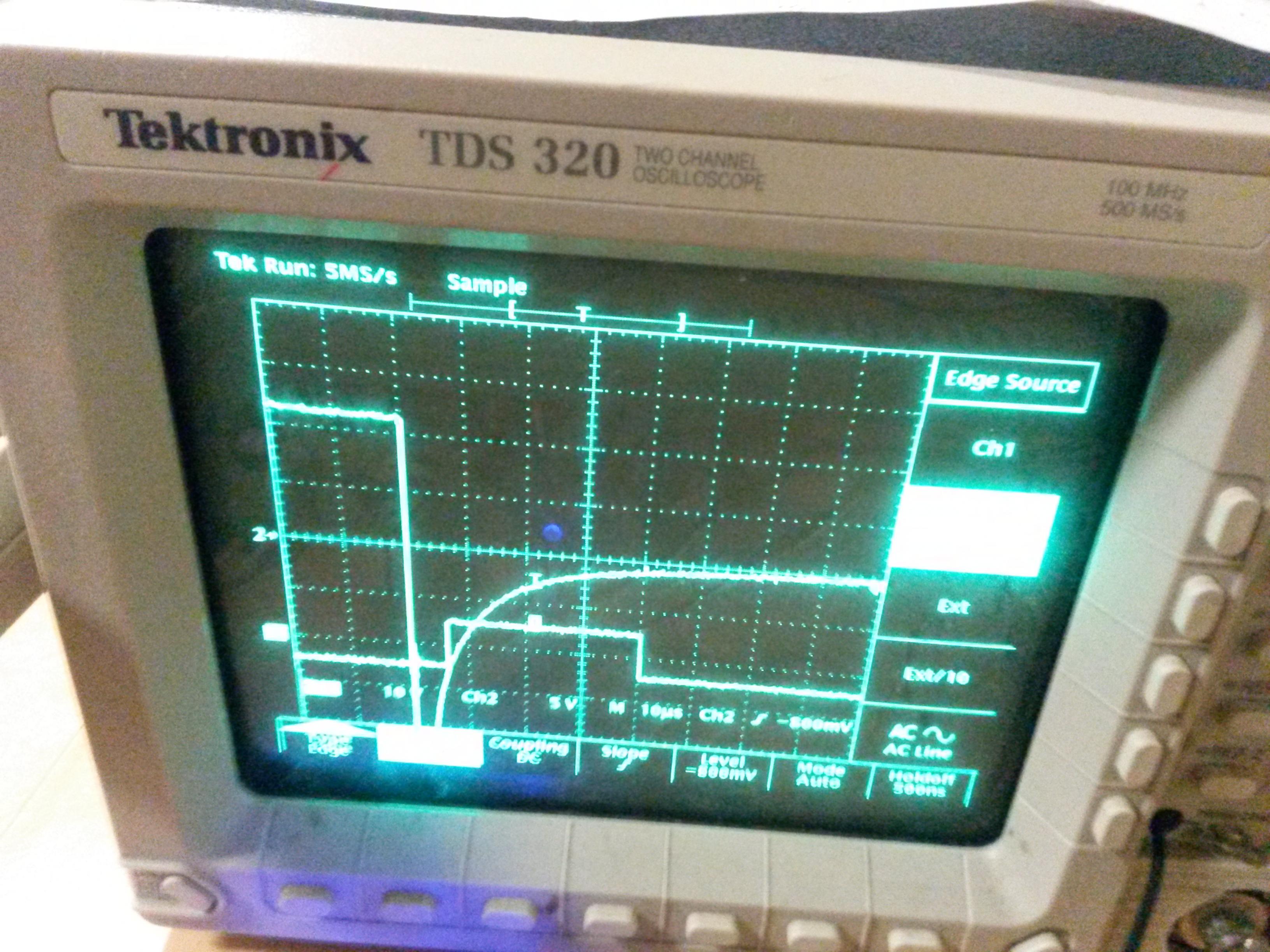

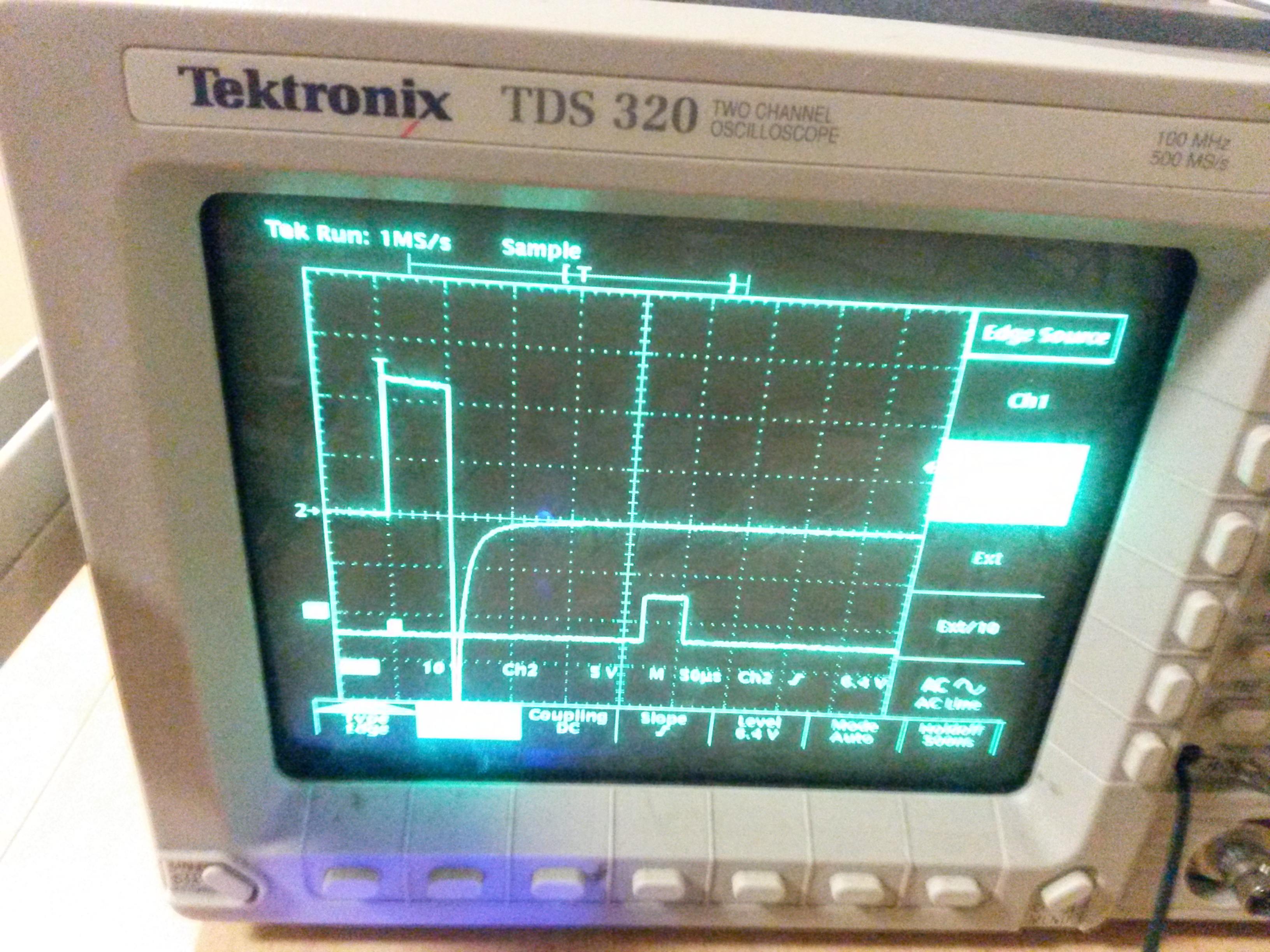

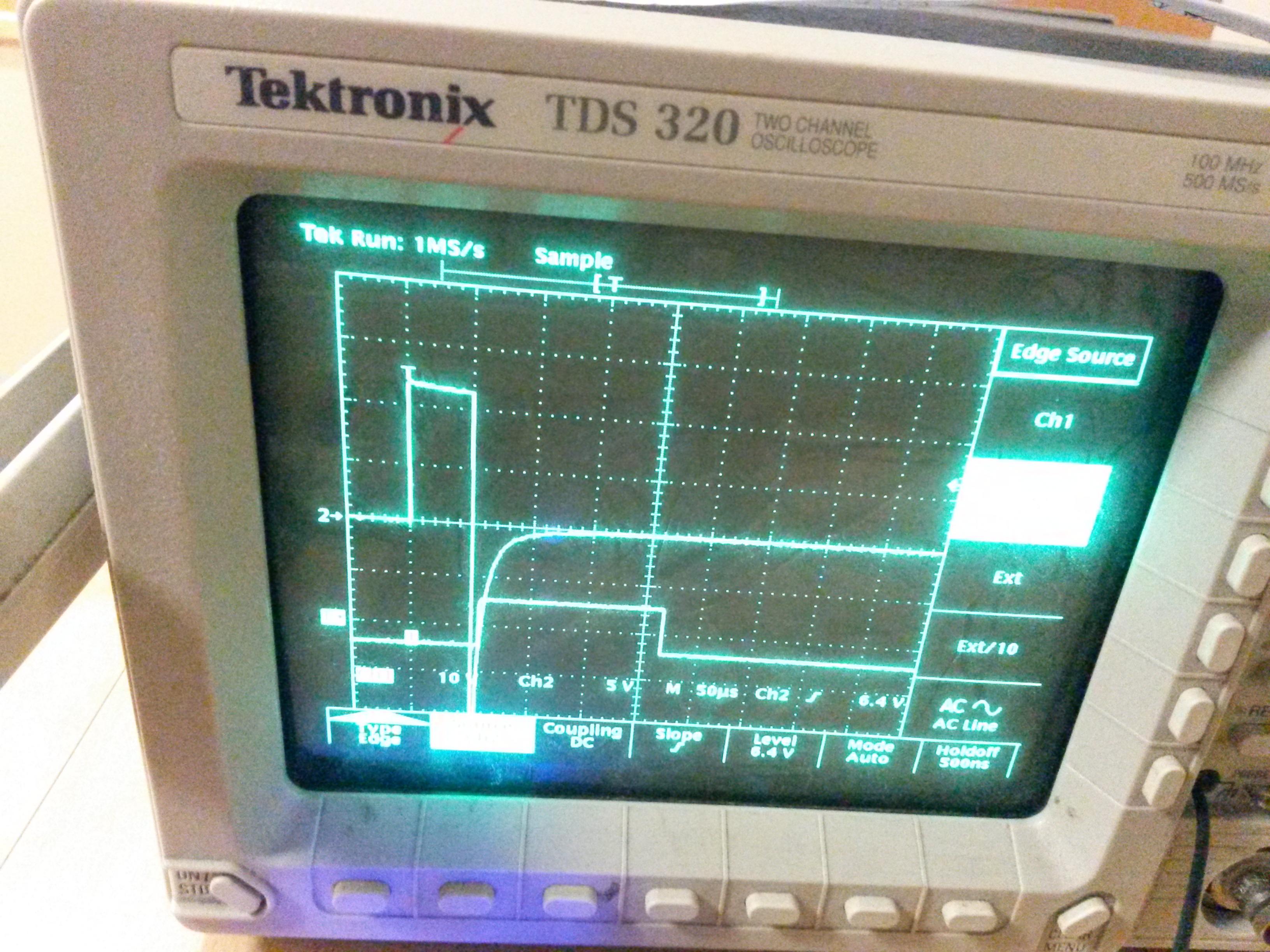

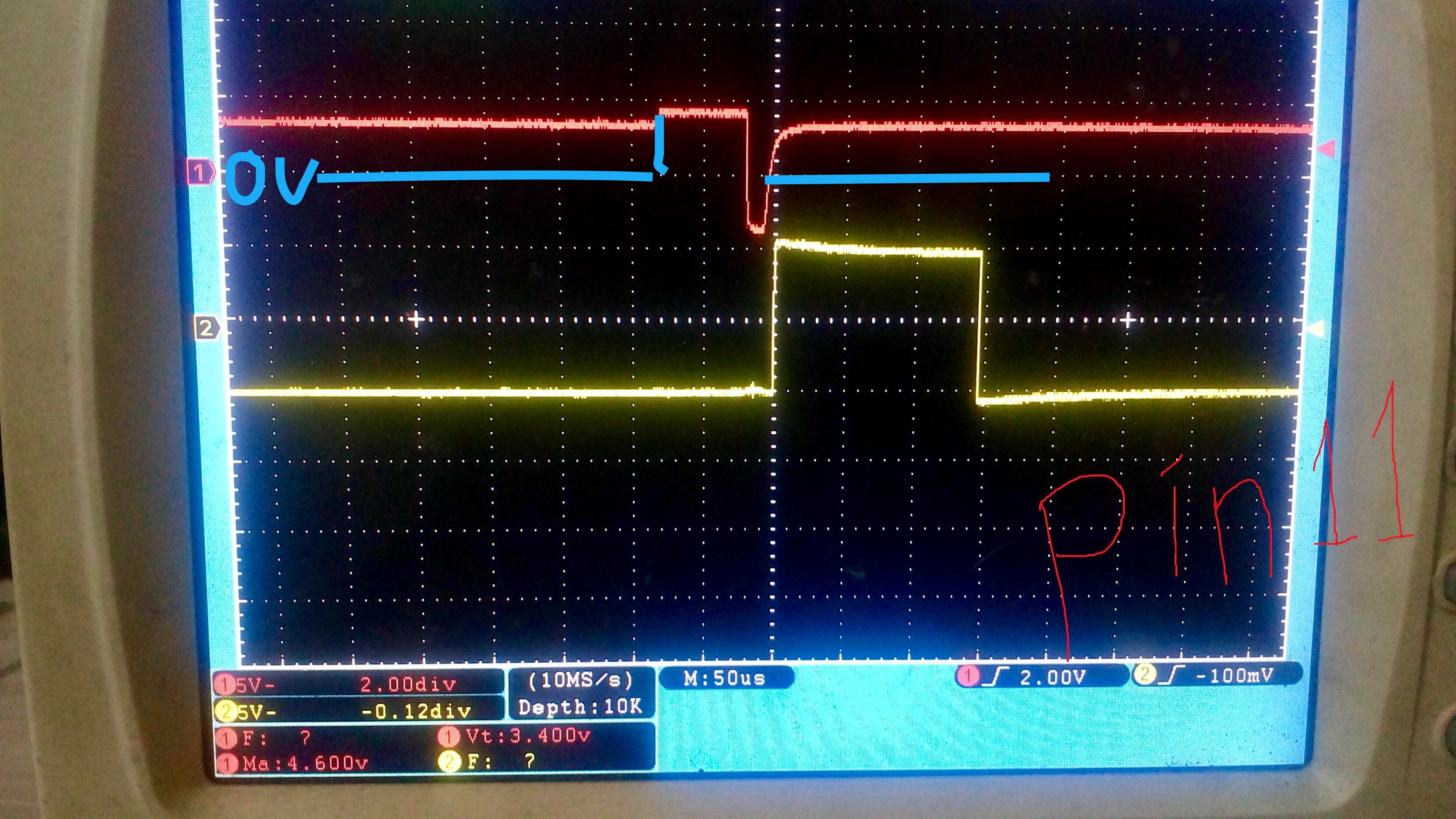

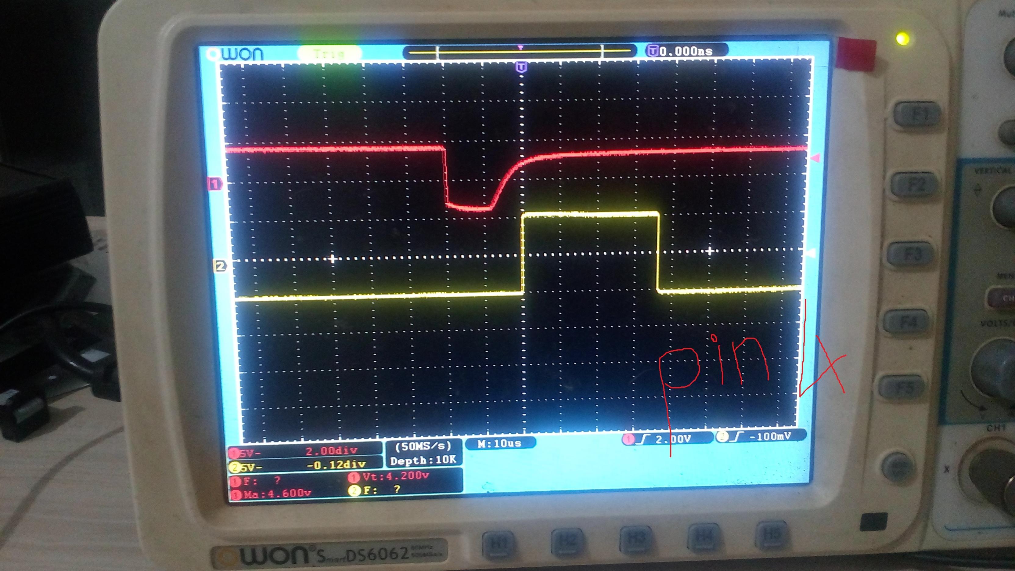

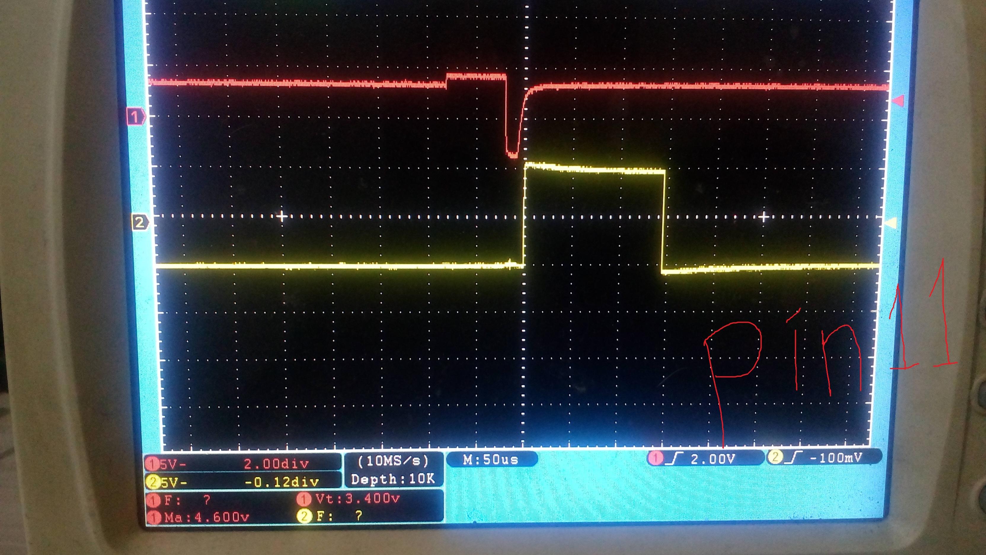

      Delay it can be measured like this:
      Keep one channel to n35534 pin6 an with the other channel check IC4093 at pin 10, pin 3, pin 11, pin 4. turn delay pot to see if delay is working.

      • Thank you very much for Help
        Yes i have change on curve pin6 but in coil or near to 1cm for 1 euro... it gives perfect response to neodium magnet app. half meter away....

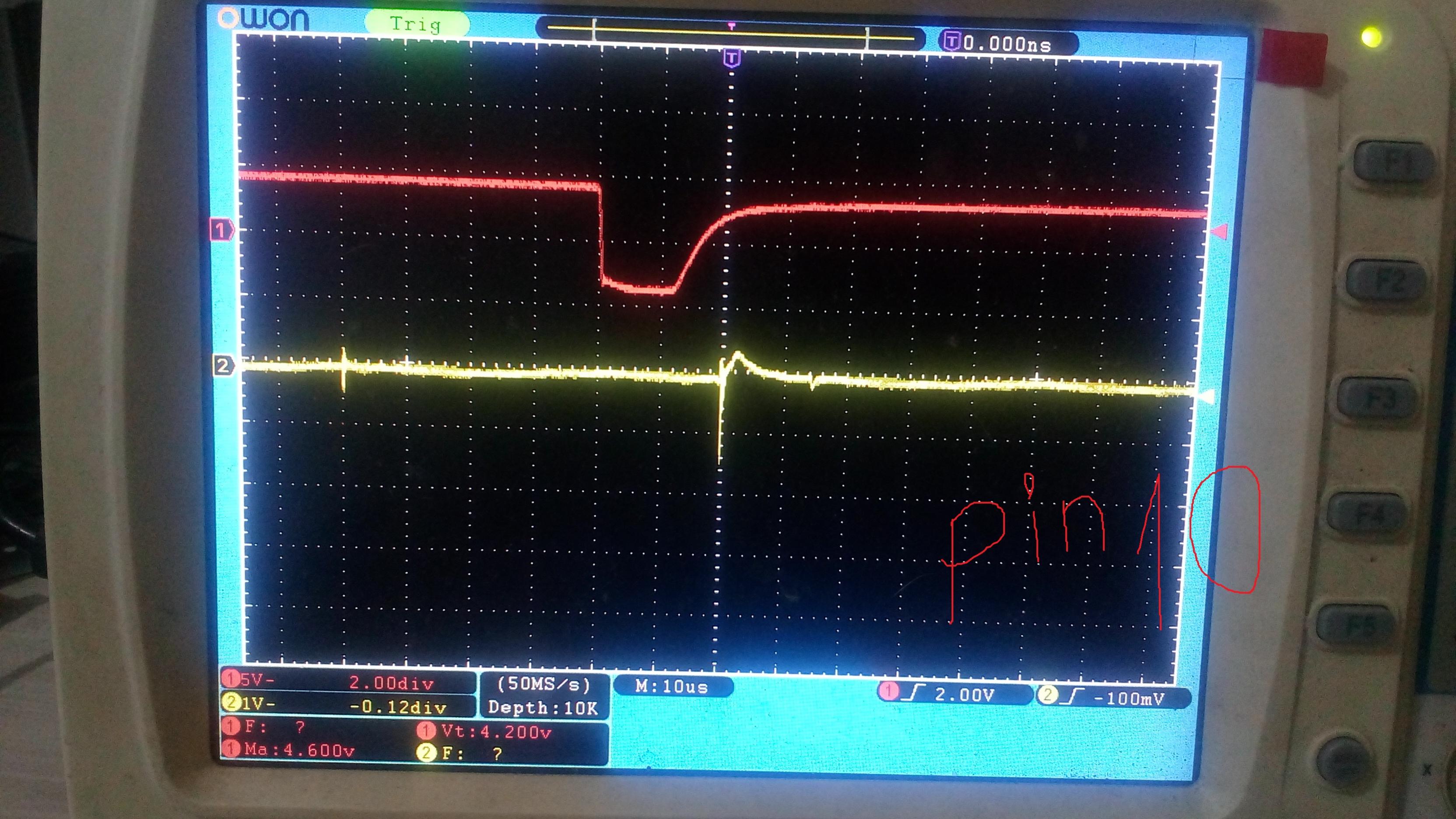

        i guess pin3 and pin10 has a problem ?

          Don't know if I'm looking at correct schematic.(Reply 879). Looks like pin 10 is the problem, what does the scope picture collector Q1,R5 junction look like?

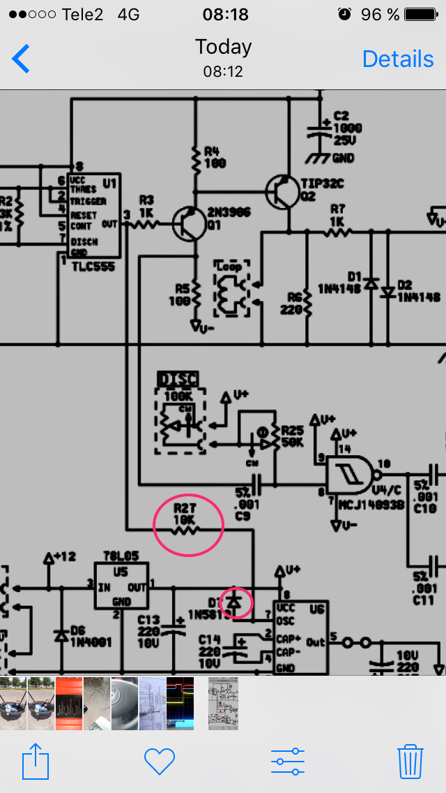

          • From what i see 0v is not set. Look at the picture. And i remember o had same problem. Delay not working, at pin 10 incorect signal. I had to remove , if you have this schematic , r27 and d7. Don't know the reason, maybe ne555 - it needs tlc555. Other schematics of surf pi does not have that link from 7660 to output of 555.just remove those 2 components and make 0v offset. And try again.

              this is my circuit and there is no R27 - D7 ?

                i know that was working, but was not working corect! I had same issues like you before adjusting it the right way. Put also the shematic pls.

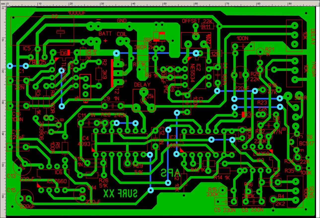

                • İ guess its better to make New pcb. Can you share single Side working pcb? İ want to make it tonight by iron transfer.

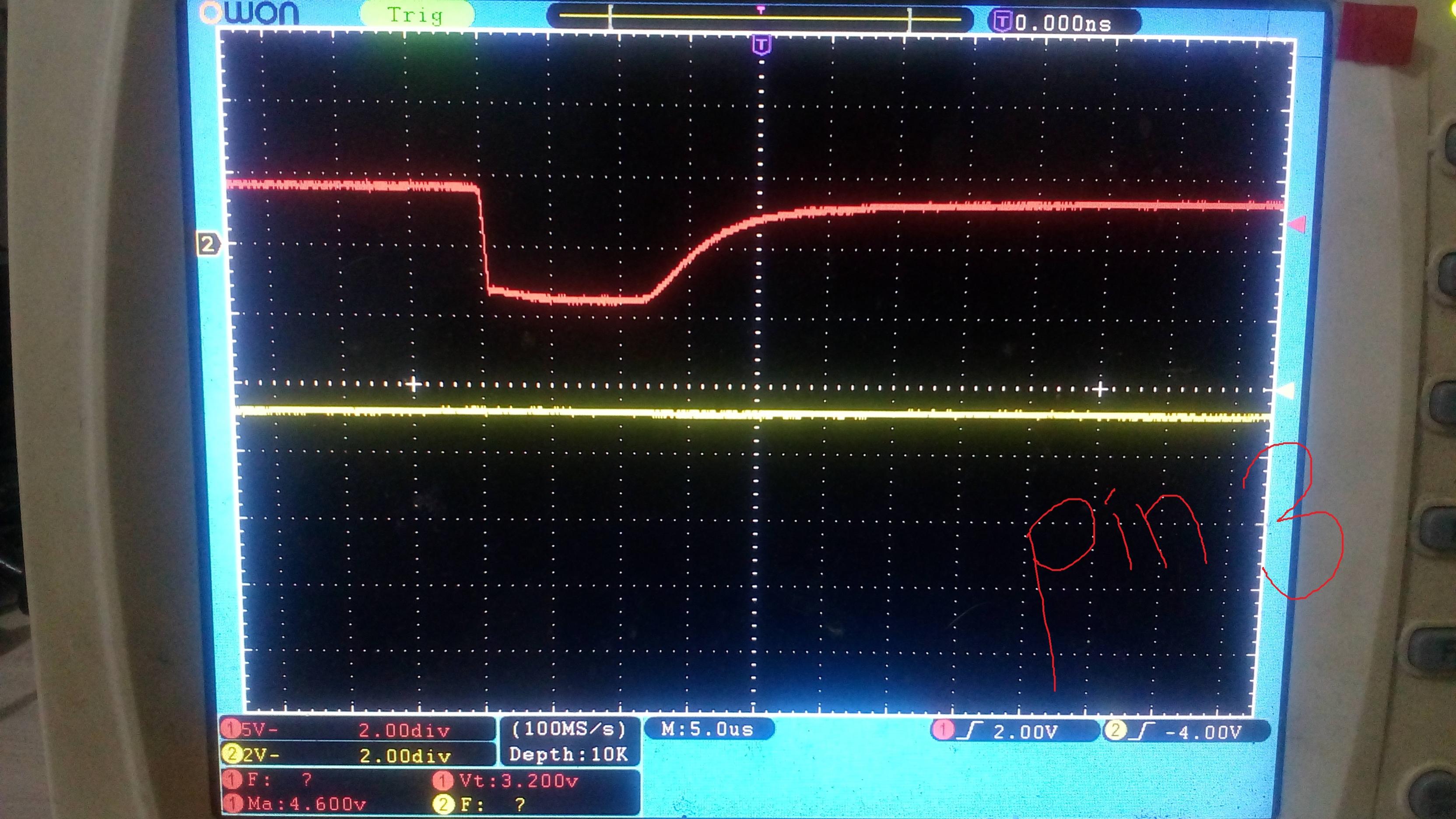

                          • https://youtu.be/wiZsLQ6oo2Q
                            red curve is first opamp out (NE5534-pin6) and yellow curve is 2n3906 collector
                            it makes beep for money only touch the coil i hear so weak sound at 10cm for 1 euro but really weak that never people can hear.

                              In your reply #978 you show no change on pin10 of the 4093. Your video shows a pulse on the collector, can't see the amplitude. When the collector goes low pin10 of the 4093 should go high for about half the time the coil is on looking at your video. Some possible reasons, 4093 bad, collector pulse amplitude to low, capacitor or resistance pin8 not correct. Scope signal on pin8 should go low near -5v rail when collector pulse goes low and decay back to +5v rail. Pin 10 should be high when pin8 is less than 1/2 4093 supply volts.
