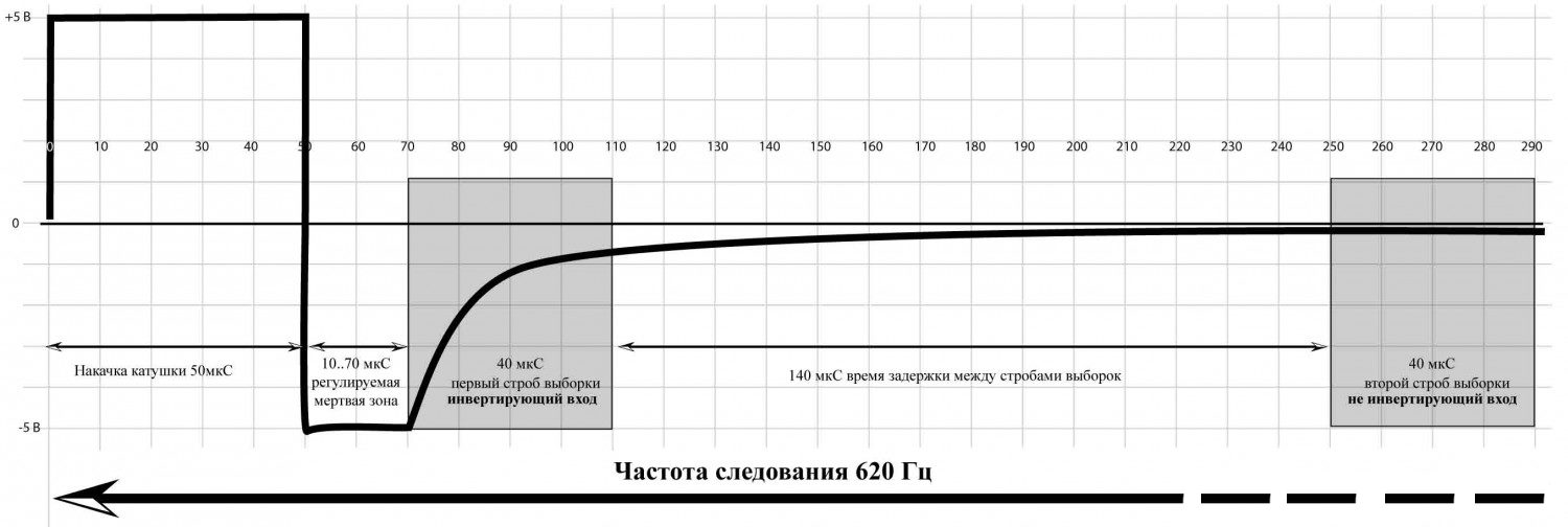

          • Hello everyone, who can draw its delay map? Is it the same as the delta pulse?
            • Hi to all !
              liudengyuan, if I have correctly understood your question :
