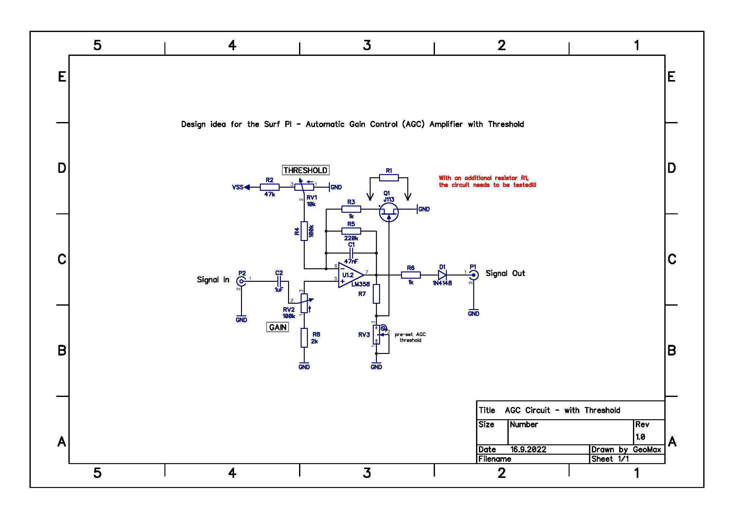

                    • Hi Vadim18
                      Thanks for your reply. Actually, you are right. There is no AGC in the DP. The circuit in the front-end amplifier of the
                      DP is more or less an automatic DC offset correction circuit. After your comments, I had a closer look at the “classic AGC circuits”.
                      In an AGC circuit, the gain changes and not the offset of an amplifier. I do not know which AGC circuit you are using in your
                      Surf PI, but a Widlar current source circuit connected after the integrator of the Surf PI would do a similar job. A very similar
                      circuit part you see in the HH before the VCO.
                      Attached is my first idea of an AGC circuit for the Surf PI. Maybe you can share your AGC solution to the Surf PI as well.

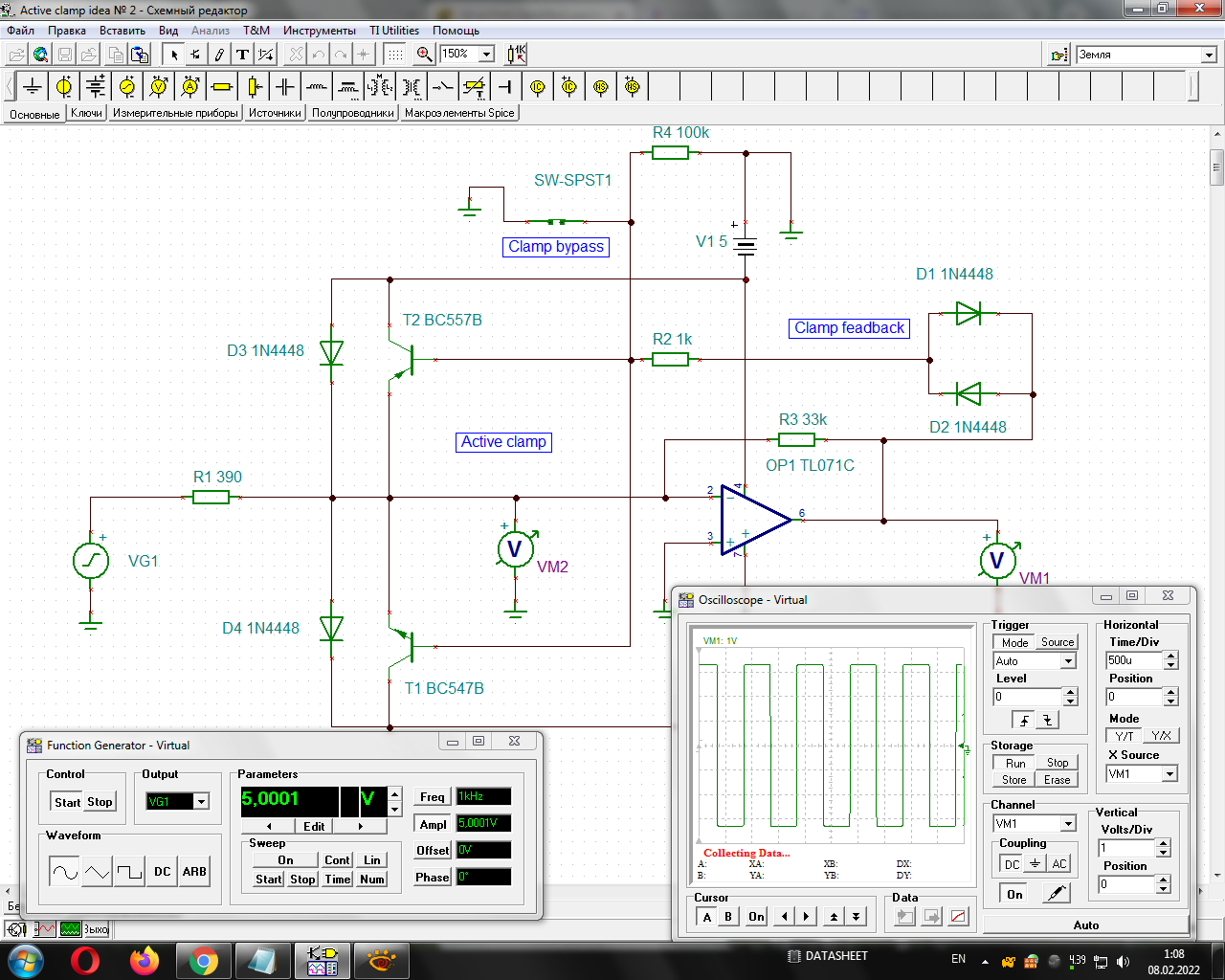

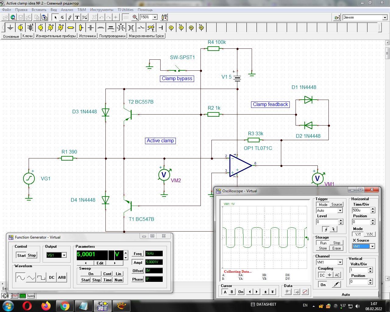

                      • Hі GeoMax
                        I have feelings that this circuit will produce oscillations, or just act like comparator becouse "+" on opamp output converts to "-" on j310 drain and than "-" goes to invertion input of opamp and in final you will get inverted "-" or positive feadback. Just avoid positive feadbacks. I already post my active calmp idea last year, that is 1/2 of AGC part.
                        https://www.geotech1.com/forums/showthread.php?26475-ZP-ACTIVE-DAMPING-and-NOISE-CANCELLATION&p=292733#post292733
Name:	ActiveClamp idea - bypass mode.png
ID:	363416 Click image for larger version
Name:	ActiveClamp_idea - active mode.png
                        Difference - front end amplifier must be inversion mode amplifier. This circuit can do coil damping and aditionaly can be part of AGC.
