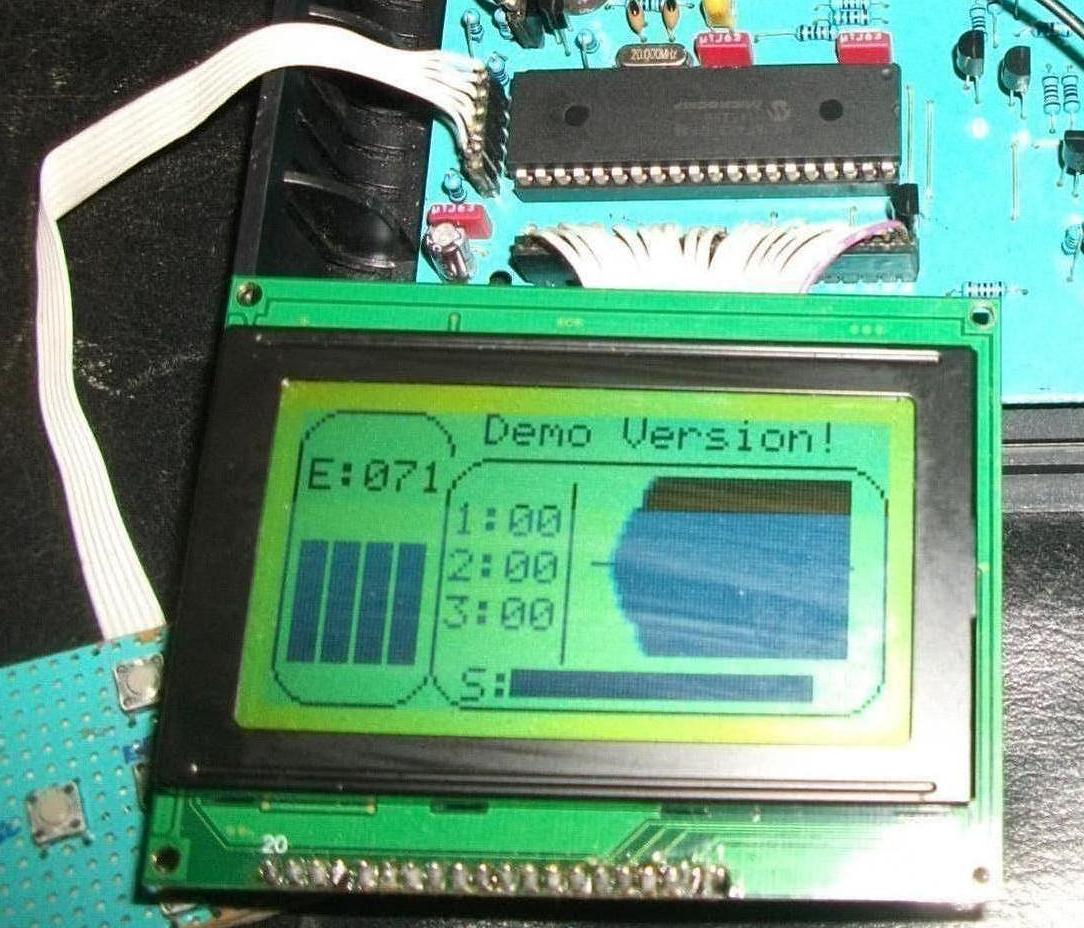

ID:	334027Hi turboaleks
      There are notes need an answer especially the image of No. 2 In part of LCD?

      • hi jap
        i check my circuit and all the pins voltage are okey
        but i have 201hz freq in circuit .
        all the test is with guidance pdf.
        and my detector cant sense any metal.

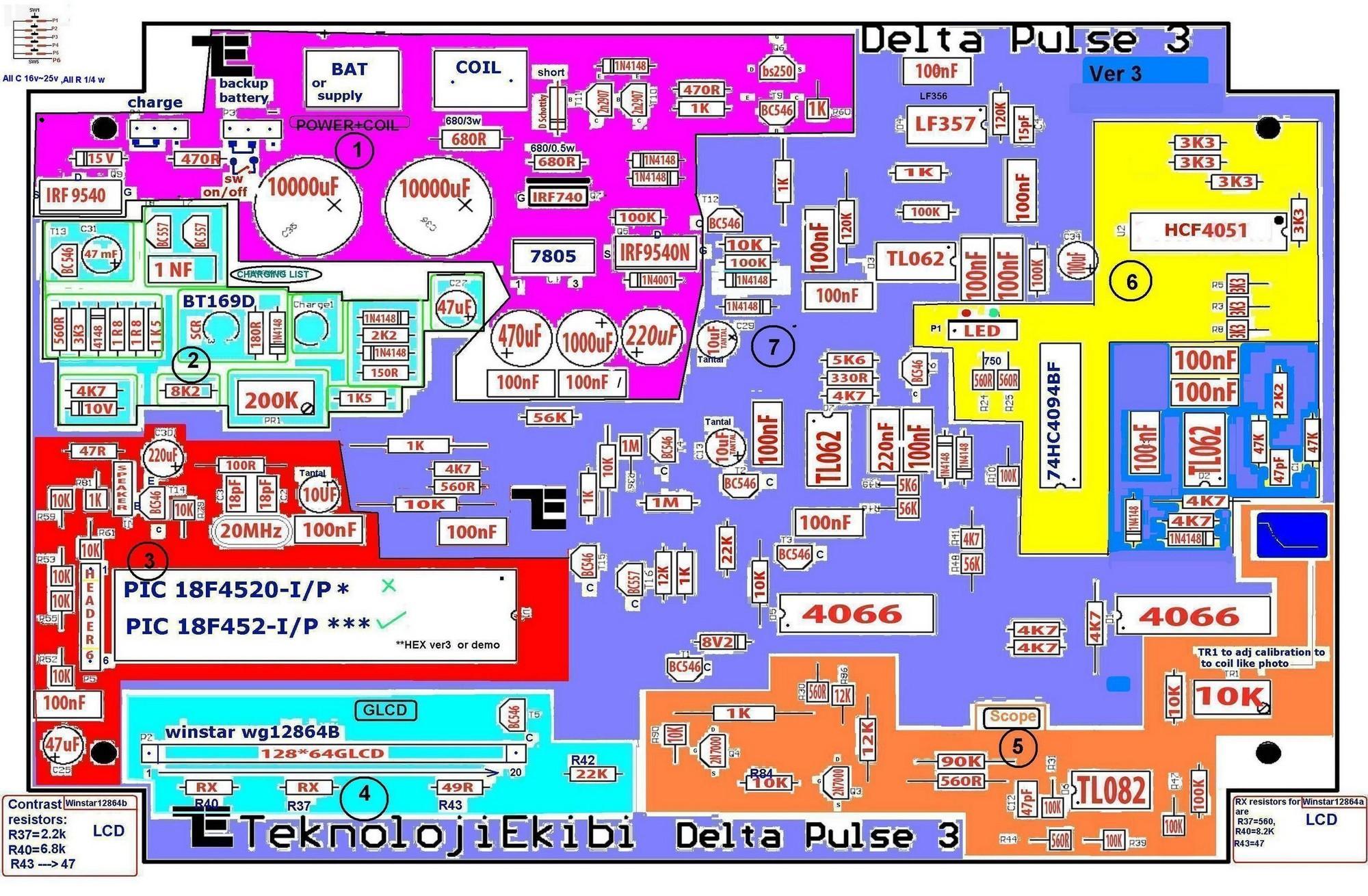

                        Frequent questions for DP3 ver3 and easy board was divided into parts as schematic:-
                        1 - part of the coil and power.
                        2 - part Charger and can not mounted it.
                        3 - part programmed controller + keyboard + audio{SP} out.
                        4 - part GLCD and control.
                        5 - part scope and its components.
                        6 - part determine the type of metal and match between the signals used by pic.
                        7 - part of a normal delta pulse .
                        I've put all the notes in every part of the answer to all questions.[*]-dEMO HEX =~ver3 used only in ver 3 pcb.
                        -start test with coil 40cm , 3~4 ohm,400~500uh.
                        -Must use keyboard sw1~5.
                        -follow measure at points as schematic & PDF .
                        -adj TR1 Will help in setting.
                        -all value of R,C are All worked and change values for improvement.
                        -All value of R=560 will changed later to improve performance.
                        -All value of R of U2,D6 Can be modified to obtain the best results.
                        -Most problems of choose different types of GLCD and followed connection method.
                        -R43,37,40 Changed for the relation for GLCD[part 4].
                        -in case not use Charger ,can use sw on/off in P3[part2].
                        -all C 100n is mk type.
                        -There are important components in the function, such as Q3,4=2n7000,Q6=BS250,D4=LF357,D6,Q5,Q9,U1.
                        -Responsible for higher sound both T14,R79.
                        -Responsible for the delay in the start vd12, C22,C24,C28.
                        -The difference in results is due to the difference in components and quality of connections of the pcb.
                        best time
                        j.

                              • Hi All!
                                I Almost done with the soldering, but I need some informations:
                                - I bought a LCD, this: http://www.ebay.co.uk/itm/160375870532 , than i would like know which resistors need to? R37, R40
                                - P1 is 3 pin, than wire go to LEDs?
                                - D8, Idont found Schottky, which value is it?
                                Thx
