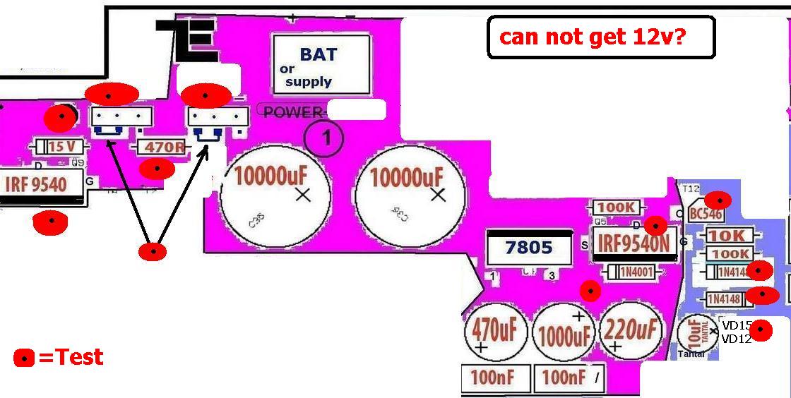

              hi i now assembling one new pcb
              when i want to check circuit with guidance after assembly i can not see 17 volt in circuit with 7 poini.
              ( i cant not see 12 volt in 8pin tl062 and 16pin 4051 and ..... )
              plz help me to sole this problem .
              thanks
              • Originally posted by hadi-dindar View Post
                thanks
                Hi hadi-dindar
                -(Search in copper links there may be a break in the copper of pcb in the area) .
                -test if all the components and value in its place.
                -SeeClick image for larger version
Name:	part _power.jpg
                Full wishes for the success to complete
                best time
                j.
                • thanks
                  solved jap.
                  the irf9570 inside 7805 damaged . after change it the problem solved.

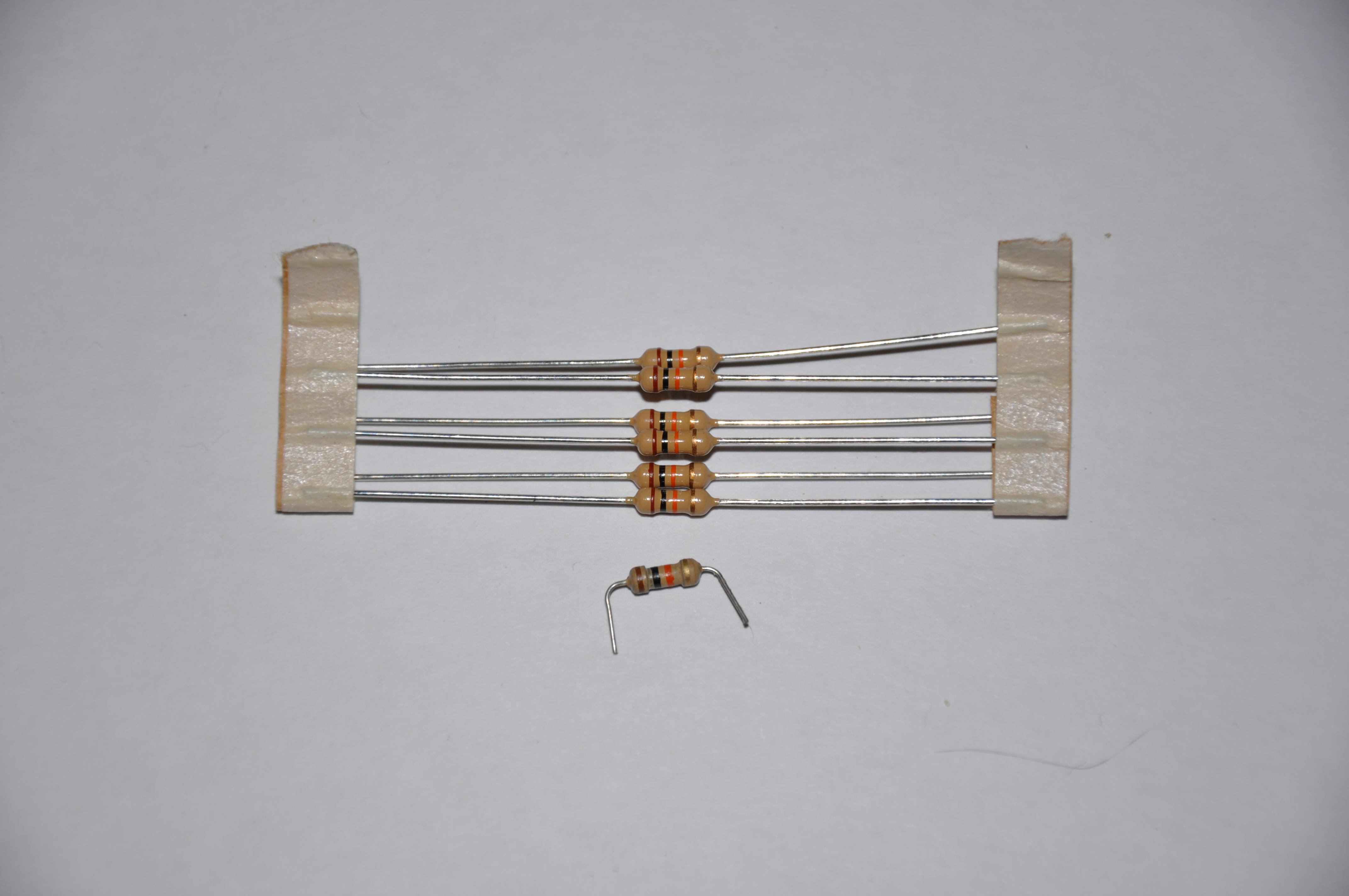

                  • hello,
                    i can't go on, can anybody say to me if 49ohm resistor exist?
                    i bought in a shop 49.9 ohm resistor, but not 49.
                    where can i buy it by internet?
                    i need R43
                    thanks.
                    • Originally posted by Malibu View Post
                      i need R43
                      thanks.
                      Hi Malibu
                      -U Can use R43= 49.9 ohm .
                      best time
                      j.
                      • Thank Jap.
                        Another question. See the foto.
Name:	la foto (4).jpg
                        Are the same resistance or are different. I know that they are 10k but are the same material? or are metal film and the others ceramic?
                        The question is, can i use any of this? Is the same.
                        Thank you.
                        • Hi Malibu
                          U Can use!=the same.
                          best time
                          j.

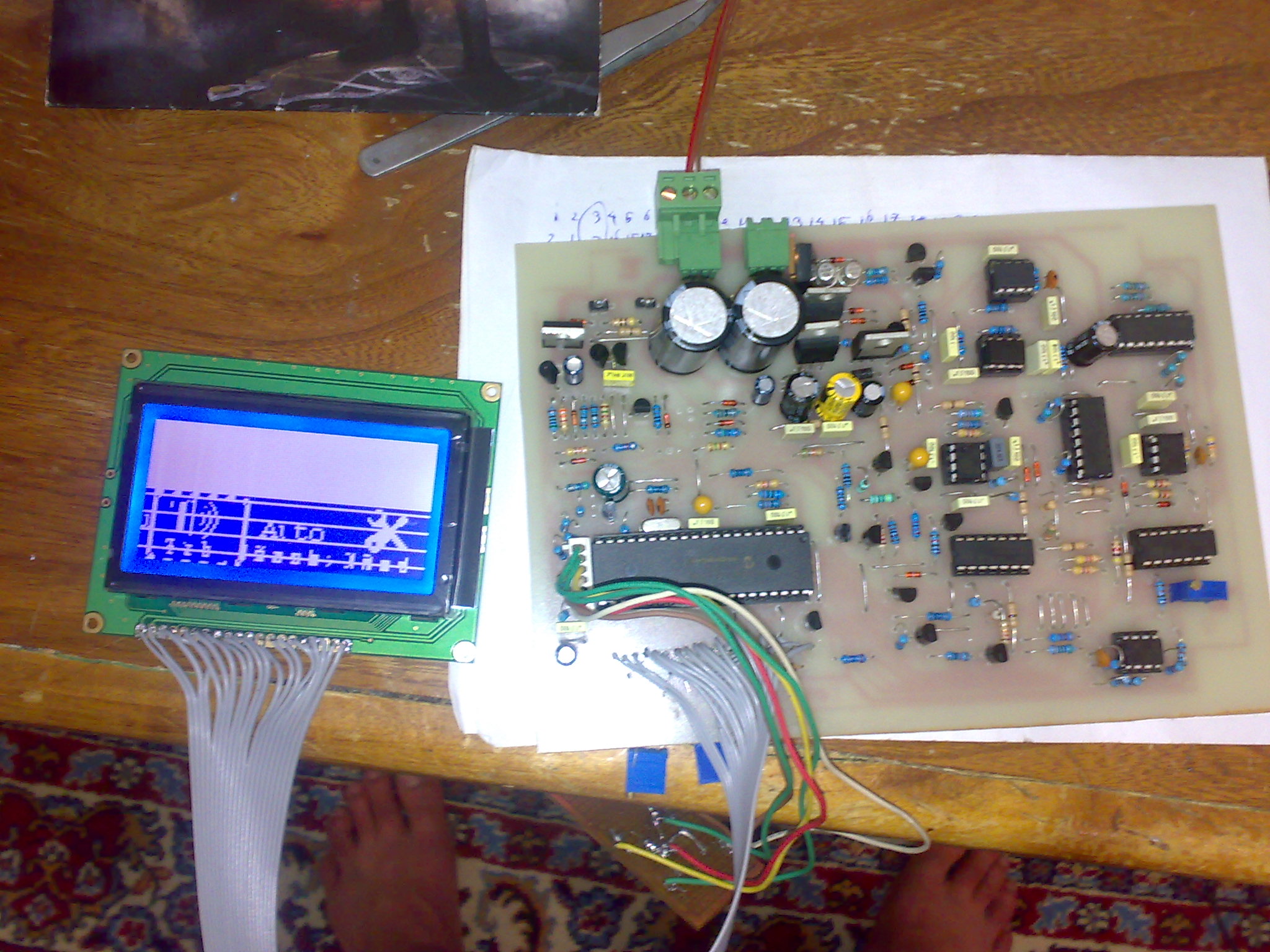

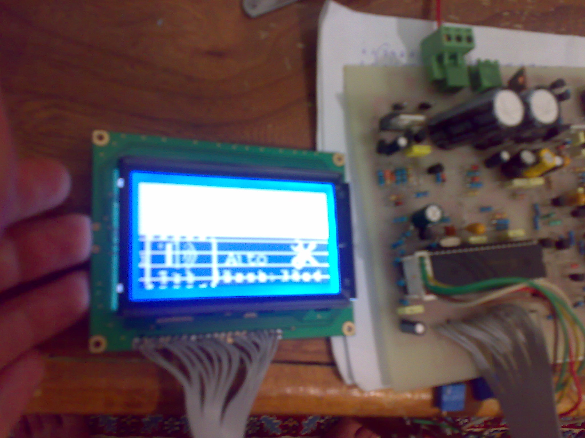

                              • hi jap
                                hi jap and other best friends
                                i have one problem
                                when i install pic on pcb and want to turn on the detector my glcd can ton ably to show all thing .
                                please attention the this images
